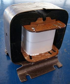

DAC interstage-trafo output (PP-SE)
About 6n6 tube.
One variant for example:
The battery is 1.5V ,
r(cathode)= 250 Ohm.
L=0.25*r/Fr
L=0.25*(250 Ohm/0.25) Herz=250 Henry.
This trafo with Cobalt (Mu=120000) core have this HenrY.
The Ferum trafos is near 180-200, but it's real to get 250 Hy too.
I havetThe Cobalt and Fe cores becouse I work with a factory which make make this kind steel.It's a big fild for experiments.
I love bass and ultra-minimal faze distortions.And I try to make more low bass spec as I may.
If 6p9 - I like this tube, the Io=70ma with 2*1.5V (-3V) acumulator. r(cathode) = 75 Ohm.Second primary is antifaze coil.
L=0.25*(75/0.25)=37.5 Henry.
this tube I love too/ i like high Slew Rate (because delta I = 80 ma)

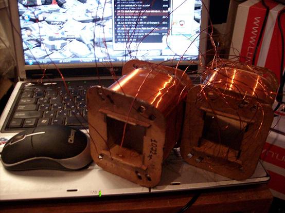

At the early picters is nano-crystal (amorph) Ferum with Mu=90000, it's like the Perm steel and Mu may be more, but max inductance higher of this core and data like simply Fe.
The high frequency will be more than 200kHz.
Now I have a plan to raze the toroid core by lazer.And it's will be Ferum and Cobalt. It's will be SE trafos. But the steel with air grap have less indictivity. I will tell after experiment.
For 6n6 and 20Hz.Inductivity must be 1.7 Henry.
For 10 Hz= 6.25
For 5 Hz = 12.5
For 1 Hz = 62 Henry...(This calculations I love more)...

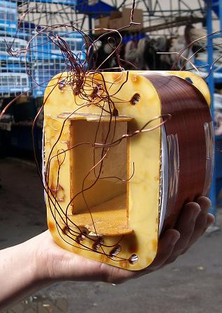

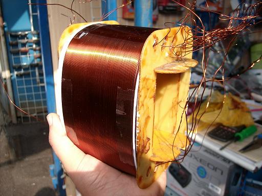

Output trafo for GM70+300B+...
It's the Soviet trafo which will have the secondary for GM70, 300B, 3*6s19s in parallel and many more...
Ktr(ansformation)=45-40-35-30-25
the weight is near 15 kg
The trafo will be rewinded, cosmeticated for nice looking...

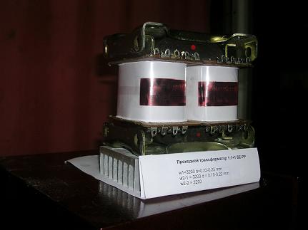

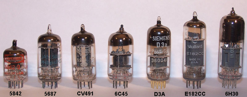

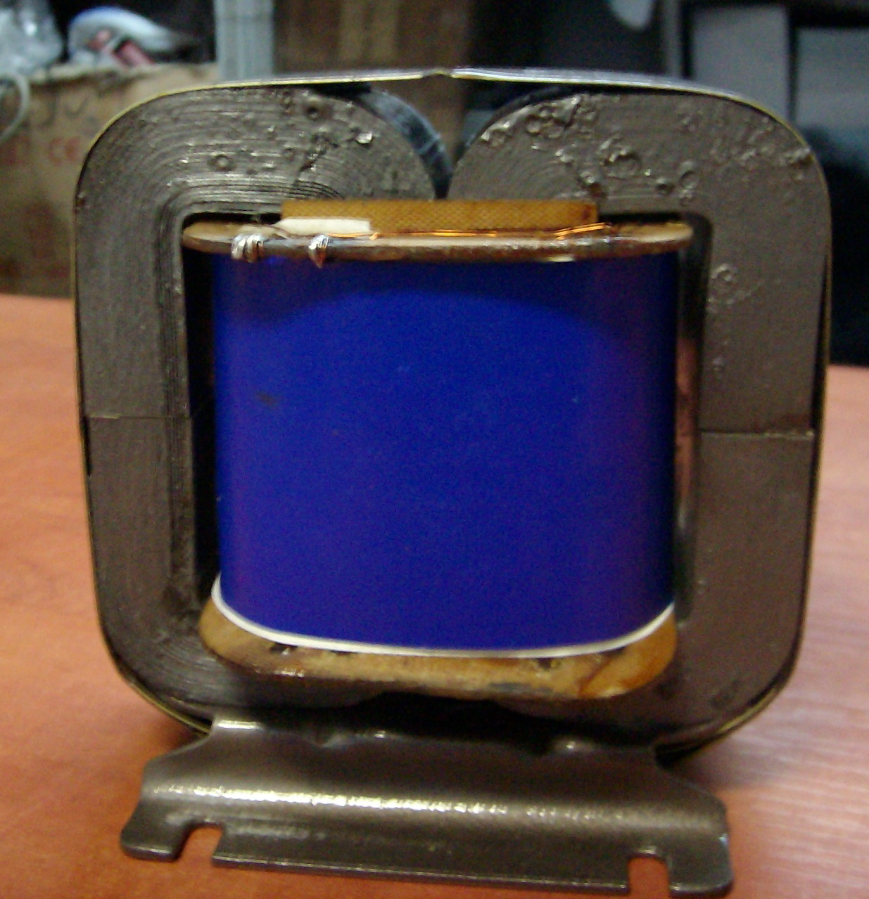

Interstage trafo 2K-2K (1:1)
Primary 2K at 20Hz
for tubes like 6E5P and other in a picture below
-3 db 10Hz - 45 kHz
Core S=12 sm2
w1-w2=2000+2000 d=0.22 mm R=150 Ohm (it better than Tango NC20 where R=400 Ohm)
8 sections
Io (DC) =80 ma, I max = 160 ma
Primary 2K at 20Hz
-3 db 10Hz - 45 kHz
Core S=12 sm2
8 sections
