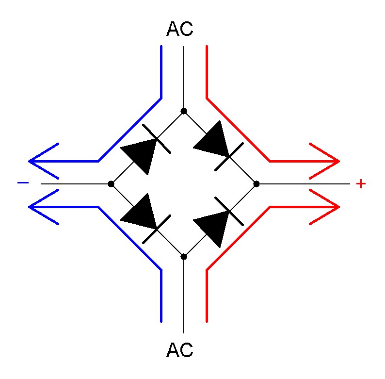

In a Full bridge rectifier the AC flows through two PN junctions in the top half of one cycle, then shifts 180 degrees to be rectified by the other two PN junctions on the other side of the cycle. WOW! I’m amazed at this point. At one time it was all moot to me. I guess I have some AC to DC intelligence that no others have? 😕 I can't go on believing that?
Get out yer' RMS DMM’s and verify. I can't be the only person to have this knowledge/experience?

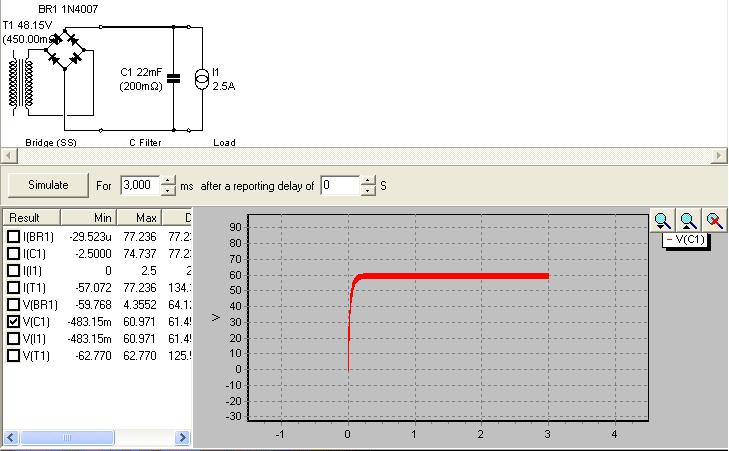

A 2X45VAC nominal 625 VA toroidal with 7% regulation delivers 2x60VDC after bridge rectification when loaded to 1/3 of its nominal current ability. Good assumption for energetic music average when fully driven. During prolonged peaks the system will sag more but only momentarily, and it has been psychoacoustically proven that the compression effect gives subjectively a louder impression before audible clip vs stiff supplies.

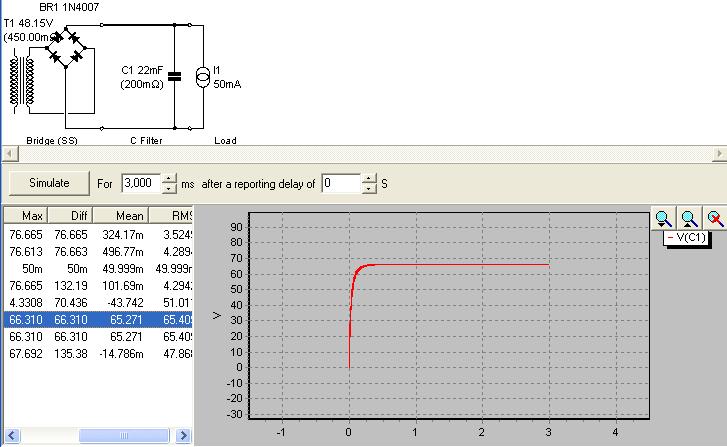

Now we are talking turkey, but can you back the "load" off to show these folks what a "semi" loaded power supply looks like after rectification with just a cap bank, a by-pass cap & bleeder resistor? I suggest PSU Designer II...and it is free to download and use for non-commercial applications.
Shawn.
salas said:Say with 50ma load? Momento.
Sounds good. Is this program you have available to all?
Shawn.
Shawn.
Yes, every tubehead like me uses it. Here
salas said:Its 66VDC for 50mA. Column diff. But why you care? Loaded working amp is the goal.

There is a small degree of uncertainty not intrinsic to simulation but to claimed regulation and nominal voltage toroid manufacturer quotations. For such a class of a PSU it takes about 16 transistors (stereo) to drag it down from its unloaded overvoltage to your calcs for 50mA bias each for our example. Practically you are dead on. That is what the user is going to experience on the DVM's LCD when biasing the amp.

the bridge rectifier across a pair of secondaries with the centre tap to the 0v common shows just one diode drop to each half of the dual polarity supply. i.e. two diode drops to the whole dual polarity supply voltage.
