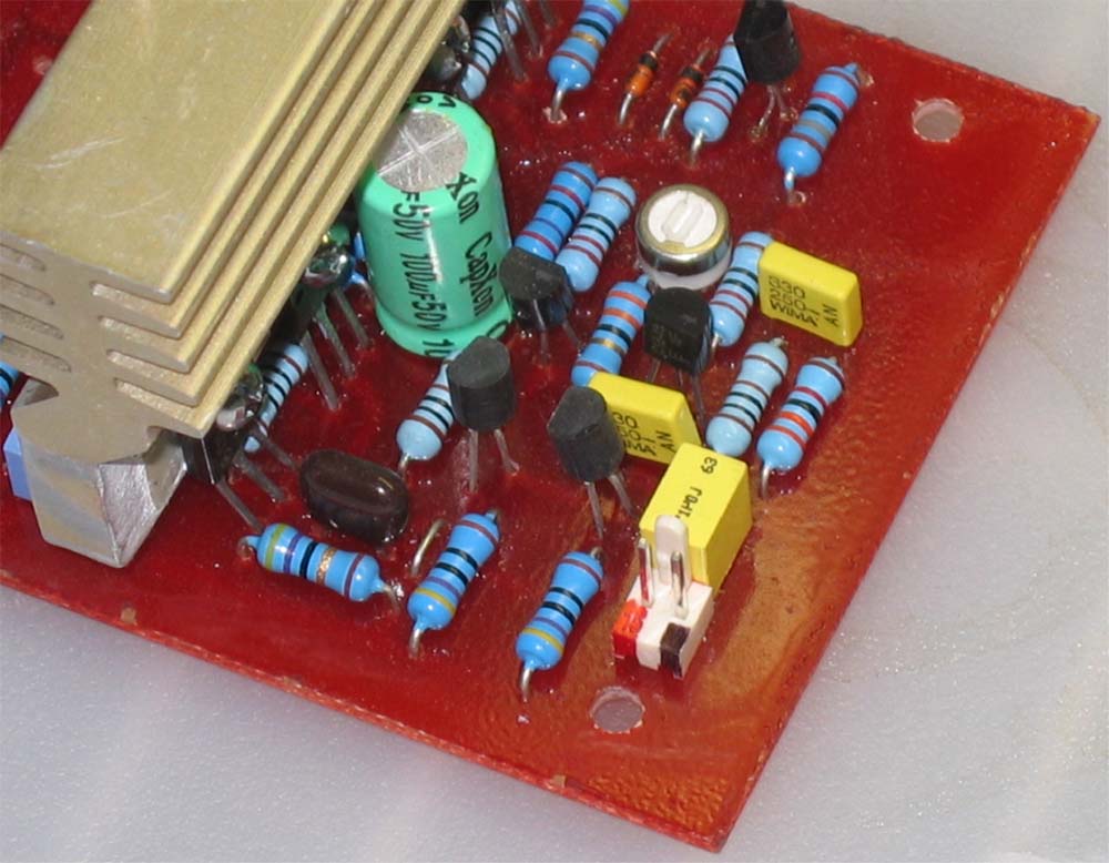

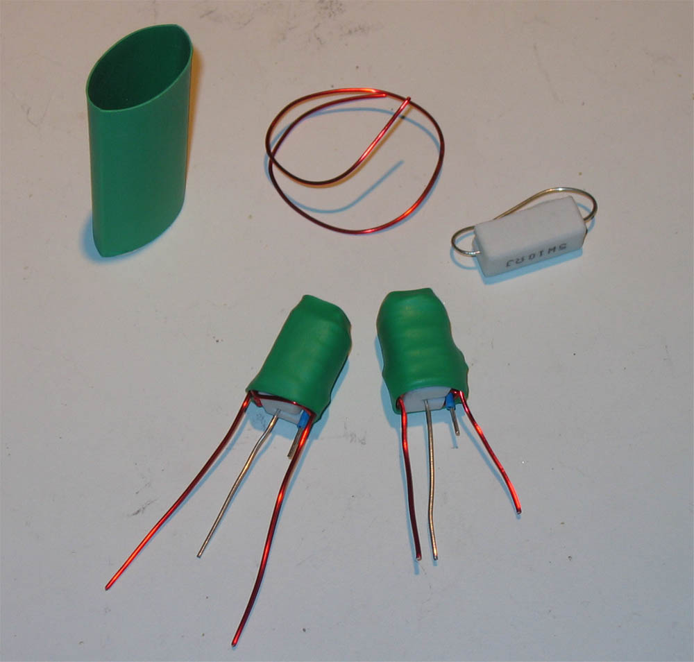

Quasi, thanks a lot for your help and for the email, i'll start working on the amp right away, i can't wait to see it working!!it'll take some time tho because the fets are rather expensive here. I agree with Spektor when he says you should have gone for engeneering, you already are an EXCELLENT amp designer tho, i wish someday i can get to do this stuff.
Anyways i have 3 questions about the amp. The first one, how do i do the impedance, the 4uH one, cause i think you can't buy those? can you tell me how to build it?
Are the fets isolated from the heatsink?
And the last one, in the pcb, in the upper left corner there are 2 pinouts without any marks, what are those? ground or what? I attach to the msg a picture of the pins i'm talking about.
Again, i can't thank you enough for your help, and congratulate you for this masterpiece you've created.

hernanstafe said:... how do i do the impedance, the 4uH one, cause i think you can't buy those? can you tell me how to build it?
Q is not too fussy about the exact value of the 4uH coil on the output as long as it is close. I googled an online inductor calculator to give me the approximate turns and wire length/gauge for a 1 cm core, in my case the 5watt resistor was the core size. I thought I had the page book-marked but I can't find it.😡
Perhaps the picture will help? Q uses a plastic bobbin for his inductor.
Shawn.
hernanstafe said:Are the fets isolated from the heatsink?
If you use "regular" FETs you will require an insulated pad and/or grease of some sort. I think there are FETs with isolated tabs that do not require the insulation pad but heat sink grease is still required for this type of package. Some folks use "rubber" type pads to insulate the tab without heat sink grease. So many options...
... in the pcb, in the upper left corner there are 2 pinouts without any marks, what are those? ground or what? I attach to the msg a picture of the pins i'm talking about.
As Black_Chicken said, they for the input signal. The pin that goes directly to C1 is the positive.
Good Luck and happy building! BTW technical people make great sales and marketing folks as they can talk the talk and walk the walk. shhhhh...sometimes they make more money than engineers but don't say that too loud around here.🙂
Shawn.
Regarding the output coil;
I wound 30 turns of 1mm wire on a bobbin 1cm in diameter x 1 cm in height. It worked out to 3 layers of 10 turns. As Shawn mentioned the exact value is not critical.
