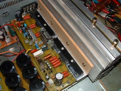

Hello Quasi
I'm sorry if I'm hijackng the thread but I wanted to let you know that
I completed the BJT quasi as per your design and layout.
And what a wonderful amplifier that one is, the dynamics are excellent
and the intrisic quality is admirable....Very satisfied with it!
I used three pairs of Sankens 2SC3857 on the outputs and the inputs are 2SC2240, matched pairs. The offset after adjustment is only 3 to
5 millivolts. My bias is 0.050 A but I'm not sure this will be the ideal
setting. May be you can make some correction on this one, could you?
I'm posting two images of the amplifier in a test bed that is not the definitive case, I still have to devise a cabinet for it with the whole
amplifier being so big and the transformer too. By the way the supply voltage is +- 62 volts.....
Again Quasi thanks for the excellent design.

Great work Jmateus
Hi Jmateus,
That looks like an excellent variation of the bi-polar version. Congratulations are in order, especially as I haven't even fired mine up yet.
Good to read that you are please with the sound. The bias at 50mA might be only a fraction low, you could add another 10mA or 20mA and see if there is much difference. Great work again
Cheers
