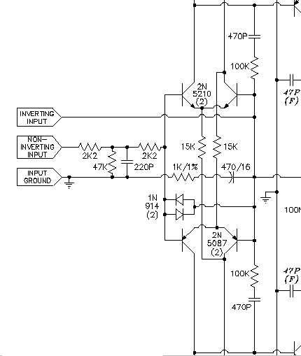

My Attempt at Adding Balanced Inputs
Ok,
Lets make it clear to start I have not tested the Balanced Input addition I made to the quasi "official" current schematic (nchan mos schematic only 06-05-06.pdf).
I have attached my attempt to add Balanced Inputs to the current quasi schematic using my still rooky knowledge and lots of emulating of a very well known designer's implementation for Balanced and Unbalanced inputs. My assumpution, which could be completely wrong, was I could use the LTP even though the designs I have looked at so far do not have the current mirror pair the quasi design has.
Please note that part of implementing this design attempt by me was I flipped the NFB R (R18) and C (C7) leg to ground. For clarity I added a "+" mark to C7 for those that choose to use an electrolytic or cannot find a Bi-Polar or non-polar capacator for C7.
Understand I have no design knowledge with respect to balanced lines at all, and very limited design knowledge. I have not tested this implementation of the Balanced Input. That said comments, refinements, design enlightenment and any willing soles that can test this if this first crack looks reasonable are welcome.
A side question results form the NFB RC leg to ground. I have noticed some designs over the months for the NFB RC to ground leg will order like quasi has done, R-C-Gnd, while other designs order it C-R-Gnd. Is there a reason why one order is chosen over other? As I can deduced at moment the R-C-Gnd order may allow the C when electrolytic to see a reduced DC offset voltage that it has to cope with, whereas with a BiPolar or non-Polar capacitor the design decision may be more related to using a smaller voltage C. Are any of my deductions valid?

Hi K,
sorry, that ain't right.
Go have a look at Borbely or Pass to see how to implement the balancing of an LTP input stage.

AndrewT said:Hi K,
Hi Andrew,
Before I posted the quasi amp schematic with my attempted Balanced Input addition I had been searching high and low for examples and any other information to enable me to add a balanced input. There are lots of stand alone circuits, many for microphones as that is a common venue. This meant less pickings for line level examples and information. I was trying to avoid adding a additional standalone circuit which enough examples and and proven designs existed. There was only one example I found that was part of the input stage which the schematic I posted in Post # 1235:
http://www.diyaudio.com/forums/showthread.php?postid=1082862#post1082862
was a result of.
With the hints you provided I searched yet again high and low (no balanced pun intended) and still came up with nothing despite my many efforts and kills at searching and digging. I could not even find any design information from either. Do you have any links, hints, or seach criteria that could help be find what you are referring to? It would be most appreciated as I have been doing research on this for well over a year.
I decided to be very creative in my searching and I found a very different topology design I have not even seen in standalone drivers. I have attached the implemented topology design so you can advise me if this is the topology design you had in mind?
Frankly speaking I think the initial one I added to the quasi schematic is more appealing. Is your objection to the one I made an attempt to implement unaceptable because the balanced side input has no HP/LP filter and DC blocking on its hot input?
