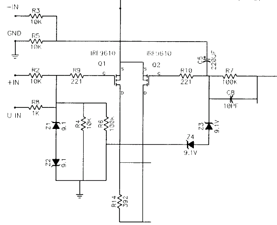

keypunch said:I have another balanced input circuit from a different schematic I like to take a "spin" on opinion.

Hi Key,
Take a look at this circuits...
http://sound.westhost.com/project51.htm
http://sound.westhost.com/project66.htm
http://sound.westhost.com/project87.htm
AndrewT said:it still fails both tests.
You have looked at Pass and then altered it!
Hi Andrew,
Actually Post #1241 is exactly as it is from the schematic. I have made absolutely no changes. There is a slightly different implementation in one of the other amps that I elected not to post as I was certain it would be less likely than this one to meet your approval.
The example from Post #1239 is not my design nor is it modified in anyway.
Both Post #1239 and Post #1241 are from high end companies.

Hi pejinm,
Thanks for your posting. I have been aware of these and a few other designs for some time and in fact offered two of you suggestions in Post #549. I did not offer Project 66 as suggestion as it is for microphone input.
I was attracted to the design concept that would possibly allow one to implement an unbalanced and balanced input. I am in favour of a discrete design rather than an OpAmp design. Though if need be, I can re-implement an OpAmp design by replacing the OpAmp with some known discrete OpAmp circuits.
My first post was an attempt to implement into the quasi amp as the design looked straight forward to do so re Post #1235, but as I noted may not be correct as I assumed some aspects of the NFB and LTP interfacing. The next two examples (Post #1239 and Post #1241) were as is from the schematics of two high end designs.
I have been assuming that with an already existing LTP in an amp input circuit that I could avoid another layer in the input circuit to implement a balanced input. It seems to me this may be possible. I have not made any attempt yet to take the collective circuits and research I have done and create a design that might work as I do not have enough EE knowledge to validate my attempt. I am using my logic, rational thinking, research and cut and past to accomplish my attempts. I am very confident that Post #1235 is correct in the sense of adaptation from the circuit I modeled from and seems to be backed up once I found the example of Post #1239.
Before I posted Post #1241 I was aware of ESP Project 87 and in fact wanted to first have Andrew's feedback of Post #1241 before I posted a link to one part of Project 87 to have Andrew's thoughts on. For the moment I have not done so until Andrew has had the opportunity to decide if he wishes to comment about my Post #1244. As FYI to Andrew, my last statement does no imply you need to comment on Post #1244, just that I rather let that thought trend complete/progress before I move on.
