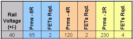

It has been posted a few pages back but here it is:
Supply voltage +_40V DC
One toroidal per channel each rated 30-0-30VAC @ 400VA

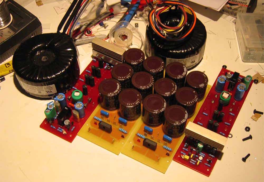

Hi Tomwaits,
30mF to 40mF is just about right if you follow the general recommendation of +-2mF to +-3mF per Apeak of output.
For a 4ohm load +-30mF can drive to a maximum of 15Apk and 60Vpk which equates to 450W into 4r.
However if you want to ensure stabilty between the various LF time constants built into the amplifier and PSU then often the PSU needs even more capacitance if the amp is designed to run flat down to 1Hz or 2Hz.
I have recommended 160mS to 200mS in the past.
8ohm +-20mF to +-25mF or 4ohm and +-40mF to +-50mF can achieve these low frequency time constants.

Hi Mr TOM W.
Nice PCBs ofcourse look on to page26.
Something look the same.
Regards zeoN_Rider
Regards zeoN_Rider

Re: Hi Mr TOM W.
I wonder where I got that idea? Kind of a tribute!🙂
Shawn

Hi Tomwaits,
these suggestions are not huge, I consider them to be normal for good to excellent low frequency response.
eg. +-20mF allow power output upto 180W (+-3mF/Apk)
and +-25mF goes to 270W. These are the target range that this quasi is designed for.
If you want good accurate bass I believe it can only be achieved if the amp does not wilt when asked to produce high levels of continuous low frequencies. I use the further rule that the input high pass filter be selected to be no lower than one octave above the PSU i.e. 80mS. This gives 4Hz @ -1db. 2Hz @-3db if the rest of the amplifier is designed to complement these performance parameters.
If you use the +-2mF/Apk rule then you can squeeze more power out of these smoothing caps, at the expense of more modulation of the power rails.
