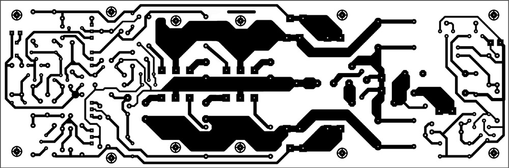

hi
quasi ,
I am planning to build an AV 5 channel amp . I would want to build an amp with 5 channels and a subwoofer channel . It would basically be a 5.1 amp .
For the subwoofer I would like to use the 10 fet board and for the 5 channels ,i would like to use a pair of outputs for each channel .
Do you have any layout for using a pair of fets for each board ,so that I would be having a smaller footprint board and subsequently save on the costs as well .

Hi Yug,
For a 5.1 system this is best met by using either stereo amplifiers or monoblocks, NOT by running speaker cables around the room.
+-50Vdc will give upto 200W into 4r and +-60Vdc upto 300W into 4r.
If you want extreme SPLs with low sensitivty speakers then +-70Vdc could go upto 400W into 4r.
With 6channel that's 2.4kW
and an expensive set of transformers and smoothing caps.
yes, keep the amplifiers next to the speakers or at a very maximum no more than 2m from the speakers.Do you have any layout

yugaaa,
I created 1, 2 and 4 pair boards about year ago with careful editing using GIMP. Since that time a flaw was discovered by Shawn on the PCB that explained many of the VBE adjustment problems many had. I have had a plan to redo the boards since they were updated for both versions (with and without DC protection circuit on same board) as well as make the DC protection seperate. the edits are time consuing, generally about 45 minutes a image, so a days work if all goes well without my human errors to make up the images.
I had also started a super guide that would reduce the common repeated questions asked of quasi. I started the document, but have not had the time in last 9+ months to work on in further. I hope to be able to, but it will take at least 2 months of solid work to compile and organize the information. Qausi's guide will be excellent for many. I do suggest you take the time to read the complete thread before asking any questions. I do not think there is a question, or very few, that have not already been asked or information provided before the question is asked on this thread.
Please read the discussions on SOAR in different places on the thread as many builders wanted to use alternate output MOSFET devices for many different reasons. You may find you wish to build the 2 pair verison outright or build with a pair first and then decide later if need to add a pair for better headroom and not pushing the SOAR rating of the IRFP240. There are losts of postings on SOAR specific calculations and simple calculations to allow you to determine how many output devices you will want to ensure the output devices are not blown.
I have have kept an eye on this thread and now the BiPolar version quasi recently opened. I have not been able to spend time on my interests since the summer due to personal matters and then overloaded with being a daddy to 6 kittens that were 3.5 weeks old found not far from where I live the first weekend of September. This is ontop of my 4 adult cats, who are walk on leashes. You can imagine how this approach filters down to the kittens getting time outside as well as their other normal demands as kittens.
Here are the links to get you started based on above as it will be a few months yet before I hope to be out of the current personal matter concerns:
Link to where I announced the site I have the noted different board versions with DC protection 11 Dec 2005, Post #253:

Quasi, please correct me if I am wrong, but this Vbe PCB error was the only error on the PCB aside from a couple of parts on the PCB that were on the PCB, but not marked with part or value of part. The 0.01uf cap near T8 seems to come to memory as pads and outline, but no part number nor value on PCB layout image.
Sorry all, I do not have all time in world to find all of these finer points. I can just recall all this off top of my head for now, let alone find links about them that takes lots of time. The Super Guide I started covers all of this and I have many notes to continue its work as many seem impatient to read this thread. I have a hot link table of contents and structure to make all of these common questions, formulas, and design flexibility titbits sprinkled in the thread to make it easy for almost all of those new to thread and unwilling to read the thread.
yugaaa, again I cannot too strongly suggest you read the entire thread to find these subtle things or compare to the board I made of pair, two and four almost year ago. Again quasi's guide will cover all the updates, but I have not had time to edit the boards for the Vbe trace problem Shawn found. It should be easy for you to take one of my .PNG imahes of quasi's board and with editing program "rub" out the extra PCB trace Shawn found.

Sounds good but I'd use 4 output transistors for each board as a minimum. Don't listen to Q about using chip amps, he's just tired after a long day of meetings, he didn't mean it. Your theatre sound deserves Quasi. I have a similar project to yours in the oven: I want 5 Q's in one case but each has it's own power supply and heat sink. Small voltage and power is still very good for my movie watching experience. Sounds like you have bigger demands, which is good.
