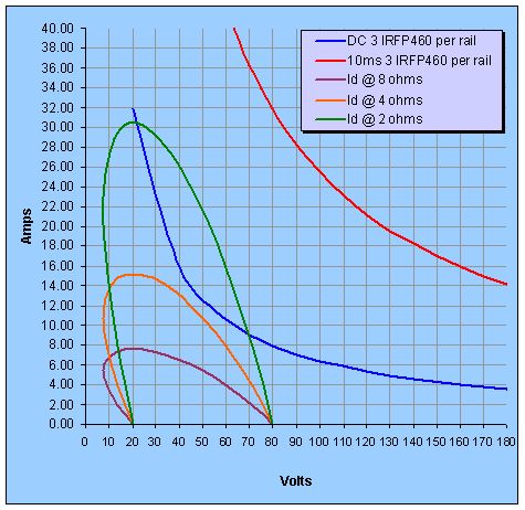

The chart attached shows the load lines for reactive 8,4 and 2 ohms typical speakers with a worst case scenario of current being 45 degrees out of phase with the voltage (Vds).
The modelling does not assume stable 8,4 and 2 ohm resistances and this explains the peak current of over 30 amps for the 2 ohm load instead of the expected 25 amps.
The 3 load curves are compared to the blue and red SOAR curves (derated for 50 deg C). The chart shows that the 2 ohm load line exceeds the DC SOAR but is well inside the 10mS SOAR.
Whilst I am comfortable with this load capability in domestic situations remember also that the best (and reasonable) power supply will still drop around 5% and this makes for extra comfort.
I note that testing an amp into 2 ohms (sine wave & several seconds) would be risky but this scenario never happens in music content. Having said that, most (all?) people bench test amps into resistive loads and with a 2 ohm resistive load the load line just crosses the derated DC SOAR (not shown here). So under typical "test" conditions the amp will be fine.

Hi Quasi,
your explanation almost reached the same conclusion as mine.
But your logical analysis stopped just short of the correct answers.
A 4ohm reactive load that takes the output stage to just inside the Tc50 SOAR should be safe for most 4ohm speakers. You should be able to test your amplifier into a simulated (45degree) reactive load and provided one takes care to avoid exceeding the Tc<50degC condition the amp should always survive.
Are we agreed on this first point?
We may disagree about whether DC, 1Second, 100mS or 10mS SOA be used to define our safe limits. We leave that one to production/long term testing.
Now consider the 2r resistive load. You have not drawn the 2r load line but just like the 4ohm reactive falls on the same (safe) side of the Tc50 SOAR. This implies that the amplifier can be tested in the same temperture controlled manner as was applied to the 4ohm reactive load.
I use 60degree phase angle and for my situation the 2r load is much LESS stressfull than the 4ohm 60degree load. For your 45degree 4ohm load the 2r load is slightly less stressfull than the 4ohm load.
The advantage of the half resistance test is loading and current testing of the PSU, cabling, connections and fuses and moves closer to the short circuit condition to prove the amp won't blow up when abused. Close rated line fuses will probably blow in this test, but that just proves one has selected the correct fuse rating.

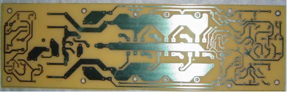

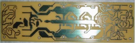

Re: MY 1st PCB for QUASI AMP
Looking good but don't forget to scrub off the remaining photo resist...its the blue/green stuff on top of the copper. You should be looking at shiny copper traces by now. I use medium steel wool to scrub my boards but many people find it TOO harsh so they use coarse scrubbing pads...as you were.
More Quasi in the oven! I like it.
Shawn.
jhoel47 said:My friend manage to find the photo etch PCB in manila...
Shawn.

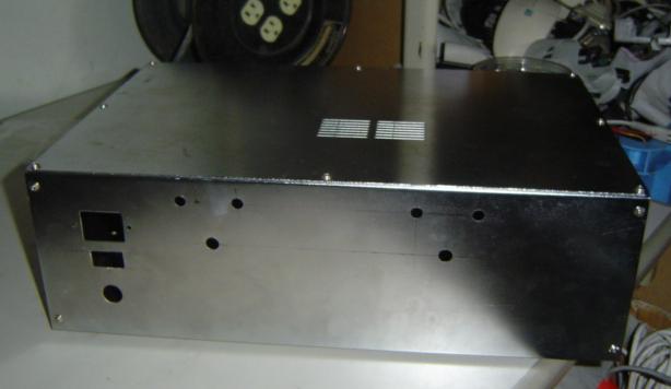

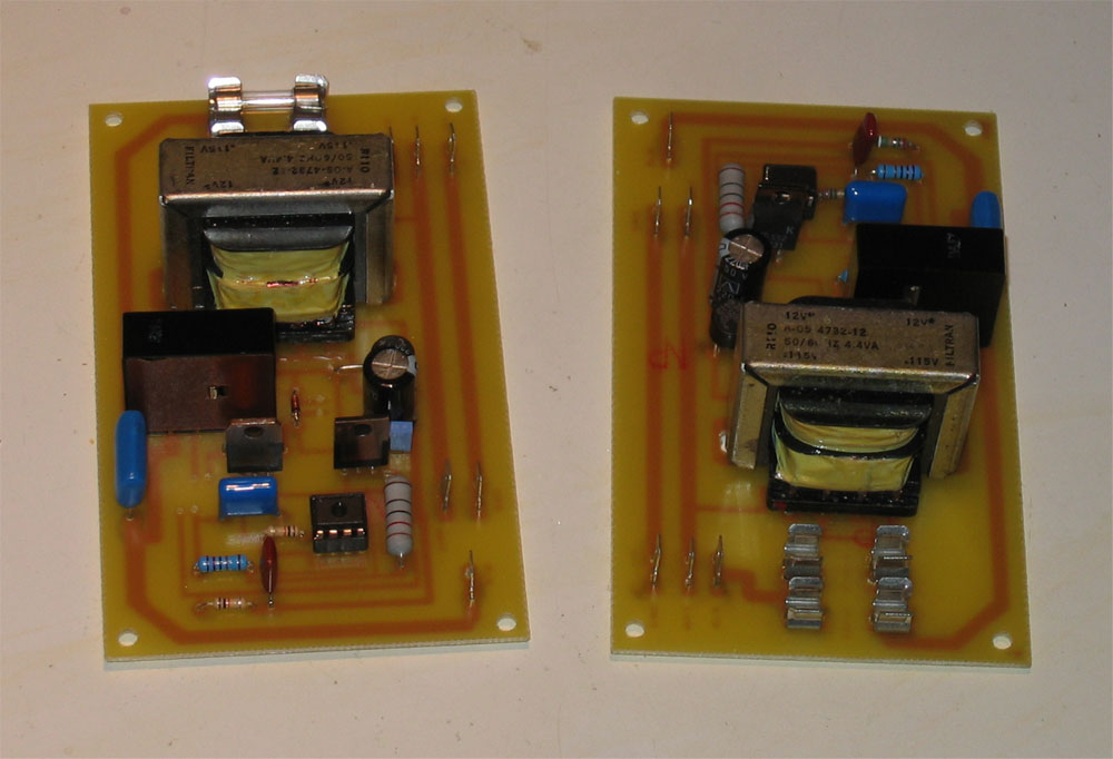

Power Supplies
I made some 24 volt power supplies for Quasi. I included a momentary Flip-Flop circuit for my momentary power switch. Also, I included board-level fuses for the main XFMR and the sub XFMR. Oh yeah, and the LED resistor and connector are on there too.
BTW, nice case Joel! You are fast! You will beat me in the race for the next Quasi! You make lots of posts to the thread, I like that...It reminds me of...bla bla bla ...me.
Shawn.

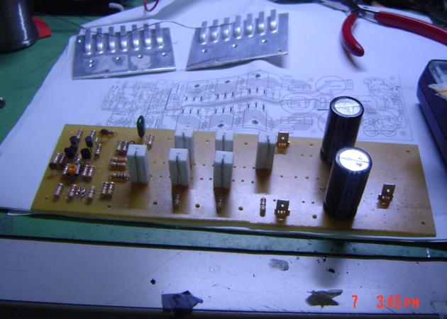

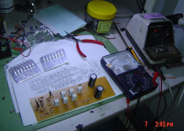

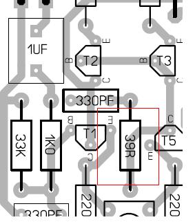

33ohms or 39 ohms?
Hi Quasi
Question about R9 , layout it was 39ohms ,but in schematics it was 33 ohms , which one should I follow?
Can I use Mylar cap in place of .1uf MKT cap? Its not available in local electronics supply here.
Thanks for your reponds.
Joel
