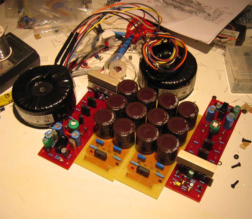

Sebastion nailed it. I, like many others around here etch my own pcb's at home cause I get them when I want and they are very cost effective if you are willing to work with chemicals. Here is my attempt to explain the process that I use. Watch out, it is a pdf 😀sek said:PDF files in general are print-alikes of documents (of any kind).
The files You're trying to use can't be converted into gerber format, but can be printed out by You or a board house in order to make PCBs via UV exposure techniques.
You should ask Your board maker about their possibilities to handle PDF layouts. But as You can see from Shawn's pictures, this method can be done "Yourself" (DIY). 😉
Sebastian.

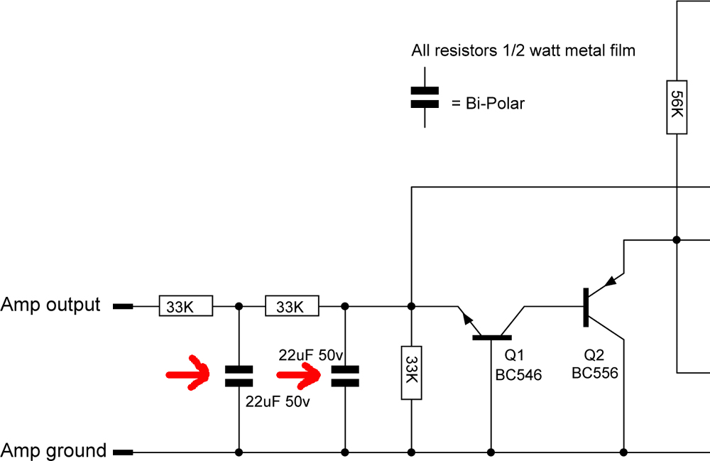

DC Protection Circuit (substitutes) ?
I already have a bunch of little 10uF bipolar caps that I just found in my stash. If I change the value of the 33K resistors can I substitute my 10uF caps for the 20uF caps already being used in the circuit and achieve the same result?
Shawn.
Shawn.

Hi Tomwaits,
those two input caps need to be Bi-polar or non-polar.
Nono polar could be mono polar or non polar, I cannot tell.
Each half of the 2pole filter has a 700mS RC time constant.
If you replicate the RC then you will mimic the filtering before the detector.
Your proposal will increase the resistors which has the advantage of reducing the voltage going into the detector, particularly if the amp output slews to one supply rail. But will also reduce the detector sensitivity.

AndrewT said:...Each half of the 2pole filter has a 700mS RC time constant.
As always, thanks Andrew,
t=rc
t=726uS but there are two RC's in parallel, why? Is t doubled by using two RC's one after the other? Does this make t=1.452mS for the over all RC? I guess two stages of RC help eliminate transients of soft clipping or low frequency audio signals from tripping the relay unnecessarily?
Substituting 50K R's for 33k R's and using my 10uF bipolars instead of the 22uF, the circuit would respond around 1mS. Could be better or worse? I will give it a try or find some better 22uF caps. Your thoughts? I have some time before final assembly.
