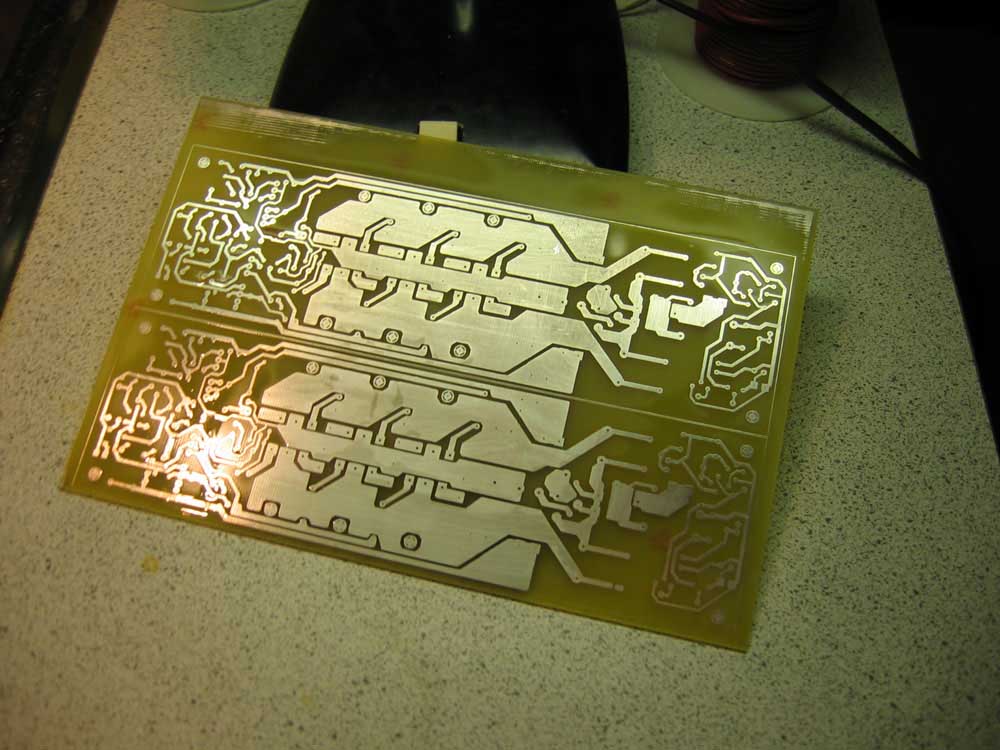

Re: Error 200 ohm Pot (hard to set BIAS)
Well spotted Shawn. This is indeed an awful error. Mine setup fine though and I suspect many amps will depending on the rail voltages used. I will post a revised PCB soon.
My apologies to anyone affected.

R6 needs to be changed for different rails.
> 60 volts R6 = 18K
30 - 60 volts R6 = 6K8
less than 30 volts R6 = 0 ohms (link)
This must be done or the first stage won't work properly.

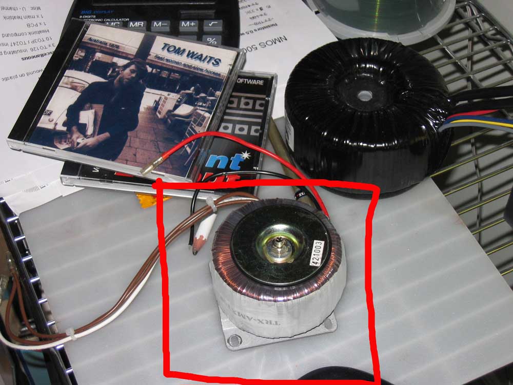

Plate amps
As my semi-final Quasi (I planned this along time ago) amp I will make 5 plate amps, each with its own supply, heat sink, transformer, PCB and heat sink. I found the "baby" Toroidal just the other day! They are pulled from a series of subwoofer amplifiers and they are very compact and I guess each may deliver 80~120VA so one per board would be nice. Of course this all goes into one big fat case and delivers the love to the theatre set-up.
Shawn.
Shawn.

The smallest Quasi's will only have 4 Fets per amp, Q, does that change anything more on the previous post ?
Shawn.

The number of FETs does not change anything other than the power handling. All other components stay the same for the voltages used.
I thought the amp design was finalised until Shawn found an error recently. I will post corrected layouts soon. This will be the only other board for this amp I will release.
