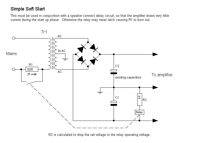

hoangduongo said:I found that your DC detector is quite identical to the one from Silicon Chip, except some small change, I think it's because SC use 12V relay, I'll post that schematic later.
Yes the DC detect circuit I posted has been used by at least 3 major electronics magazines in Australia for more than 25 years. It's simple and effective. See http://www.diyaudio.com/forums/showthread.php?postid=776114#post776114
I have changed some of the component values to suit my timing and operating voltage requirements.
Cheers

Hi Quasi,
can you correct the note from R1 to R2. Most will recognise the error but a few may be confused.
AndrewT said:Hi Quasi,
Thanks Andrew,
Yes folks post 920 is incorrect. Please refer to this schematic.
Cheers
Q
Hi Quasi,
A time honoured circuit indeed. R1 is at least 1/2 that value in 120 VAC land. Your time constant should be on the order of 1/2 sec to 2 sec, before the relay timer connects.
If the amp suffers a failure, R1 is designed to burn out. This is very common in many larger amplifiers. Marantz, Denon and Nakamichi all come to mind (with R1 values ranging from 2R2 to 15 R).
-Chris

anatech said:Hi Quasi,
-Chris
I guess the value of the resistor in question depends on a few other things too, ie; transformer size and the amount (number?) of capacitors.
Cheers
Hi Quasi,
-Chris 😉
Yup. And the whim of the designer.I guess the value of the resistor in question depends on a few other things too, ie; transformer size and the amount (number?) of capacitors.
-Chris 😉
