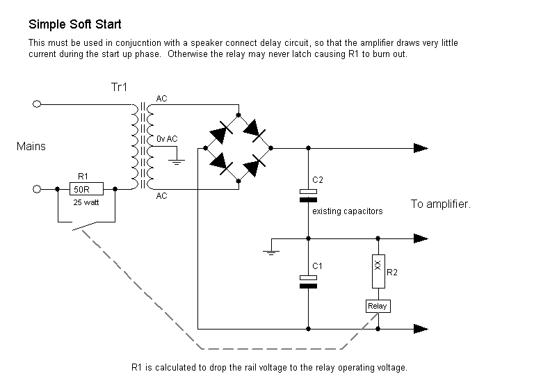

Hi quasi, I have another questions:
1. In your softstart circuit, if I want to use 12V relay, what do I have to change?
2. Must I use a seperate xformer for the softstart circuit, or can I use the 0-15VAC line from main xformer?
3. the main line in my country is 220V, what else would be change? i read in ESP that the value of the 5W resistors depends on ac the main line and power rate of main xformer.
Thanks, quasi.

You can use a relay rated to the voltage you are going to run the soft-start board at. Ie; you can run the board at 12 volts and use a 12 volt relay. Your timing will change though and with a 12 volt supply it will be longer. You can fix this by changing the charging resistor.
Or you can run the board off 24v DC and put a resistor in series with the relay coil. To halve the available voltage the resistor value should be about the same as the relay coil resistance.
You cannot use the secondary of the same transformer for this circuit because the transformer voltage will rise slowly and may never get to the voltage required by the slow start circuit before the resistors burn out (a few seconds). There are other ways of using the transformer secondary and I'll send something tonight (I'm at work now).
The values in the posted circuit will work fine for a 220v AC supply.
Cheers
Q

Quasi, thanks for your help!
Now I'm looking for a small transformer for the softstart circuit, I use 12V relay, so the the transformer should be 12VAC, right? Is it better if I use a bit higher Dc voltage for that circuit, such as 15VDC?
I found that your DC detector is quite identical to the one from Silicon Chip, except some small change, I think it's because SC use 12V relay, I'll post that schematic later.
I'm waiting for your work, Quasi 🙂There are other ways of using the transformer secondary and I'll send something tonight (I'm at work now).
quasi said:There are other ways of using the transformer secondary and I'll send something tonight (I'm at work now).
The days a very long this side of the world....here it is finally.
This circuit can be adapted to run of the 15v windings.
Cheers
Q
