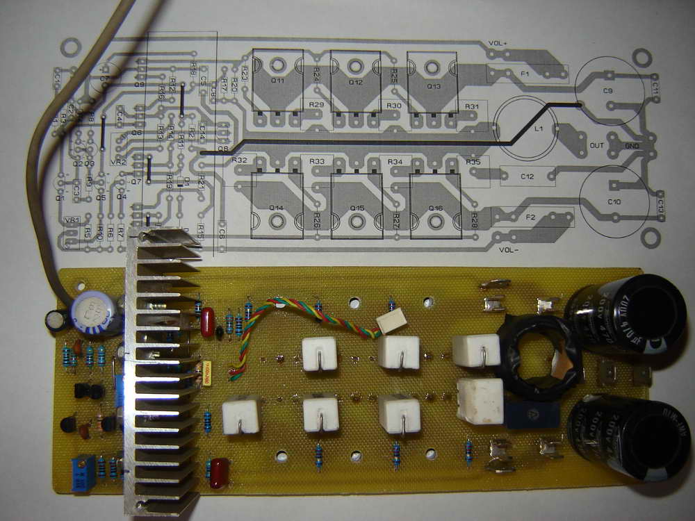

Hi guys.
I was too busy the last few days, so I can only test my amp yesterday. When I tested it, I have a prob: I couldn't set DC offset and bias current. No matter how I adjust VR1 and VR2, the DC offset and bias current varied all the time. The offset varied from 0mV to about +/- 150mV, and the bias current varied but had a alue only a few mV across the 100ohm res.
At first, I thought may be the mosfets were dead, therefore they draw no current, but surprisingly, when I connect a speaker( the Dc offset was not so high so I can connect a speaker without prob) and a signal to the amp module, it worked!It worked very powerful and quite quiet( there's still some hum, but I think it's normal).
I'm so confuse now, can you guy help me figure out what's wrong? Thanks.
And here are the pictures:
The amp module
The amp module
