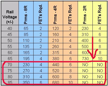

Hi Tomwaits,
using the irfp450 data and 44Vac transformer.
The 5pair will drive any 4 ohm speaker to 60degree phase angle when Tc<=50degC. and stay within the DC SOAR. In other words all day if the heatsink can maintain that Tc.
It will drive a 2ohm load to 30degree phase angle within the DC SOAR.
Taking a guess at a 100mS power limit of about 150%(=285W) of DC, since 10mS power limit is 500W or about 2.6times, this seems reasonable.
Using this 100mS power limit, as advocated by Quasi and others, then the 5pair can drive 2ohm to 60degree phase angle.
This indicates that the amp can conditionally drive any 2ohm speaker but you must not allow the Tc to exceed 50degC and the repetition rate for exceeding the DC levels should be relatively infrequent.
Domestic use and no distortion (onset of clipping) on transients should allow both conditions to be met.
For PA use big, possibly blown, sinks would allow 4ohm duty all night.
BTW. the sheet predicts power outputs of 200W into 8r, 350W into4r and 500W into 2r. Not quite three times into quarter load resistance but getting close. I use the three times & quarter as an indicator of a good PSU & output stage combination.
Finally, your smoothing cap choice only allows for 8ohm duty. The PSU ripple and RC time constants do not suit lower impedance loads.
edit:- I just increased the smoothing caps to +-45mF/channel and the 2ohm power came up to 600W. Now the drive voltage only drops 1.3db into quarter load. Go for it.

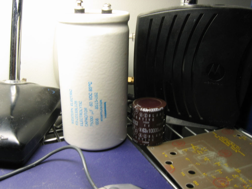

T, that is great stuff. Do you mean you increased the main cap bank to 45,000uF per rail to get the better result? I have dozzens of 10,000 63volt Nippon Chemi Con and if I remove the two big caps I can install at least 60,000uF per rail. Very close to the rail voltage but I fail to see any danger here. What are the general thoughts on those 63 volt caps?

Shawn,
If I may jump in here having used the Bensen spreadsheet and the reading I have done today.
The answer to the question is yes, Andrew is sugesting 45,000uF. Not only will you have a better result, you will have much longer life for the filter capacitors. The reason is less internal heating due to ripple currents. Not having the specs of your current filter capacitor, it is also possible with the lower impedances such as 2 and 4 ohms that those loads may exceed the ripple rating of your current filter capacitor (about 21,000uF I seem to recall) even though it is a Sprague.
As capacitance is increased, voltage rating a minor effect, the ripple capacity is small compared to the increace of capacitance. I happened to look at ripple ratings of capacitors earlier today based on research and reading I was doing today for the speaker load phase angle effect on load the amplifier sees. As typical examples of ripple current rating vs capacitance from one data sheet for same capacitor type:
63WV (RLQ):
uF/Amps
470/0.260
1,000/0.450
4,700/1.55
10,000/2.150
15,000/2.700
As you can see there are dimishing returns quickly in terms of ripple rating as the capacitance increases. It pays to parallel the PSU capacitors not just to reduce ESR, but you get more rippling handling at much less cost while also reducing ESR. When you you have capacitors in parallel the ripple demands are shared much like one parallels output drivers to share the current handing load.
One can extend the life of the capacitors a few orders of magitude with even a modest reduction of the ripple demand on the capacitor. Examples are a 5,000 hour 105C (RPX) rated life goes to 160,000 (18 years) by reducing the ripple demand by half (55C) of its rated ripple rating temperature, or a 5,000 hour 85C (RTX) rated life goes to 80,000 hours (9 years) at 45C.
Aside from the lower cost of using lower capacitances in parallel, you save on future replacement costs due to lifespan of the capacitors runnign at or beyond rated ripple rating.

Hi Shawn,
Those capacitors will not be suitable for your amps based on the rails of your amp being +-61VDC.
You need to have at least capacitor rated higher than your rails. 75V would be fine, though 80V or 100V would be a better choice simply in terms of lifespan of the capacitor. Higher than 100V is of course great, but cost and size to fit into your amp woudl be the other considerations. As my last post suggested the ripple current rating though higher, will not be all that much higher for the size of the capacitor. Not to mention where will you fit this in your amplifier 😉

TomWaits said:I have had these other caps around for a while:
Western Electric 75,000uF 60VDC
They are dying to get inside of an amp 🙂
Shawn.
Hi Shawn,

AndrewT said:Hi Key, the device Vds or Vce.
Hi Andrew,
*I need to go to sleep, too much to do, not enough hours in a day*
Sorry Andrew, but is Vds or Vce inclusive or exclusive of the losses the devices will not swing +Vrail to -Vrail by? It would suggest to me that the answer in inclusive of losses as Vgs and Vce is what the load will see as the voltage swing. Then again, maybe there is something I am missing in my current understanding. (I have purposely ignored the fact a quasi (not the person ... lol lol ... then again maybe quasi is strickly a n-channel design 😉... sorry quasi I have been itching to find the right moment to say this) complementary design that this swing is not symetrical just to make it easy for the purposes of the question.)
John L. Males
Willowdale, Ontario
Canada
17 July 2006 05:11
Re: Driving 2 ohms with higher Rails
I ran some SOAR models (that produced some of the SOAR & load curves I posted) for two ohm loads. With greater than 65 volt rails the load lines were too close to the 10mS SOAR for my liking. Even the output track on the PCB is too thin for this type of power. Into 4 ohms this amp will be rock steady with any of the recommended voltage rails.
Remember also that the intention for this amp (posted somewhere I forget) is to be used in a domestic (albeit very powerful) situation. If the amp is to be used into 2 ohms, please only at home. One more time.....This folks is a high quality Hi-Fi amp not a band or PA amp (although it could do a good job at moderate powers).
I did start another thread for a higher power (more efficient amp) but sadly my new job is very demanding and I have been dragged away. I will return to it ...someday.
Cheers
Quasi
TomWaits said:Why does Quasi not reccomend driving a 2 ohm load with rail supply higher than 65 volts?
Shawn.
