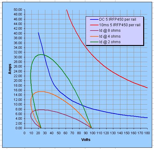

The SOAR graph I attached in post #751 is incorrect. This chart is more accurate for a typical reactive 2 ohm load (61 volt rails 5 IRFP450's per rail).
It's worse than I thought but I would still be comfortable driving into 2 ohms in a domestic situation (big heatsinks).
Cheers

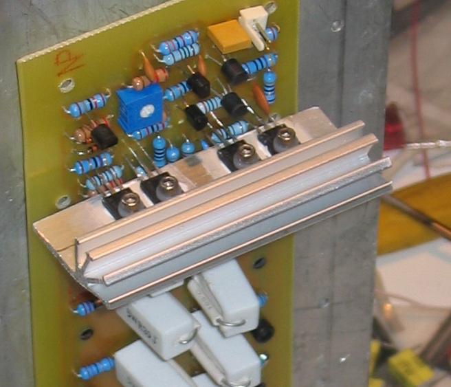

Driver Heat sinks
quasi said:
... I like the heatsink Shawn used if that helps you.
Quatro, you are a good man. I have made a pile of these heat sinks since the first set (I'm getting ready for multiple channels). If Duong is willing to buy me a coffee some day 🙂 , then I would be pleased to send him a few.
Sounds like Duong has it under control anyway.
Send me an email off list to receive your free "Quasi" driver heat sinks.
Shawn.
