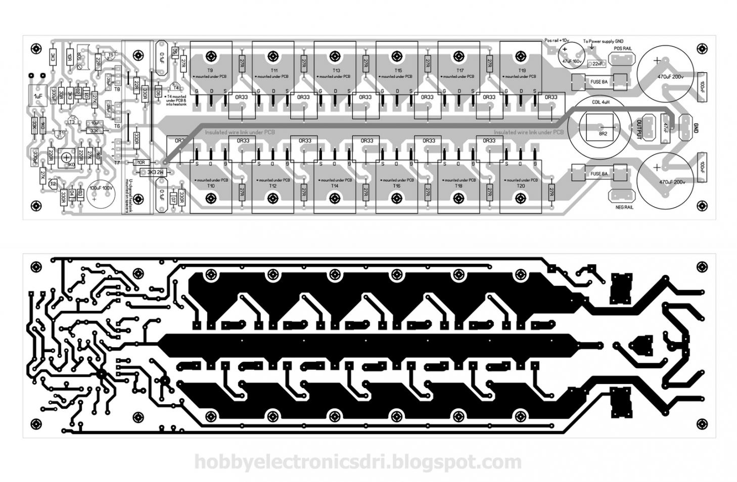

i diy my pcb please share this version in single sided,i will gladly built this i have a bunch of irf460 just please share 1 sided pcb,

use double sisded pcb you will need 81 x 200 for 300 W including all protections and balanced input

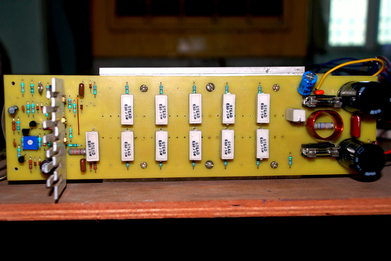

HI Ingenieus,
Last night i tested my n mos 400,600, irfp450,
with the 30-0-30 traffo, but the out put is very very low, can u help me out? pls give me a suggestion

What output is very low?
The Output offset when the input is shorted to signal ground?

I have only this one module

sound is good, but I don’t have any measurements…

uhhhh,i tested but not measured yet, sorry for that,
i will give the measurement on Friday, n pls suggest me a 15" speaker for B500,

i test this but the power is too low,
your design is different without any protections...check my PCB

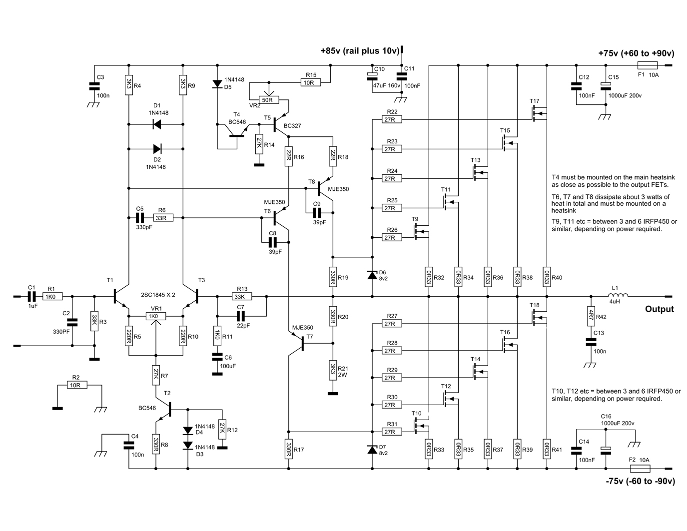

please provide your schematic
I m working on this layout, with 6 irfp450, n the supply using +-30 for just testing
THIS is sister from Quasi NMOS AMP, I dont have build this circuit
Hi Sandeep, You should not run this amp on such low voltage rails. If you must then R7 needs to be replaced with a lower value resistor, try 4.7k. This will ensure the first stage constant current source works properly.

Hello have a problem with NMOS300/500
- amplifier has a little quiet noise without Input signal from tweeters
- and if I do connect Input to ground the same quiet noise comes out from tweeters
I can hear it 4 meters far away from spaekers
does somebody have similar experience or a solution ?
attachment schematic
