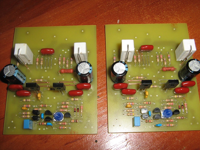

Hi, everybody.
Prompt please: what standing current at NMOS200?
And that I bring together the amplifier, I do not know what current to expose.
Whether also it is possible to use condensers to 1000 pF on tension of 50 volts in case of a power +-35 volts? Or it is not enough?
PS If not so expressed I am sorry, I from Russia, know English badly, I use the translator.
PSS Yet up to the end completed, I look for angular heat sinks.

Constant current is about of 30 mA.Prompt please: what standing current at NMOS200?
Yes it is.Whether also it is possible to use condensers to 1000 pF...
Biasing amp
I am building the Quasi NMOS 500. I used .15 ohm resistors instead of the .47 ohm Quasi used as emitter resistors. In the construction guide Quasi states that the amp should be biased to 30 ma per output transistor.
5. If everything seems ok adjust VR2 to set the output stage bias current, by measuring the
voltage across the positive rail resistor. Adjust for a reading of 3 volts per output FET pair. I.e.
For a 6 FET board set for a voltage of 9 volts. This equates to a bias current of 30mA per
FET pair or 90 mA total. For a 10 FET board set for a voltage of 15 volts.
6. If everything seems ok, check the output offset voltage and adjust VR1 to achieve an offset of
less than 10 mV.
7. All being well switch off, back off the bias control trimmer (VR2) and replace the 100 ohm
resistors with 10 ohm 1 watt resistors. Switch on again and re-adjust VR2 to get 0.3 volts per
per FET pair across the positive rail 10 ohm resistor.
Is this final setup still correct even though I used .15 ohm resistors instead of the .47 ohm Quasi used?

Try using the same Vre value, i.e. 30mA across 0r47 = 14mVre
Using this value of Vre will result in ~100mA of output bias current per output pair.
This may be too much both for heat dissipation and to minimise crossover distortion, but it is a starting point to work from.
