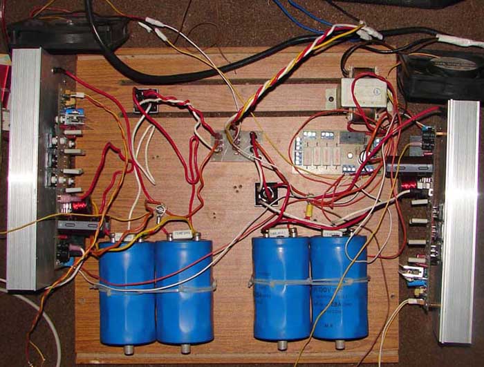

found the problem thou, a faulty diode. it was conducting in both directions, acting like a short circuit. it destroyed Q5, and it didnt even smoke.
sorry for the size.... here is a pic of the board. the L bracket will then be mounted to a proper heat sink, and the L bracket has a thermal cutoff switch on it for 70degC. That will then cut power to the DC detect circuit, isolating the speakers.
Looking forward to hearing it once i get it mounted.
Hi canca87,
Tks for the alternative for mounting the outputs. That's inspiring. Do you had a hard time soldering those that are befind the L bracket in the first photo?
Is the bracket mechanically attached to the pcb ? If not, there could be a lot of stress on the soldering points of the outputs which in my very limited sense, is a terrible idea. You must have anticipated that, I guess.
About the DC detection circuit, I am a bit confused. I thought that if there is no power supply to the DC detector. the speakers are always connected. It seems I had some mis-understanding or....
Anyway thanks for the new way of heatsink mounting.

compliments to a great amplifier... everything went beautifully, powerfull, clear.
yes i had anticipated greater strain on the solder joins, the board it screwed down onto the transistors, holding it on the bracket. Heat transfer from the bracket to the heat sink isnt perfect, but its good enough for now.
anyway, just to let ya's know. definatly recommeded.
I use brackets too , use artic silver(computer processor)
compound and bevel screw holes to get as flush as possible(so compound creeps out all around bracket),then really tighten
screws. worst case you might lose 0.1C/watt ,but it wont
affect the amp at all....
