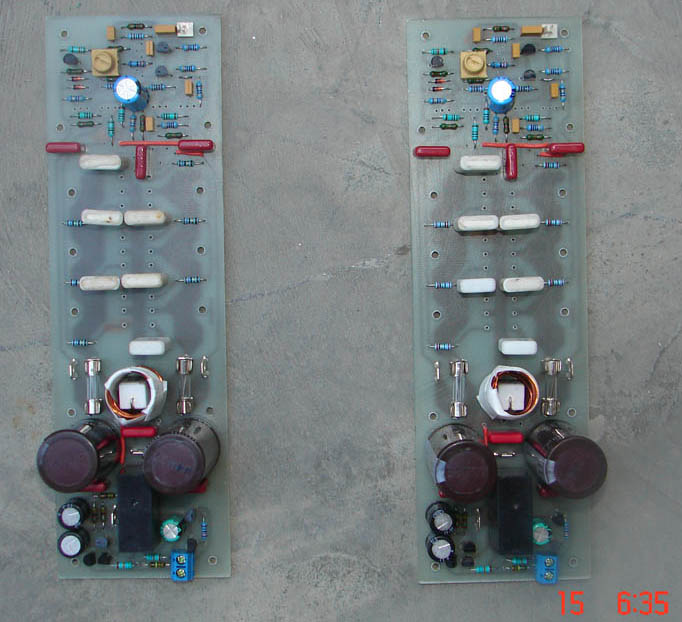

Hi Quasi,
I spend the whole night and almost completed two Nmos350 channels.
I want you to have a look all the resistors I have used 1/4W the power resistors are 0.47ohm5w. Do you want me to double any resistor to achieve 0.5w or will it work fine?
regards
Wasim

Hi ,Quasi
I have completed a full HT sub using your amp (modified brother
of Quasi - MJ15003 x 4) , now I want to build a modified Nmos 200 (4 output -IRF 240 version) .
What I would like to ask is can you put all 4 MJE 340/50's on the
main heatsink instead of the 2 drivers and VAS separate like on
your version.
I want to do this to simplify my layout and am concerned about
the effect on thermal tracking this change might produce.
By the way, your topology is very ideal for HT sub use,very strong
dynamic bass. A very rugged amp for room shaking abuse.
Thanks a $1M for this supurb design!!!
can you put all 4 MJE 340/50's on the main heatsink
instead of the 2 drivers and VAS separate like on your version.
and am concerned about the effect on thermal tracking this change might produce.
Hello ostripper.
I would keep it like quasi has designed it.
Because you are very right:
This would produce changes in the thermal tracking.
Thermal Tracking is one of the more difficult things to do
when doing the final trimming for a welldesigned amplifier.
And this is what quasi has done .. for sure
For this trimming you have to be clever & have good knowledge of transistor data and characteristics.
If you want to get your power amplifier right.
This is especially important for Class AB amplifiers as they have very different temperature
when low power and when higher power output.
Class A works more or less at Max temperature all the time.
With smaller differences & most often with less Thermal Tracking issues.
Thanks for the reply ,lineup .. but the reason I asked this was
because there are different layouts in the Quasi group of amps.
Namely, between the nmos 350/500 with all 4 340/350's on the U
shaped sink (vbe on main sink) and on the nmos 200 only VAS
340/350 on it's own sink (drivers and VBE on main sink). So , both amps seem to work good according to many DIY'ers even with this different layout .
Anyway, without any ill will , isn't this a "power amp under development" which means it should encouraged to modify it's
design in any manner or form ?
As stated in my last post , my "baby brother of Quasi" w/4
MJ 15003's is heavily modified with:
1. separate driver board
and point to point wiring to adapt to an old power supply
heatsink block.
2.LED constant current source w/.1uf bypass cap.(Aussie amps,
Ampslab,Elliot sound labs)
3.Outboard large fuses and Zobel network connected direct to PS
star ground.(cleaner driver board ground.)
4. Output inductor is the sub's lowpass Xover.(Quasi, is this acceptable?)
5.Absolutely overkill for a sub amp but I'm a perfectionist.
I thought putting all power devices on 1 heatsink would eliminate
the 'very warm VAS" I read about in some posts and maybe
greatly simplify construction.Also, the very small amount of heat
contributed by the VAS is a fraction of the total amp's dissapation.

ostripper said:Thanks for the reply ,lineup .. but the reason I asked this was
and maybe
Also, the very small amount of heat contributed by the VAS
You are right in much you say and
I am no expert on this special quasi model.
But my guess is that quasi have a good reason for add some extra heatsinks to VAS.
And this reason usually is of temperature issues.
If there wasn't, there would be plenty enough room on the Main Big heatsink!
Development it is!
But in this case is may be a less good development - an one way alley
that will force you go back.
But quasi will know better than me.
He knows his amplifiers like his own back-pocket
I have never heard of anybody afraid of 'too warm vas'.
If is too warm, you just make the VAS heatsink a bit bigger.
Think the other way, please
The total worst case of Main heatsink heat, at high or full,
is a lot more than the VAS transistors may like to have.
Than if they are at their separate heatsink.
This is one good idea with having VAS in their own place:
they would not experience a lot of temperature difference at all.
As they usually will work in Class A = constant temperature (almost)
Wasim said:Hi Quasi,
regards
Wasim
Hi Wasim,
You can use 1/4 watt resistors for all the low power resistors. The resistor biasing the two diodes in the ccs (R11) will get warm but still dissipating under 1/4 watt.
Cheers
Q
