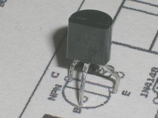

inverted transistors!
Hello Vivek, Quasi et al,
I just discovered a very wrong thing in my modules, and maybe Vivek has the same situation too.
My BC547s(replaced from BC546) and BC557 (from BC556) are all mounted in inverted manner? This means, that the CBE pin confiuration became EBC!...
As I stated previously, that I was having hard time getting the 30ma/FET pair....I would say, the FAirchi!d datasheet is so decieving.
But in all of these, they just show how good Quasi's ckt is. And that it still function so good even with the BC546/BC556 (and equivalent) are mounted invertedly.
Will update once I this working as designed.
BTW, I learned about my mistake when I re-examined my module and search for BC547 pinouts from google:
"http://images.google.com.ph/images?svnum=10&um=1&hl=en&q=bc547&btnG=Search+Images"
Joey
Hello Vivek,
Yes, my amp was sounding great. Very clear and so natural sounds. Actually, when I found this out, I could not believe
that the BC transistors were really mounted wrongly. I could only get up to 4volt voltage@100ohm then.
Last nite, I already corrected the mounting of the parts, and I can easily adjust the 100R voltage to 9V for my 3 FET pairs. I haven't tried yet on actual audio yet. Will try it tonite🙂.
In your case, I suggest you check the connection of T8. It may be mounted invertedly.
Rgds, Joey
AndrewT, Sorry for that. I want to correct that I was telling about the philips datasheets I downloaded and
not of fairchild's. Yes, Its just a matter of the bottom vs top view, and that's where I fell to new discovery of the quasi amp.🙂...
One problem i noticed with the inverted BC transistors is the excessive heat.
Joey
Just to come in:
We learned way back in the sixties that transistors had to be looked at as you look at a tube.
The pins represented by the fingers of your hand, pointing to your face.
Thumb, index and middle finger.
Here in Europe most transistors (small ones) are EBC (Thumb, Index, Middelfinger)
A tube is then: 1, 2, 3 etc starting from your thumb, index, middelfinger etc...
And I allways look it up in to a data sheet - book for a transistor I do not know; Allways!!!

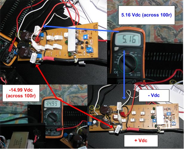

Hi All.. just back from my holiday.
3rd Attempt after replacing T7 (MJE340). VR1 and VR2 both turn to minimum position (counter clockwise).
Power Up with +-56Vdc (shows on voltmeter) and getting 5.16 Vdc on Neg Rail side and -14.99 on Pos Rail side both measurement taken across 100r safety resistor. Then below 1min, minor smoke coming up from T6 area only for few second. T7 seems to be ok!!! (is what I thought so).
All 4MJE's and FET already checked for contact with heatsink before power up.
100r at the Pos Rail side seems a little bit warmer compared with the one at the Neg Rail side. very frustrating...
Anything to suggest guys.... BDW how to check if either one of the 4 MJEs fail? Or Is still save to continue power up and do the calibration?
Help Me...

Vivek,
Both your rail voltage is it balance (same reading between both rail to ground - with only +/- difference)?
Found 1 big mistake where T8 was mounted on the top side of the pcb. Will correct the error soon if the T8 still ok. Is this causing the unbalance voltage between rail?

Volks
"Experience the same" means T8 wrongly place at the top of the pcb? I've already corrected my T8 position to the bottom of the pcb and locate the T8 at the main heatsink.. (current heatsink definately can't stand the heat-to small-fin type with fan) will change to bigger size once the NMOS module running fine.
Mine using 0.47 Ohms..BDW after power-up with T8 corrected still getting unbalance voltage between both rails to Gnd i.e. - 16.3 Vdc at (Neg Rail) and + 5.05 Vdc (Pos Rail). No idea where's to check next... should I adjust VR2 - any suggestion?
