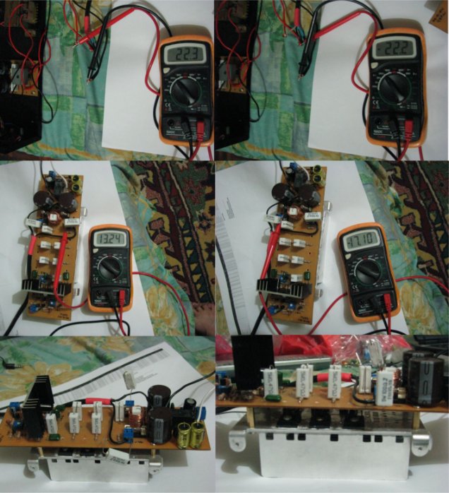

jethari said:Satcure
If you're getting 17.1V and 13.2V across the resistors, there is something wrong.
Firstly the voltage across both the resistors should be the same unless the resistor values are different. Measure the resistor values accurately.
Secondly, if the resistor values are correct, you still have a problem. The current is too high - 132 or 171 ma. This is way too high even for a three pair config. I hope you've not got the speaker connected to the output while measuring. While setting up the bias, the input should be shorted and the output must be open
Lastly, try using a higher voltage supply - around +/- 40V DC to get a more realistic picture.

if your supply is 22Vdc and the drop across the fuse holder is 13Vdc, then that part of the circuit is powered by just 9Vdc instead of 50Vdc.
You must turn down the bias to zero and recheck the quiescent currents.
Then reduce the resistors to 10r and start turning up the bias. If the output offset is still OK then replace the test resistors with 1r0 and do your final setting up.

Thanks...a few more question before i blow up my amp...hehehe
What about the differential between both rail voltage to Gnd..i.e 13.24Vdc & -17.10Vdc anything that i can do? Already measured both resistor and it shows correct value at 100Ohm.
Anyway will used 10r as suggested by but just in-case there are still different voltage reading between both rail to Gnd voltage reading...what should I check next if both 10r is ok?
For your info..Last measurement was done with "open input terminal" not closed or shorted as suggested. Will try soon (morning).
Hello Satcure645
The amp is not designed to work at such low voltages even though it probably will as you have discovered.
You must though replace R6 with a link so that the constant current source transistor T4 has sufficient voltage across it. When you build your larger power supply, remember to put it back (use the table on my web site as a guide).
With no input or output connected set the amp up as AndrewT has suggested, although I would not bother with the 1 ohm resistors if the 10 ohm voltages check out ok. Check to see that the ouput voltage at idle (output offset voltage) is under 10mV.
Refer to the setup section contained in the construction guide also found on my web site.

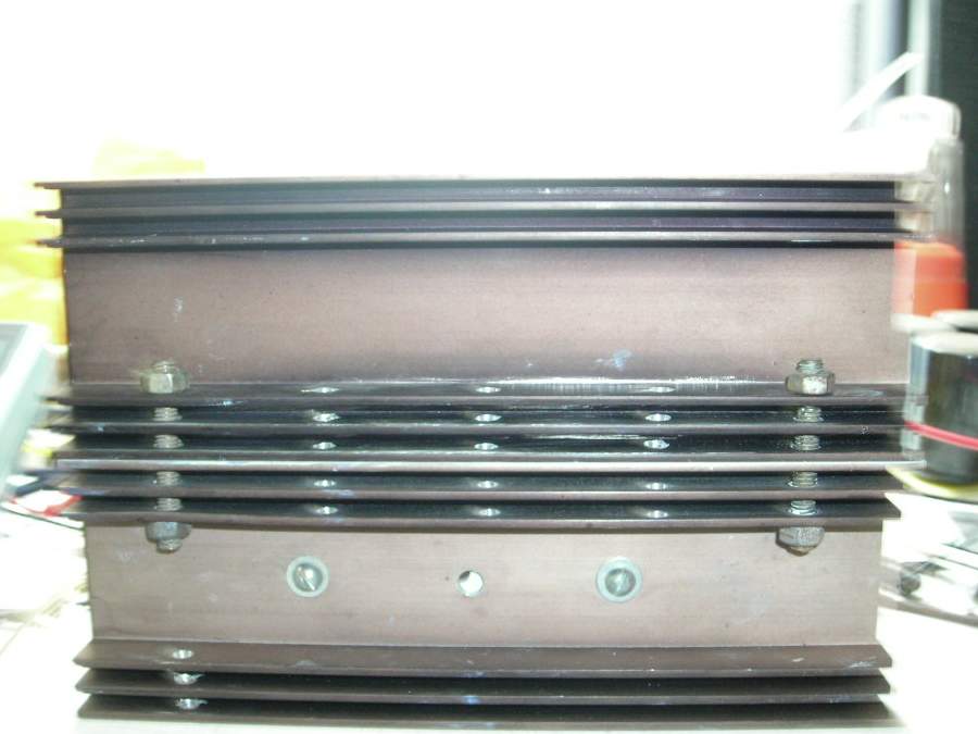

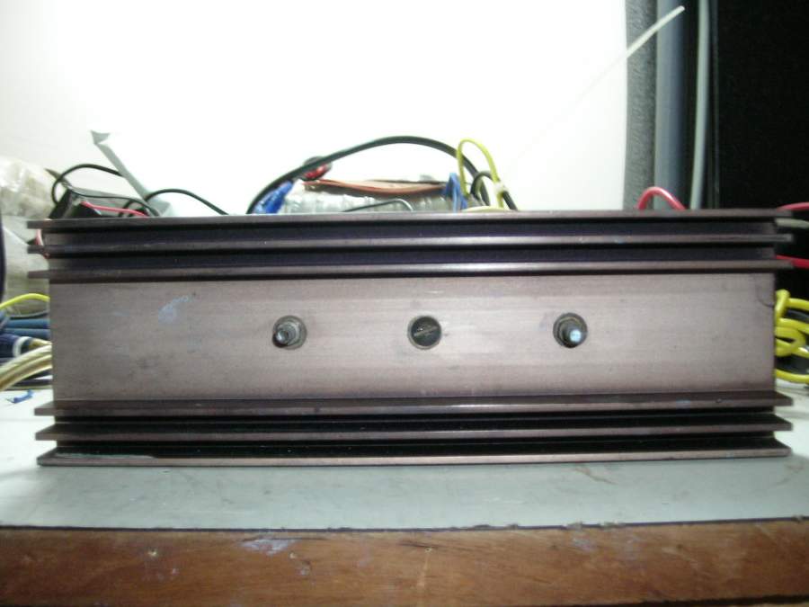

John
I think in all probabilities it was a problem of ineffective heat transfer. With the mating surfaces properly polished and the "right" amount of heat sink compound applied, the heat sink has started absorbing the heat. I've been testing the module with the ipod and speaker the whole day today. Though the mosfets are getting hot it is quickly being dissipated into the heat sink. I've driven it quite hard without blowing the mosfets 😀 Apparently the temperature on the plastic part of the case is not very indicative of the junction temperatures.
I'll still go for the light bulb experiment to look for oscillations. In my past experiments with amps, whenever there were ground loop problems it used to result in an audible hum or a buzz from the speaker. This hum or buzz would remain irrespective of the presence or absence of input signal. All the same I'll check it out.
Any comments on the size of the heatsink I'm using? Is it adequate for a two pair version running +/- 65V?

Hi Hari,
Excellent your heatsinks are now "heatsinking". I think your prior noted observations that the MOSFETs were getting warm/hot, but the heatsink was cold was the telling element of the possible cause. I do not have alot of experience with such matters so I was unsure if oscillations might cause localized MOSFETs heating or that even when the thermal interfaces were corrected if there was still some other underlying problems.
The light bulb test at best might uncover some grounding based issues. While it is true you can often hear oscillations many builders for other projects, besides the couple that have had such problems with their build of this project, have had oscillation issues that do not manifest as a hum or buzz noise. Another manifestation can be in terms of muddy sound quality, distortion and/or "unexplained" clipping.
The "L" bracket you are using for the PCB/MOSFETs to main heatsink is great as it has lots of surface area to distribute the heat onto the main heatsink. The main heatsink is hard to see from the pic you posted in terms of fin pattern/area. I would say the main heatsink is on the small side if the amp is pushed moderately for any length of time. If you need to stay with that dimensioning of heatsink for a long time I would look into finding a thermal cutoff you can mount on the main heatsink that would cut off the PSU if the temperature goes above 60C. Then you can use the smaller heatsink and have the protection of the thermal cutoff just in case something goes wrong or the input signal is accidentally set too high.
As a side note, once you are happy your PCB is stable and has no errors (one PCB error in the quasi version slipped by for about 2 years before it was discovered by a builder) I like to et a copy of the PCB images and the Protel schematic/PCBs so I can modify the PCBs. I assume you will add the capacitor across T8 that was missing from the schematic you based your PCB on. There is also a few other components that are optional I like to add. I like a pair of onboard filter capacitors rather than single one, splitting the supply rails, and some of the capacitors I have sourced are different sizes, all be it larger in most cases, but at the "right" surplus price and excellent quality. I would like to see if using a copy of Protel that I may be able to find will make that process easier and less time consuming then the current method I use of modifying the PCB image with a graphics program. I am in no hurry at moment for the files, but I made single pair and two pair versions of the "classic" quasi PCB layout as in most cases I for my needs I do not forsee needing more than one or two pairs of output devices. The difference with the NMOS200 layout quasi came out with which you modeled your PCB to for a NMSO350 version is the ability to stack the PCBs to a heatsink. I like the choice of both options which may give me more case and heatsink options for any related surplus hardware I may be able to still find.
John
the main heat sink is 8"X2.75"X0.75". Here is a clearer pic of the same.
Hari

Hi Hari,
I'm also very glad to hear it worked out as expected.
This goes to show what a difference heat transfer between junctions - and the right application of thermal grease - can make. Great! 😉
Quite honestly, I don't think so! 🙂
Sebastian.

sek
Take a look at this arrangement. I stacked two of them together. I tested it for quite some time at quite high levels, feels much better now.
Hari
