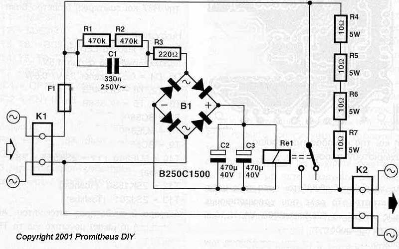

You can use this schematic for soft start...
POZDRAV😉
