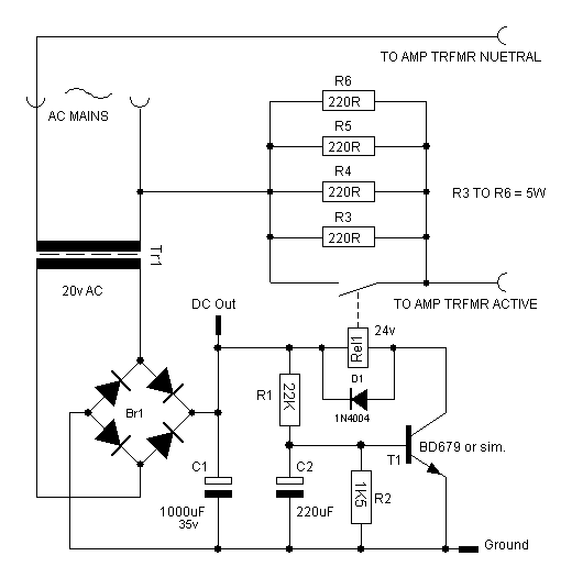

The slow turn on schematic has a small error. It's missing a diode across the relay coil. This has been corrected in the schematic below. The diode is shown on the PCB overlay.
Cheers

Elso Kwak
Your post is quite detailed so I guess you may have concerns about;
- the slowness of contact closure because of the charge cct on the transistor base
or
- You don't like relays and maybe I should use a triac instead.
In practice the slowness of the contact closure does not seem to be a problem as the amps power supply is sufficiently charged when the contacts close, so the current through the contacts is lower. On power off the relay releases fairly quickly. I wondered about using a trigger to snap the relay in though...maybe one day.
I could use a triac based cct but I chose not to. No real reason apart from simplicity maybe. The relay cct has been in operation in an amp I built about 15 years without problems so far.
Cheers
Goodness me...
I am so embarrassed....It is of course spelt Neutral. English is not my native tongue ....but even so. I hope I spelt embarrassed correctly.....do I correct the cct and layouts?
I'm starting to shake ...what to do....the pain...please someone make it stop..!
I guess the 24v relays down under here are much the same as the ones up there.....or at least I think so.
.....still shaking .... :cannotbe:
quasi said:
Elso Kwak
or
Cheers
Hi thx for the compliment!
I simply hate ralays in the signal path. I had speakerprotection relays that spoiled a demonstration of my crossover filters as they distorted, yes after 20 years, OK. I also had speakerelays in the amp, they also started to distort.. so...
AC relay
richie00boy said:
I agree with quasi, the circuit is fine in real life. Elso can talk when he posted the following circuit which I cannot even get to delay 🙄
Hi richie, That circuit is not a speaker relay but a delayed power on circuit to limit rush in current. The relay is an AC type, working on 230V AC. It's all original part of a Gas Ampzilla II power amplifier.
Hope this helps!🙄
When designing a slow start like this, I use the secondary DC voltage and a DC relay. If the outputs or rectifier short, the voltage collapses and the relay drops out. This causes the resistor to open and limits other damage
-Chris
-Chris
Yes this is a good one and a local friend uses it too. Sometimes though if the pre-amp is turned up and then the power amp is turned on, the power supply doesn't come up to enough voltage .....goodnight resistors. This could be resolved by using higher power resistors.
But as you say it does provide protection against faulty modules, short cct output etc. and would work well in intergrated units where the pre-amp can be controlled.
Cheers
