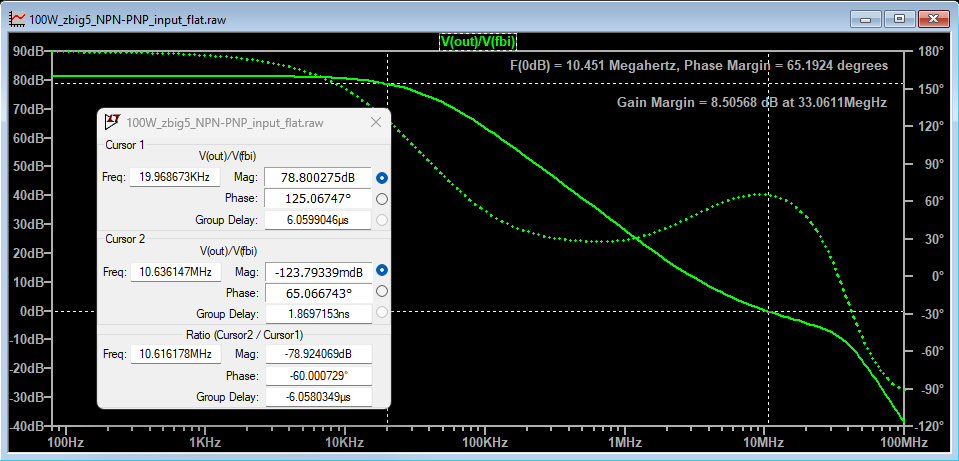

115dB maximum open loop gain (with feedback network, amplifier alone has 147dB gain), first pole at 800Hz
111dB gain at 1kHz
92dB gain at 10kHz
Closed loop gain 32dB (40V/V)
Slew rate 47V/us
10MHz
unity gain, with phase margin 62 degree and amplitude margin 10dB

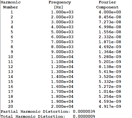

1W 1kHz THD=0,000007%
100W 1kHz THD=0.000035%

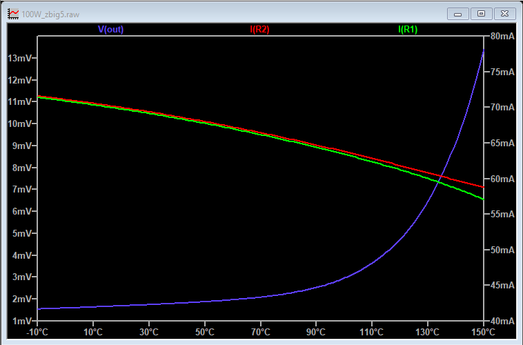

Thermal stability (-12% quiescent current at 150 degree Celsius)

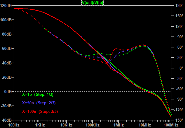

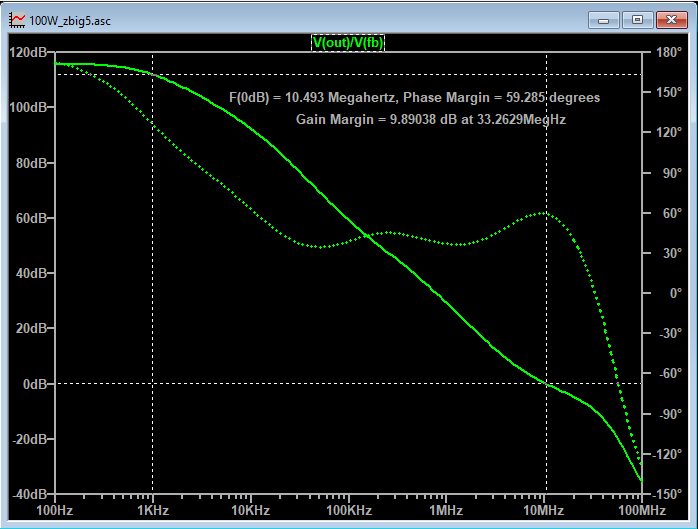

Phase-amplitude characteristics
And this same with capacitive load

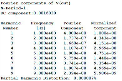

THD numbers for 1W 1kHz

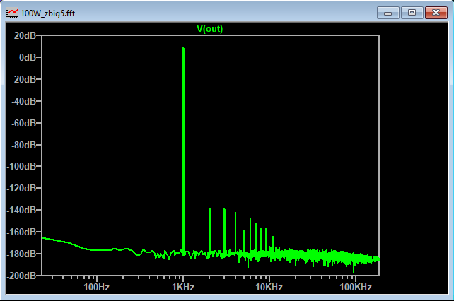

Fourier for 1kHz 1W

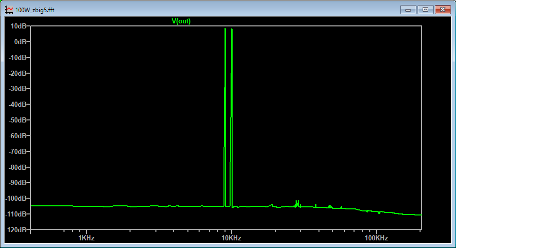

Intermodulation FFT (9kHz+10kHz 8Vpp out)

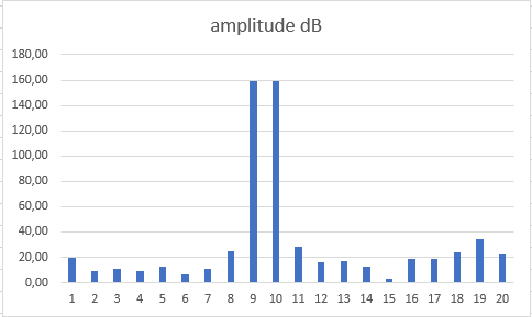

LTspice do not shows much, so I've put numbers to Excel and produce more legible graph (horizontally kilohertz, vertically dB)

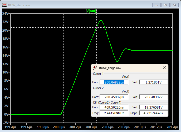

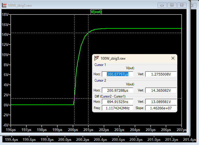

Step response with overdrive. As you see it lasts less than microsecond to stabilize output level
This same step but with input low pass filter (no overdrive with full power 10kHz square wave)

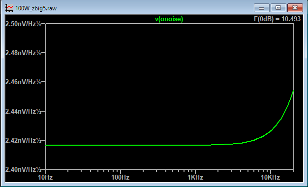

Noise figure
Thermal stability

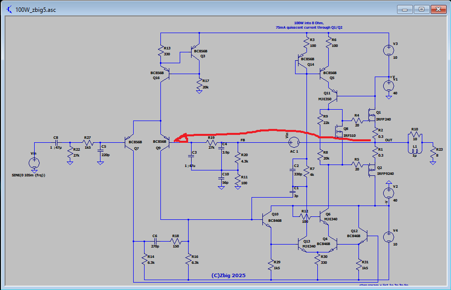

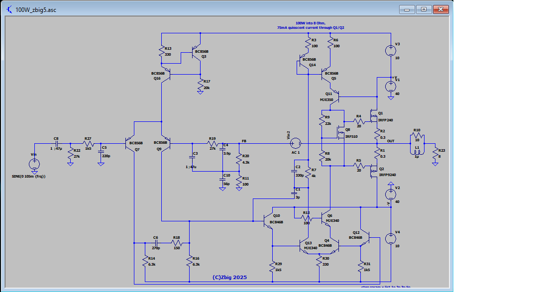

And finally schematics
This is not a final version, and some improvements should be done, e.g. increase clipping output voltage, and gate protection.

Yes, MTC compensation is simple and effective. But also with drawbacks. If you want to achieve high gain but stable at unity gain, you need to set first pole at very low frequency (due to -6dB/octave slope), which is counter-productive, because you still get low gain at medium frequency. Unless you'll build amplifier with very high bandwidth (but this is hard to achieve with high voltage/high current transistors, especially power ones).
My solution allows for steeper slope than -6dB/octave, and thus higher gain at mid frequencies.

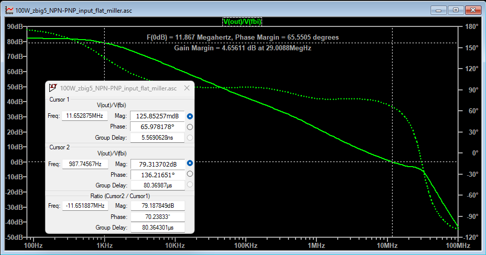

Compare these two graphs: This same amplifier with classic MTC,
and with ONLY my compensation method (no Miller at all)

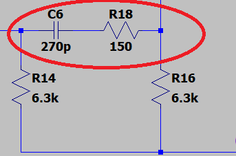

For TMC, you should probe the NFB around the output stage only, not for the entire amp.
You mean C1,C3,R4 - but this is not a classic TMC, and this as I suppose introduces also one zero. Btw. think about causes of this phase drop till 10 degree at 100kHz. It is not only TMC impact. Anyway it is interesting, although completely different. My solution do not use NFB.
Btw. I'm using modified Miller (similar, but different than yours) in my other design, which performs better than "classic" TMC
Anyway, this thread is not about how to use TMC but rather how to NOT use it ;-)

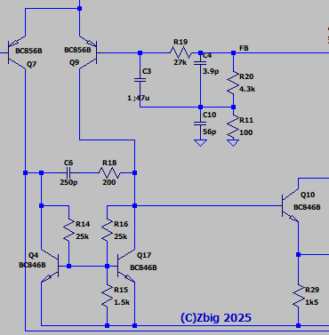

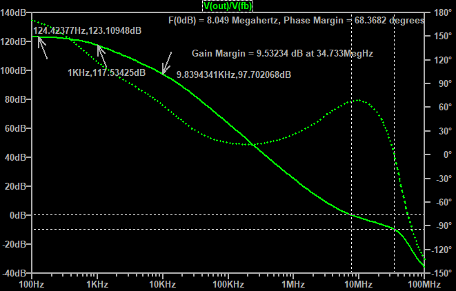

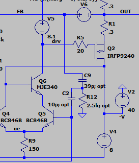

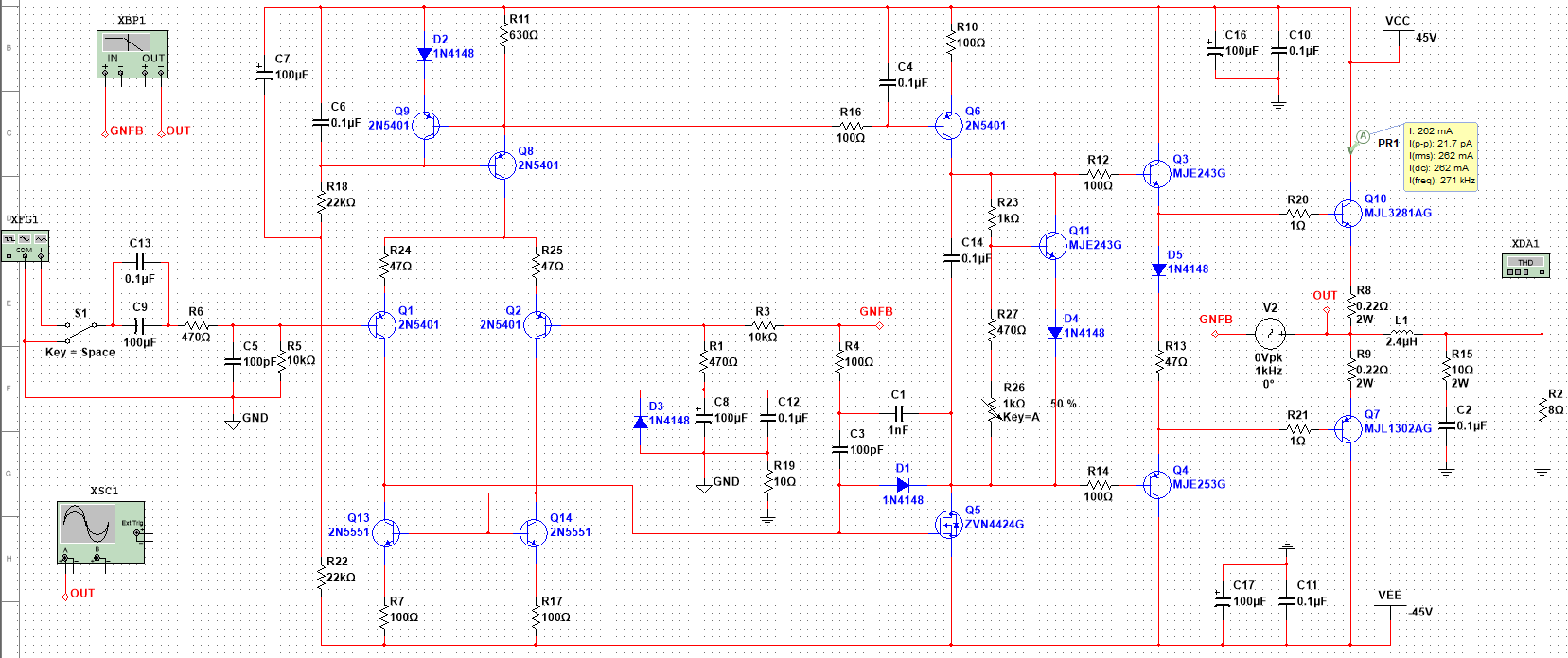

So let's try something else. Maybe this is fresh idea. Replacing resistors with active, balanced load we can increase open loop gain from 115dB into 124dB, and reduce THD more than twice.
And all this with this trick:
Why perfectly matched? The most unmatched transistors are already NMOS and PMOS on output stage. Without serious impact on amp characteristics.
Good idea may be to match input transistors by its gain, to minimize output offset, but rest of them do not need to be matched.
The idea of this type of compensation with a "phase boost" reminds me of Venerables excellent papers concerning switch mode power supply stabilisation using a type III compensation network. May be interesting, but new only in the audio world.
Ic = Is * exp (Vbe/Vt)
Q4 and Q17 have the same Vbe. Ic will vary with Is and temperature (which is part of Vt). Current mirrors need emitter resistors to reduce the sensitivity of Ic to Is and temperature.
Ed
Good to know you also know this formula.
The only current mirror on my schematics has emitter resistors, namely R3 and R6.
You mean Q13 not Q17.
Why Q4 and Q13 do not need to have this same Vbe?
Short answer is this: because they are not in input stage and amplifier has very high gain with strong NFB.
And as you can see on temperature graph I've posted earlier amplifier has very good temperature stability. And even two completely different transistors changes nothing.

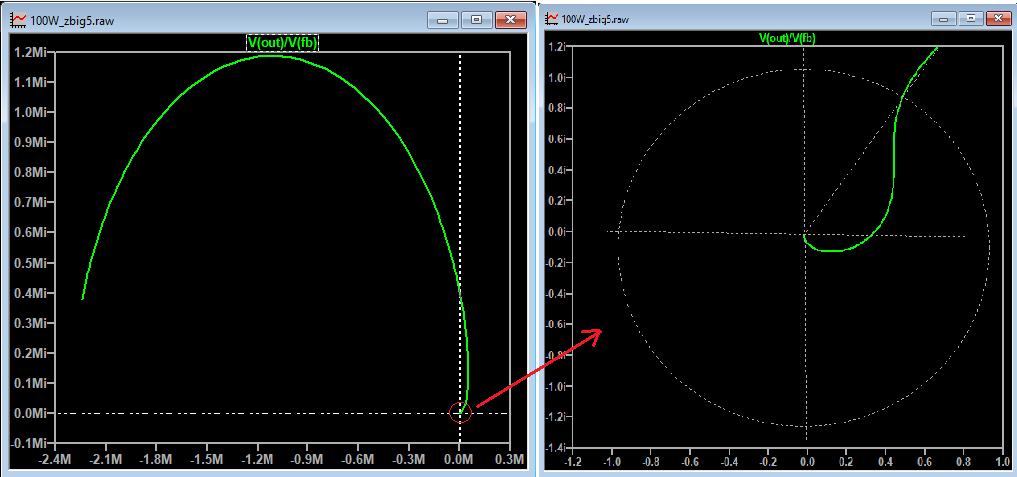

Interesting idea about modified Nyquist plot.
Especially our amplifiers have huge gain, and zooming Nyquist plot to reach unity circle level takes some time, and also requires manual drawing of this circle.
It is how Nyquist diagram looks for my amplifier. LTSpice should have option to do it automatically.
