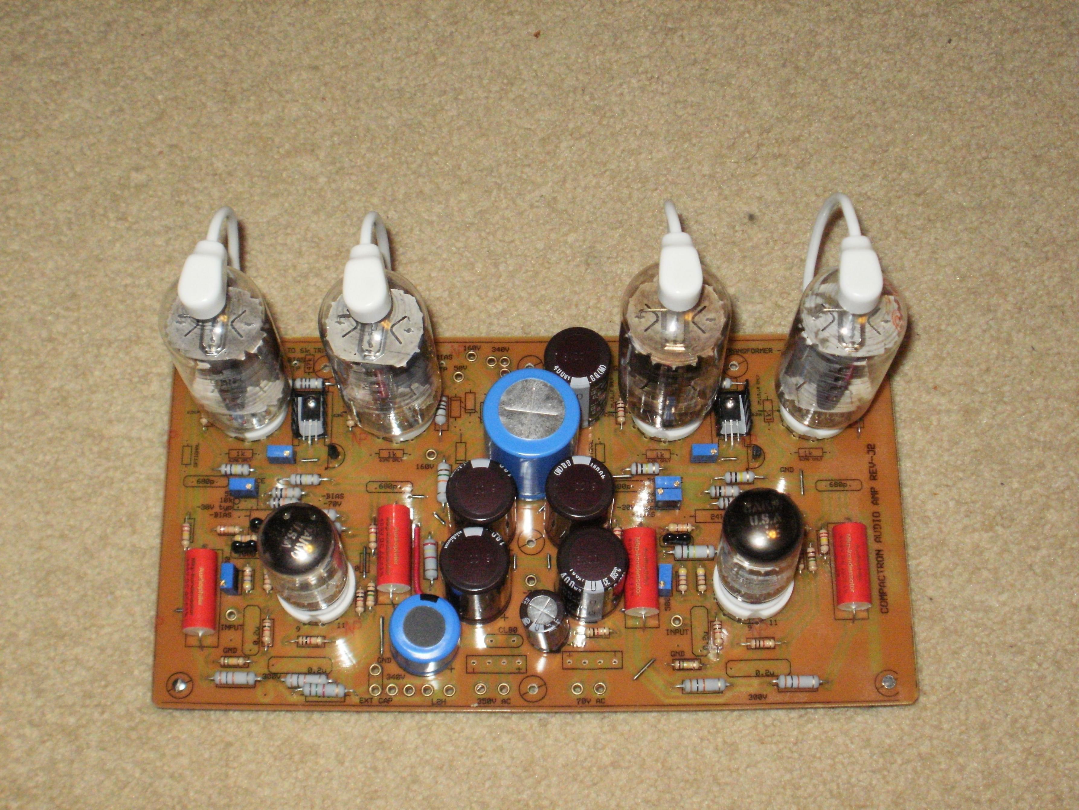

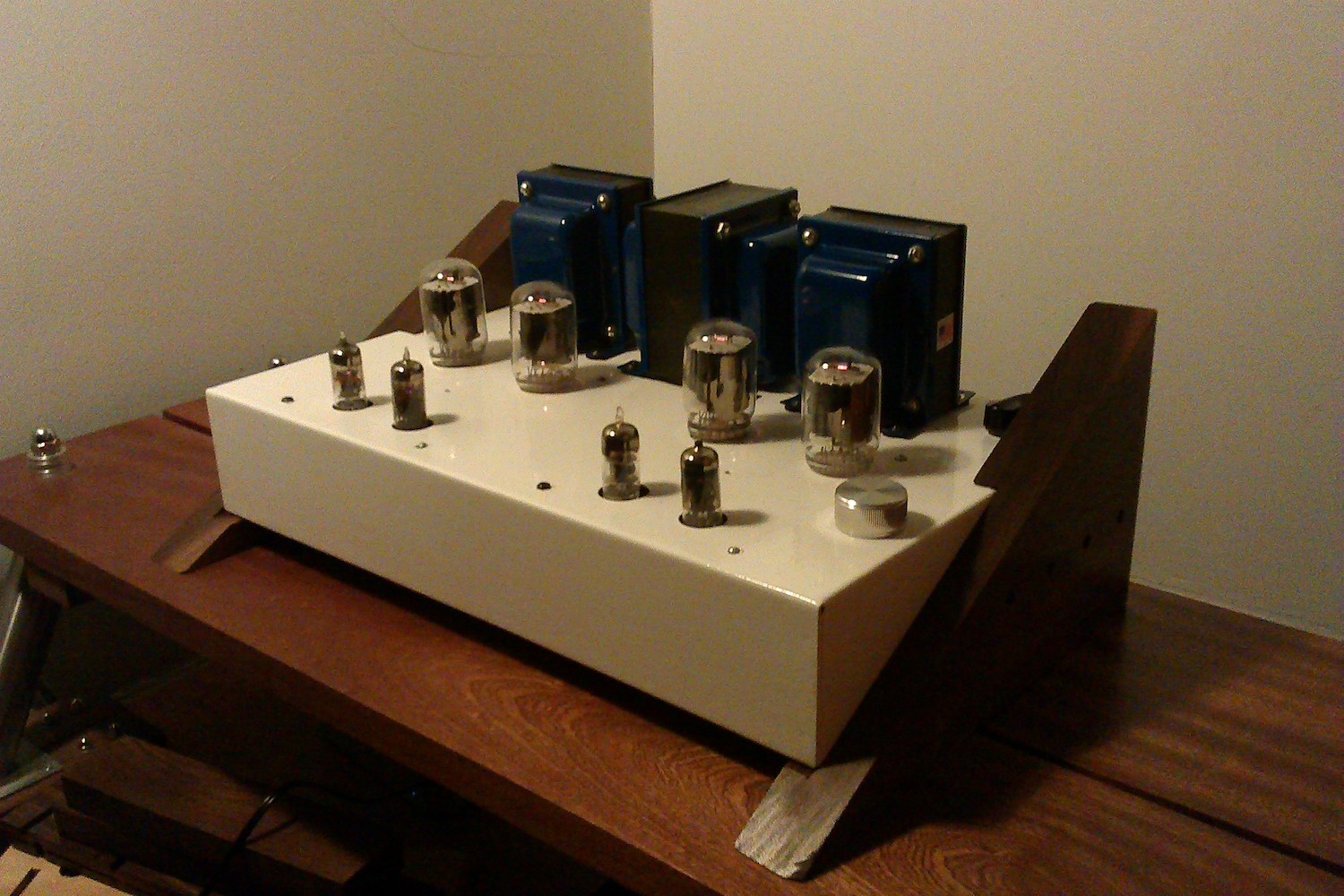

I finished my DCPP build a few weeks ago, and I've been enjoying the sounds coming from this amp! (Pictures below)
I've noticed a few things out-of-spec, though, and just wanted to see if anyone had any advice on how to get these numbers more in-line with what I'm seeing on the schematic.
First off, it's my first build so I've built it using 6JN6s, but everything else is pretty much straight from Pete's BOM, so nothing exotic is in play here. Iron is the standard Edcor set.
I balanced LB1/2 and RB1/2 to show 400mV. I don't have any distortion measuring equipment, so I've largely set DBAL by ear. B+ is 325V, and the screen voltage (measured at R42) is 150V.
With all of this set I'm seeing about 130V on TP11 & TP9, BUT about 185V on TP12 & 10. The schematic shows that this is supposed to be about 130V.
As well, the power transformer seems to be running a bit hot. I've had it on for a couple hours now and I can put my hand on it for about 2-3 seconds before it becomes uncomfortable.
So basically everything seems to be working well, except for a moderately high voltage on TP10 & 12 and a warm PT.
Any clues? Thanks.

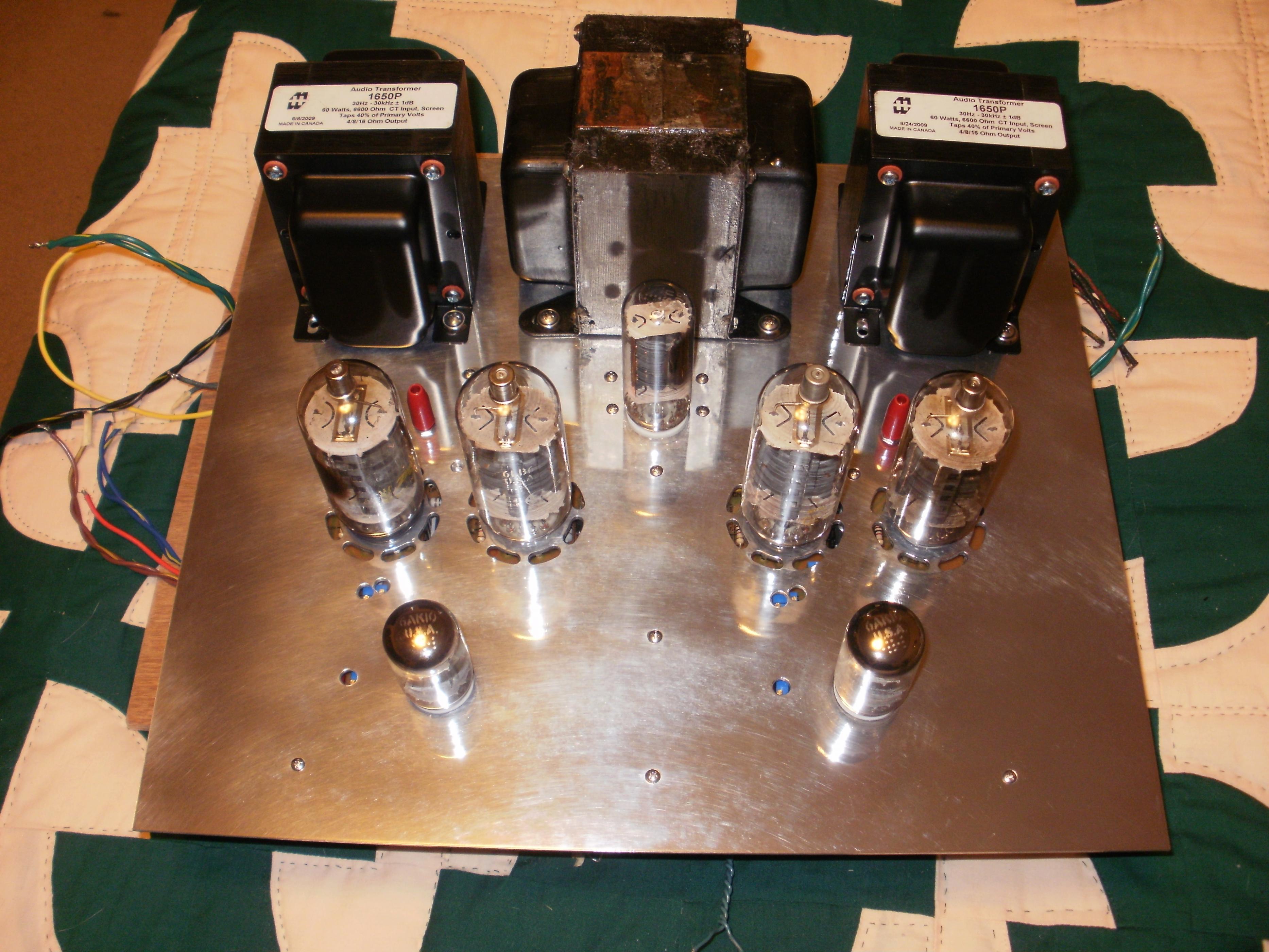

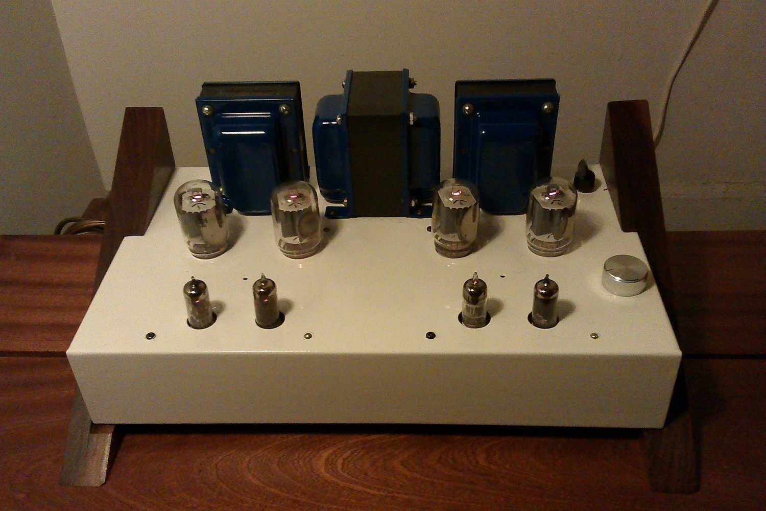

I've been building my own designs based on PCB design and fabrication. If you want 50-60 watts/channel, ensure power supply, 60 watt output iron, use the larger plate sweep tubes e.g. 6lb6 ...........
I prefer the 6.6kraa for lower distortion without feedback. 4.3k raa can be used with feedback.
My 40watt/channel sweep tube amps are more than adequate for the 89db efficient 4 ohm speakers in the listening room.

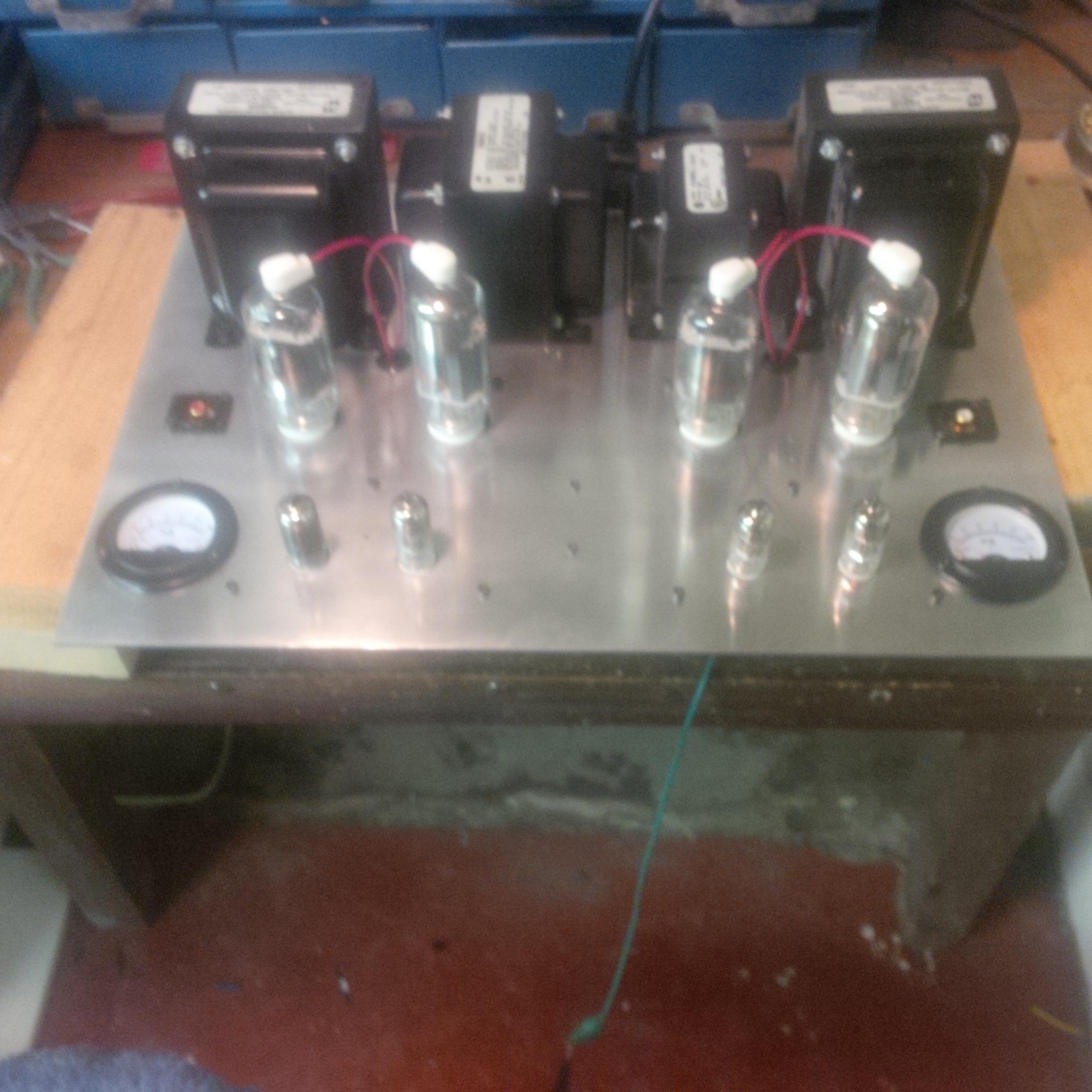

Just set up another red board and cannot say enough about the quality and ease to make this bad boy work. Just to make it look great I put a couple of amp gauges on it but I am unsure where to connect them. I could connect them with a three way toggle to set each of the parameters but again Pete asks for measurements in millivolts and I am unsure how to attach them for milliamps. Hope my build looks good. I will break it in and then put it in the mahogany case after I figure out how much airflow it will need.

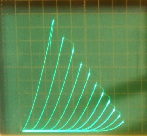

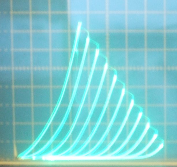

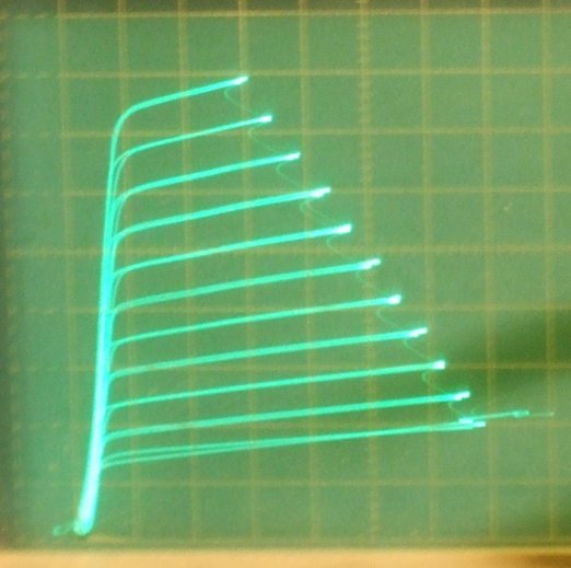

I have been running 42kn6 in many amps for over 20 years. They are the ultimate power tube. Period. In push pull they easily do 150 watts. The cathode is capable of delivering so much current that one doesn't have to bother with taps on the secondary. They are like transistors. Then the enhanced triode circuit came out and that sealed the deal.
I have stuffed 6KN6's into Petes red board. They do kick butt, but "ultimate. Period" maybe not....it's all about what you are trying to achieve. I will still call the 6LW6 the ultimate sweep tube.
Note, that there are two totally different tubes called "KN6.
One is a typical big sweep tube with a single structure inside. They work well in both audio and RF amplifiers, hence are somewhat scarce and expensive.
The other has TWO smallish sweep tube guts inside a common envelope, wired in parallel. These do NOT work well in RF amps, and if the seller understands this, can often be had for a reasonable price. These will actually support higher peak cathode currents than the single plate variety, but can dissipate lower overall power since the area between the plates can not shed its heat leading to hot spots. Many of the Sylvanias produced near the end of the vacuum tube area also have alignment problems, also causing hot spots at high average dissipations.
I have some of both, and each will easily make 150 WPC in this amp, but a good set of the twin plate variety sounds better to me on highly dynamic music played loudly through big speakers.
