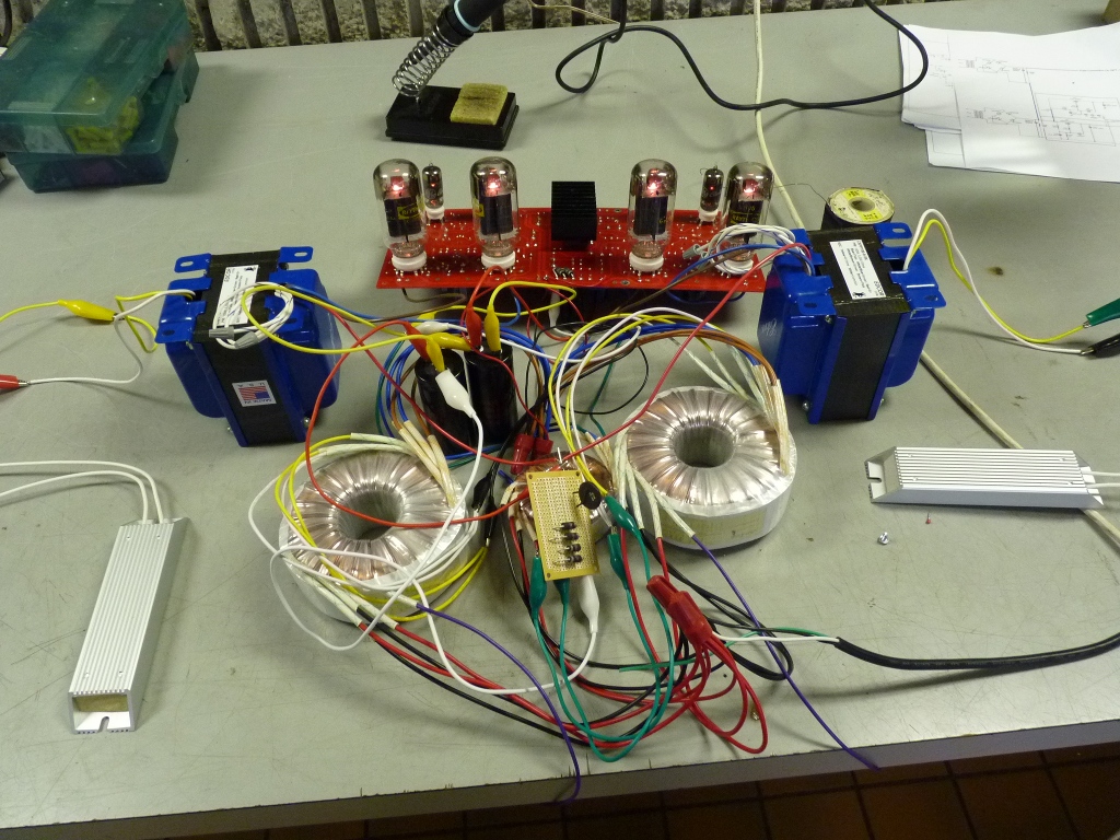

I finally got around to powering up my red board using 2 Antek 230V transformers in series for the 600V B+ to 6HJ5s. I used an Antek 40V for the bias supply. I used dummy loads instead of speakers for the first power-up.
I measured 640V for the 6HJ5s, 325V for the main board B+, -55V bias supply, and 145V for the screen. I was able to adjust the bias fairly close as an initial adjustment. Tomorrow I suppose I'll hook up the speakers and run a signal through it.
I used a CL90 after the bridge and before the 500uF filter cap on the upper power supply. How hot do these run normally? I left everything powered up for about 30 minutes and the CL90 is a little hot. I can hold it between my thumb and index finger for about 2 - 3 seconds before I'm tempted to let go.
That's about right. Those devices rely on heat to work. Their resistance goes down as they heat up. Remove the heat and the resistance goes back up. You can see this with an ohmmeter and a heat gun.
Ya my CL's run HOT. Alot of people put a piece of shrink wrap on them so they dont dance with the load. I also keep them as far away from anything to give them some air flow. I put mine on the mains though. It would be a breaker popper if you put the CL after a 500va torroid.

I just finished hooking the amp up to speakers and a source.
WOW! This thing is LOUD and CLEAR! Sounds very good. No noise that I can tell. I measure about 18VAC music program across the speaker terminals with it cranked up pretty darn loud. I don't want to really crank it up until I get the distortion levels set properly.
So far all voltages look good and no smoke. The CL90 doesn't really seem much hotter even under load. The 6HJ5s get pretty hot though!
