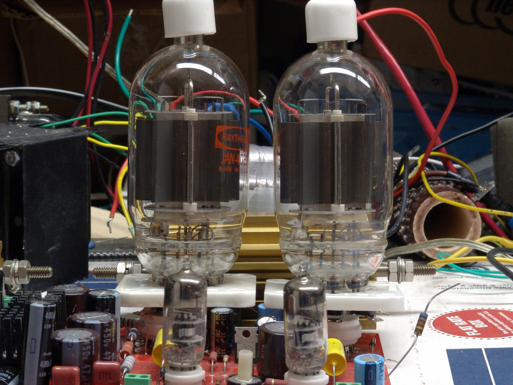

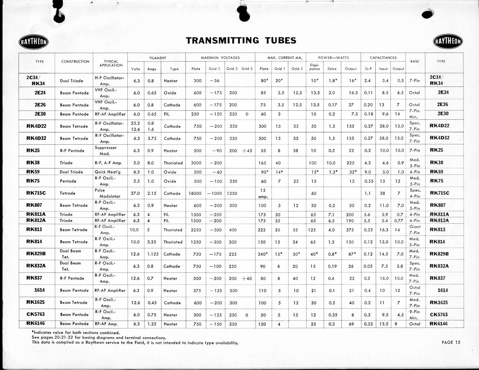

awsome George, i am eager to find out the results for those 4D32's.....i believe these babies are better than kt-120's...
YOU were the one that convinced me. Of course the 10% off coupon that Ebay sent me had one day left before it expired, so I got 6 of them. 2 were gassy (the ones in the picture). The seller sent 2 new tubes. One lights up purple. I have already tested them in a SSE.
I will see what they do in the red board soon, but I have heard that they like AB2, so they will be tested again later with a mosfet driver board.
Equal time will be given to little tubes too, and even some DHP's (307A / VT225)
I didn't show all of the Les Paul's headstock for a reason. It has the word EPIPHONE on it! I have always used rather cheap guitars. I don't play so well any more, so I can't justify spending much money on a guitar. However my wife bought me this guitar for a birthday present about 12 or 13 years ago. It cost almost $600! My daughter still lived at home and she was the drum captain in the high school marching band. There were always band kids over at our house armed with musical weapons. She got me the Les Paul so I could jam with them. Everyone had a Strat including me, so I had to be different. Of course mine was the cheapest, a Mexican Squire I got at Sam Ash for $99.
The Les Paul is the best guitar that I have, and the only one that I haven't taken apart and modded. I have an old Guild "Ultraflex" amp from the 60's that makes a real sweet blues sound with the Les Paul. Very unique amp, one preamp, two power amps each feeding its own speaker. One is an 8 inch, and the other a 12 or 15 (don't remember). The Ultraflex knob sets the blend between the two power amps. I haven't played it in a few years since I don't have room for it right now.
Not to hijack the thread too bad...nothing wrong at all with an Epiphone Les Paul unless it's like the gold top I had in '73, it was the feedback king and I never fixed it. Now I play a 1998 G&L Legacy, and a blond 1980 something G30 Guild acoustic.
thanks George, the 3% distortion figure quoted for classAB2 is simply too hard to ignore....
i am using a voltage doubler plate supply so that i can easily provide lower voltages for the screens...
i am waiting on how hard you can push these tubes.....i think with the largish plates, more power can be attained.....i await with bated breath....😀😀
The plate size determines how much power the tube can dissipate. The cathode size determines the peak emission capability, which determines how load the load impedance can go before distortion, or worse happens. The maximum plate voltage determines how high the load impedance can go before possible sparks happen. The dissipation and the efficiency of the amp determine max power if everything is working right.
The cathode size in the 4D32 is smaller than the big sweep tubes that I have been using and the maximum plate voltage spec is 600 volts, so the 125 WPC number might be a real limitation if the specs are real. I will find out how far things can be bent, within reason. Even with the discount, these were $20 tubes. I have some $4 sweep tubes that can do 200+ WPC ,so......
