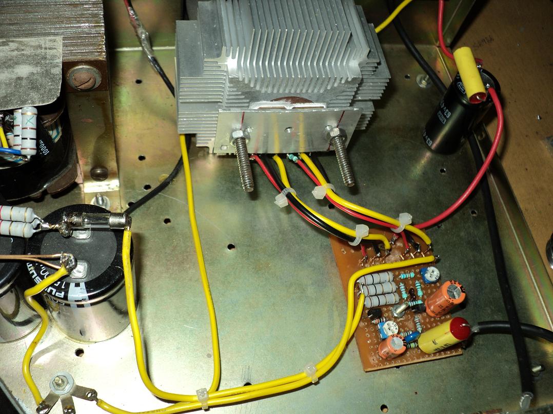

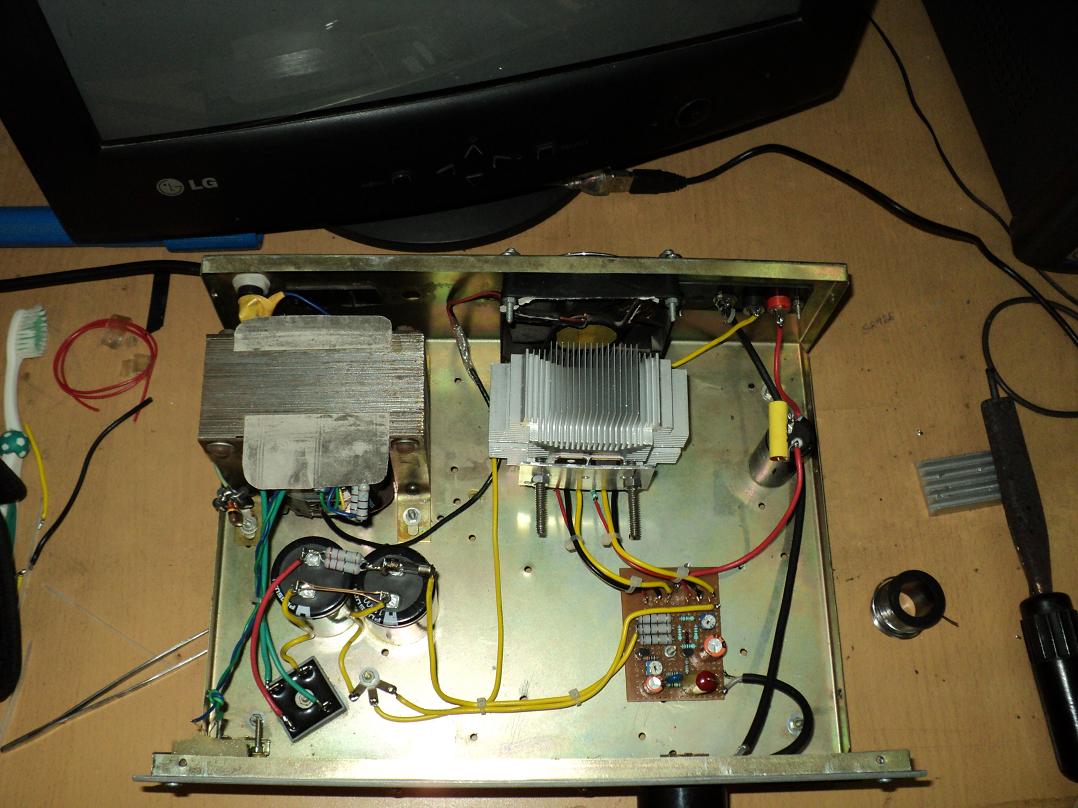

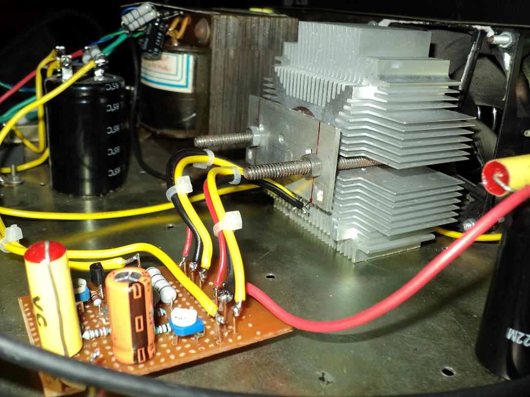

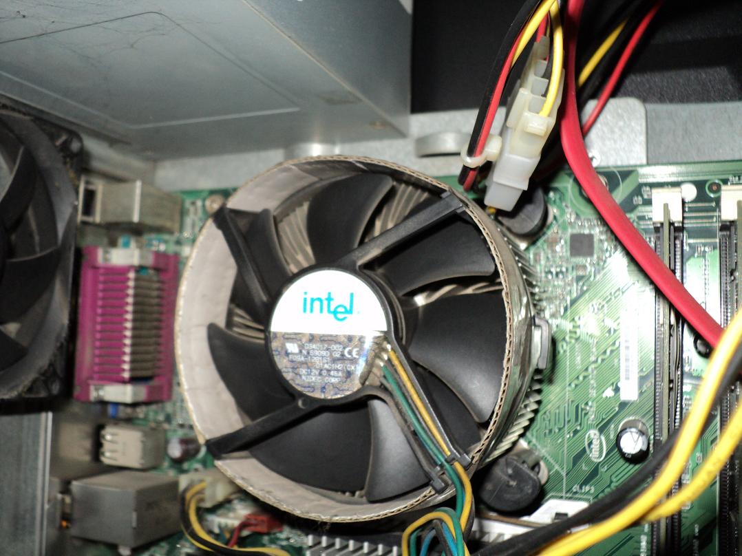

First try on LatFET and CPU HS

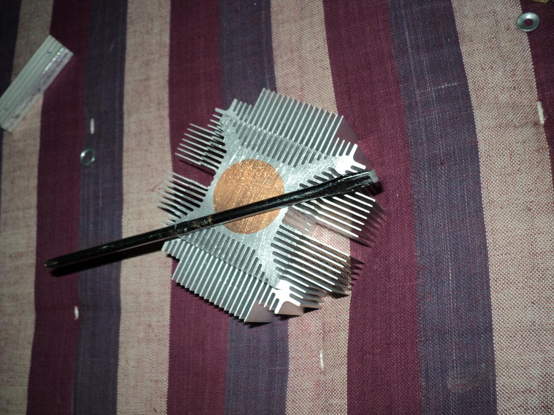

First time making a Lateral FET SE Class-A amp and also first time using a CPU heatsink. Dissipating about 90watts the heatsink seems ok for this monoblock. Plan to make another one like this soon for a stereo setup. The circuit is a combination of Zen and Death of Zen using an N channel FET for the power device and a PNP power darlington as the nonmodulated constant current source. The heatsink is probably an AMD one. Had to cut four of the radiator fins for the mounting bolts.

well, your PC heatsinks could make a very different design
with the copper plug in the middle, definately interesting
but I suppose not the cheapest either ?
I dont know how effective they are
but without a fan, I reckon a standard F5 would need one heatsink for each device
just to have a figure 😀

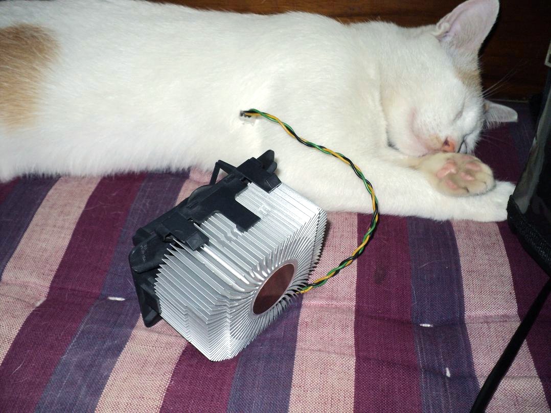

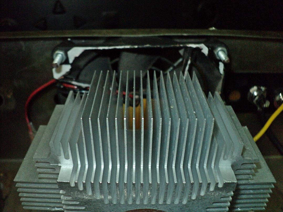

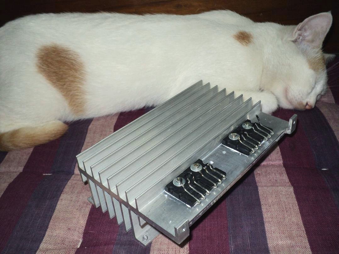

For me it was the cheapest heatsink for the performance. Bought it from the used items market here in Kolkata for just Rupees 100(~$2.5). The copper plug is the main attarction as you said. Performance wise this heatsink runs a lot cooler at half the fan speed than the older and larger heatsink I previously used with fan at full speed and more noise(first pic below). I still have another intel cpu cooler and plan to use it for the other channel(second pic). Fortunately this one has the fan intact which was not the case for the AMD hs.
From my experience these heatsinks must have a fan running at slow speed if used for dissipation of more than 10watts or so, as the thin gaps between the fins seems to make it hard for the hot air to escape fast. With a 12v fan running at 6V these heatsinks are unbeatable IMHO. And one heatsink per device would be an excellent or perhaps the perfect setup, provided there is good ventilation in the chassis.
(cat for scale 😀 )
shaan

So at what scale the cat is? I have seen really big cats out there 😀

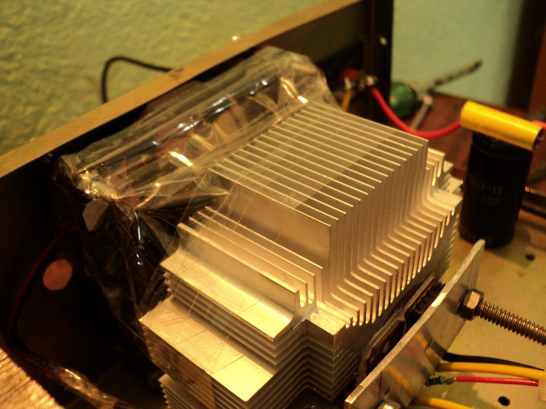

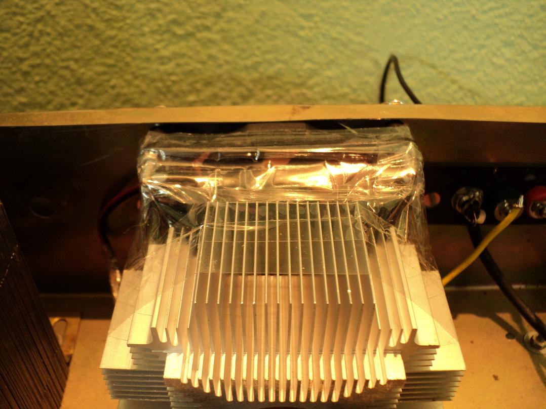

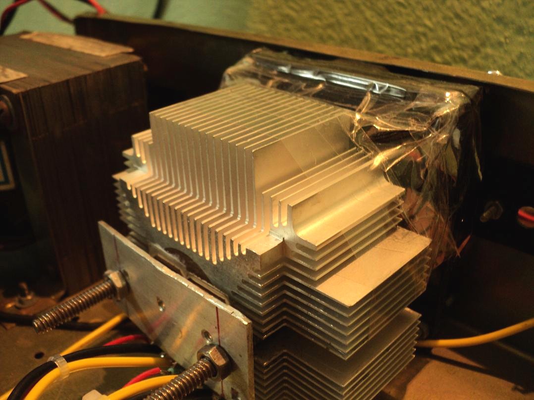

From my experience in silent pc contructions, with this kind of computer heatsinks and this case form factor, is it advisable to place some kind of conduct to guide airflow right through the fins. Just put two pieces of plastic of a size of approx 100x100 on both sides of the heatsink. Try it and you will be surprised of the lowly fan speed you can set without getting a hot heatsink temp.
you can adquire too a low noise fan, look in the previous link I gave from silent pc, in this section.
Regi
She's cute, big, annoyed and angry. 😀
Scale for scale. :rofl:
Regi
Using the same idea for two years. And yes you are right, it really works both low CPU temp and noise. Although I put the surroundings around the fan, not the sink.
shaan
