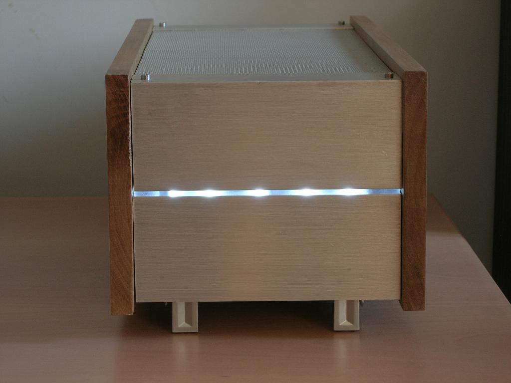

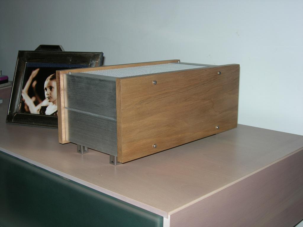

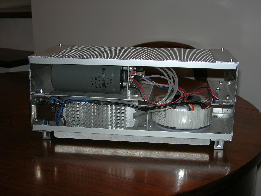

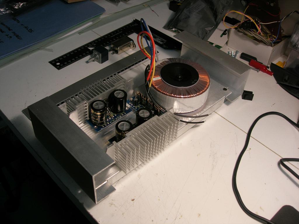

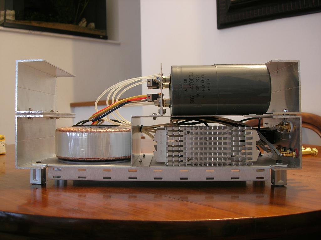

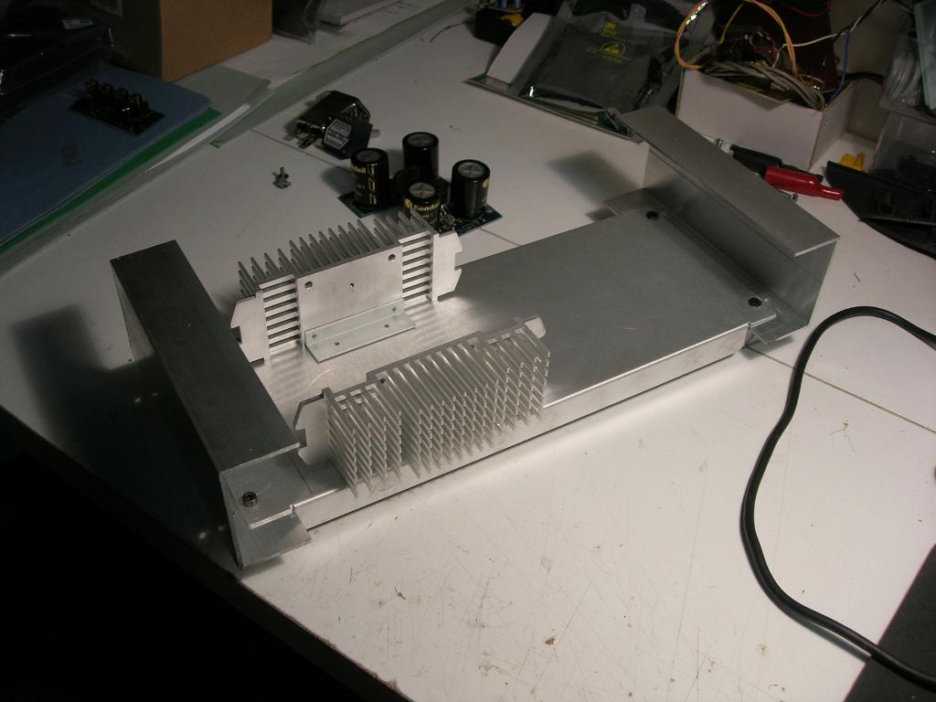

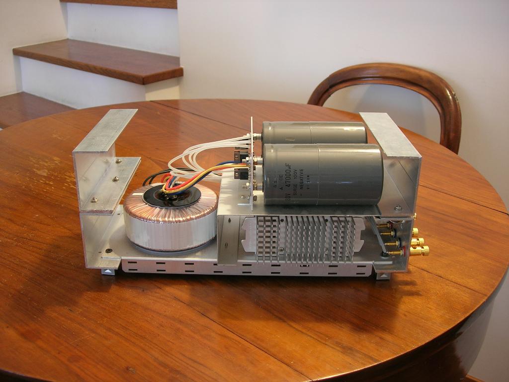

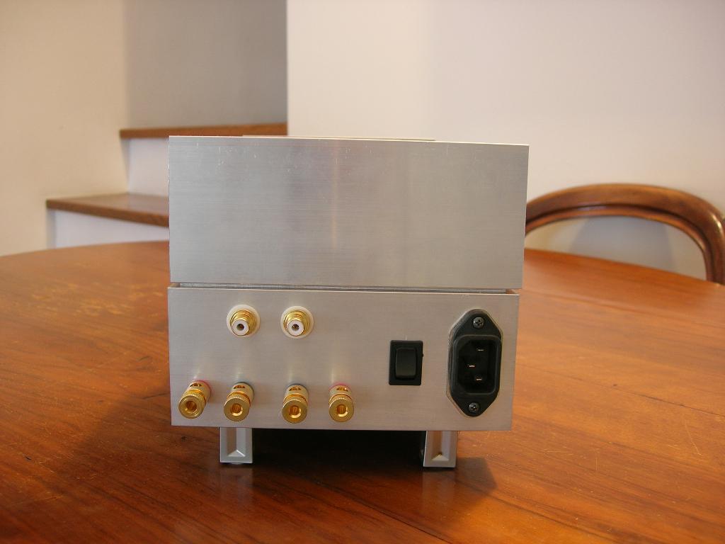

My work : Gainclone LM3875
Cool , nicest end result I've seen using standard hardware store stock and 2 P3 heatsinks.
OS
Epcos?
Nope.
The grey foil makes them appear as Mepco's, but the Triangle logo smells Taiwan.
Actually, I think that particular triangle logo was an old one for Matsushita (the parent company of Panasonic), making them a good brand, but rather old.

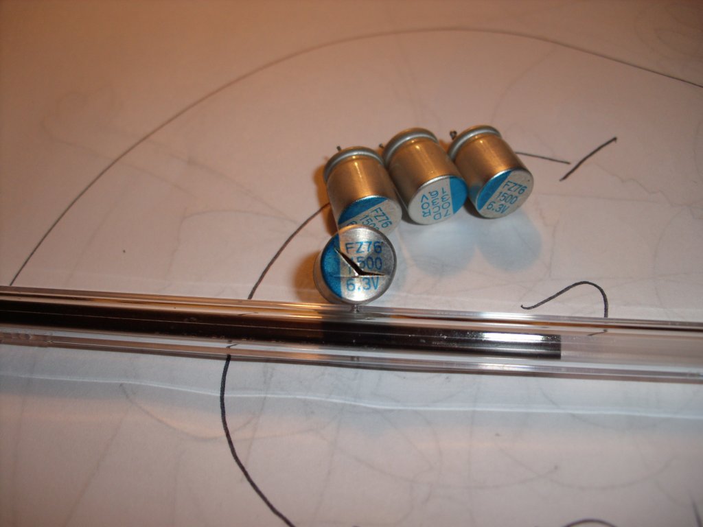

The japanese are in my opinion the elite manufacturers along with german products. VERY high quality , look at the FC and FM series electrolytic's , better than originals , good price. The chinese , on the other hand.. with their SACON junk caps are on my *@#* list. (below) EVERY EVGA motherboard and video card has these babies. 3 out of 4 in my house blew recently fixed them with panasonic FM's , but had to return RMA 57 customer cards and MB's.
I now research where these manufacturer's source their parts from , I just can't afford to RMA so many items... In DIY , watch out for chinese amp kits on ebay , in the pictures I see SACON and other no- name brands. If you must, buy new panasonic, or Nichicon (19 years old and still tests perfect on ESR meter) caps to replace in kit.
BTW , panasonic makes caps in taiwan but has more factories in Malaysia.
