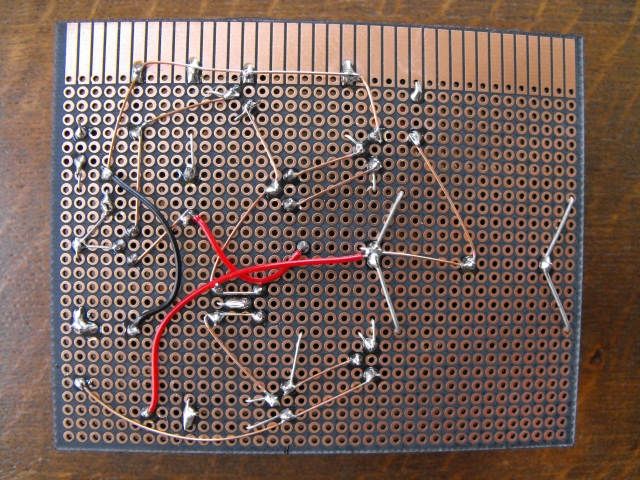

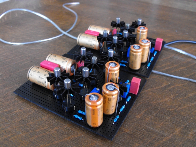

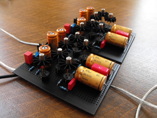

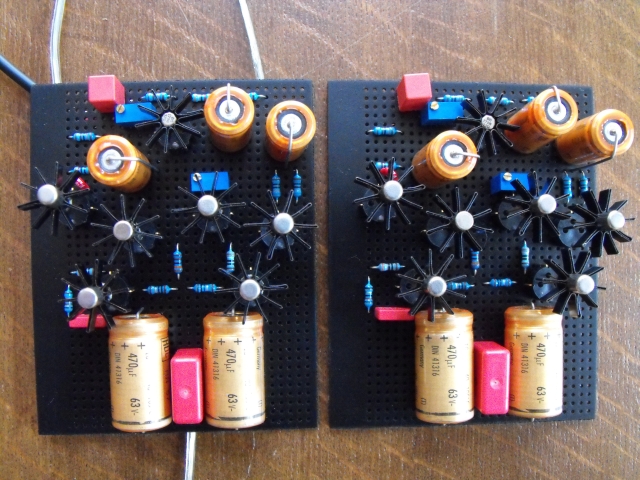

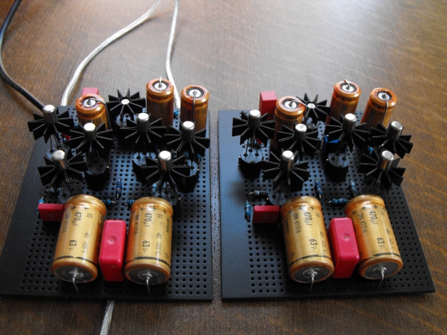

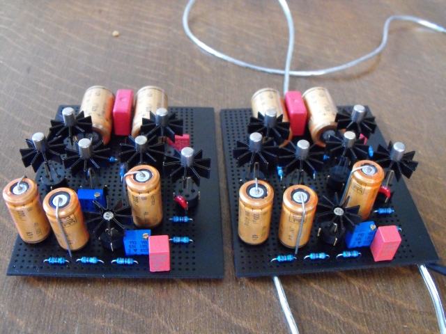

Germanium headphone amp

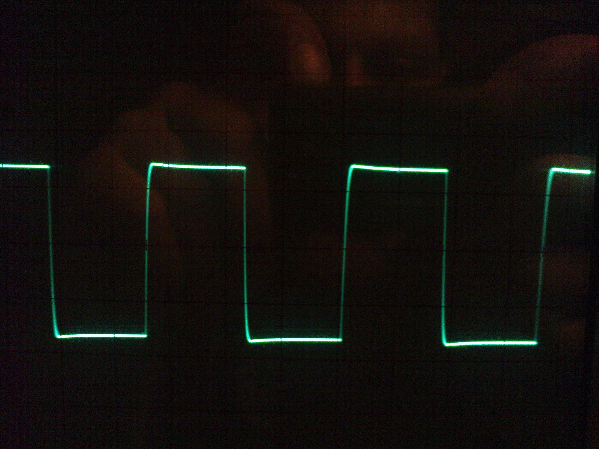

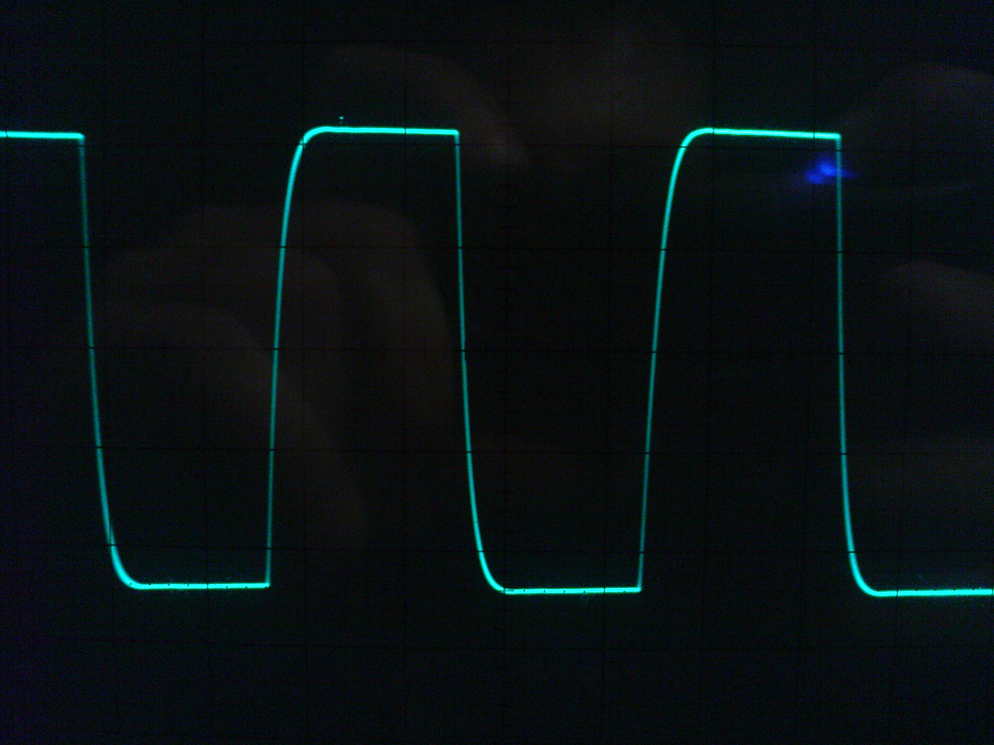

Just completed one channel of my new headphone amp and the second channel only needs to be tested and fine tuned, and then i am ready to build it into its housing.
This amp is based on the BC179B AC122 and AC187 transistors.
This project came to mind when i found these gold pin AC187 transistors for
80 Euro cents, and i had some matched gold pin BC179B transistors.
Then i mached the whole batch of 30 AC187 transistors for the highest Hfe and matched them according application in the circuit.
greets
greets

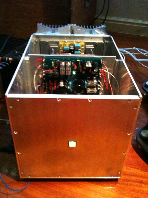

A Cavalli Audio eXStatA (Electrostat headphone amplifier) build in progress...waiting for some parts so I can finish up the input wiring.

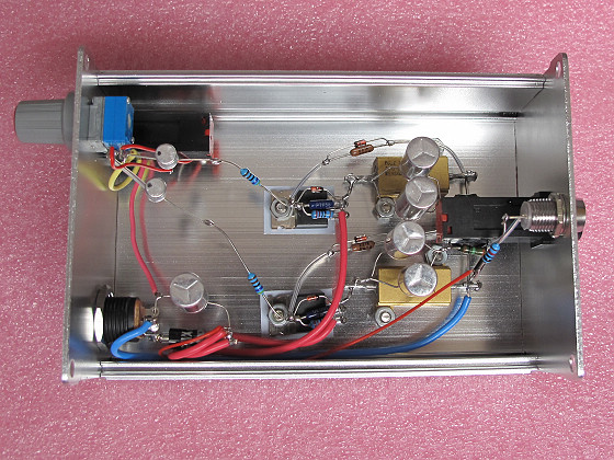

single mosfet buffer,p2p building.
as always digi, very nice!

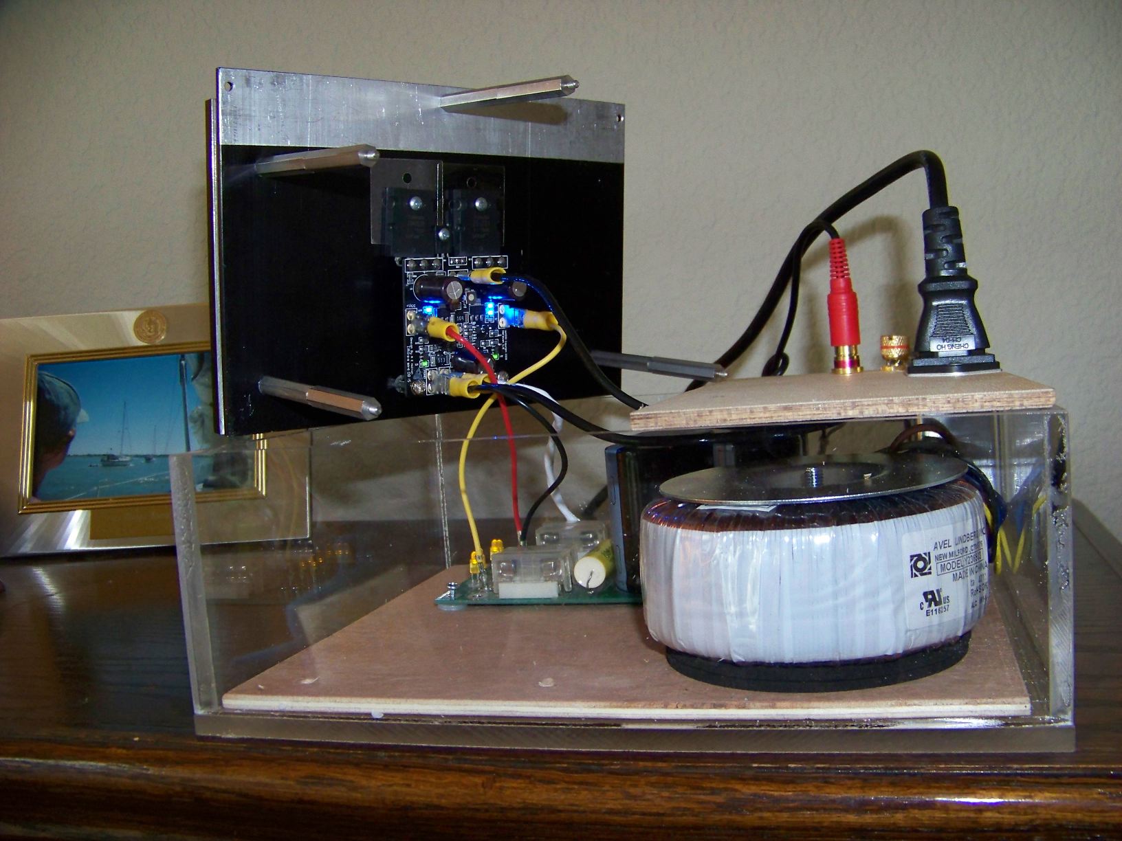

After several months of consideration, I "slapped together" this sub woofer amp. DIY TAP plastic case (power line filter keeps most of the noise out).

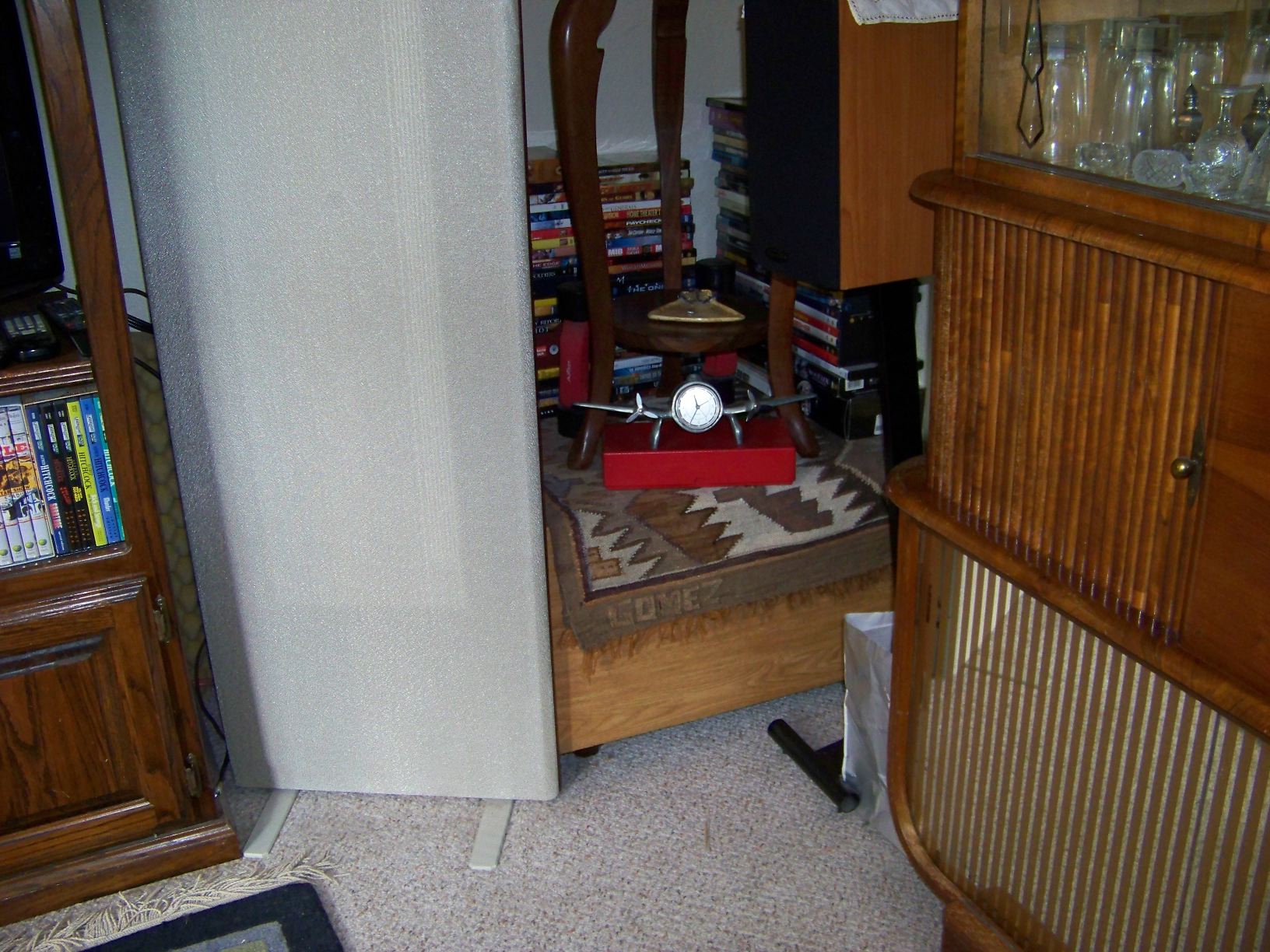

Aussieamplifiers.com 150 watt module and older PS-3 filter board driving Pyle Driver 15" speaker in 30 year old Cerwin Vega woof woof box. (buried in room corner).

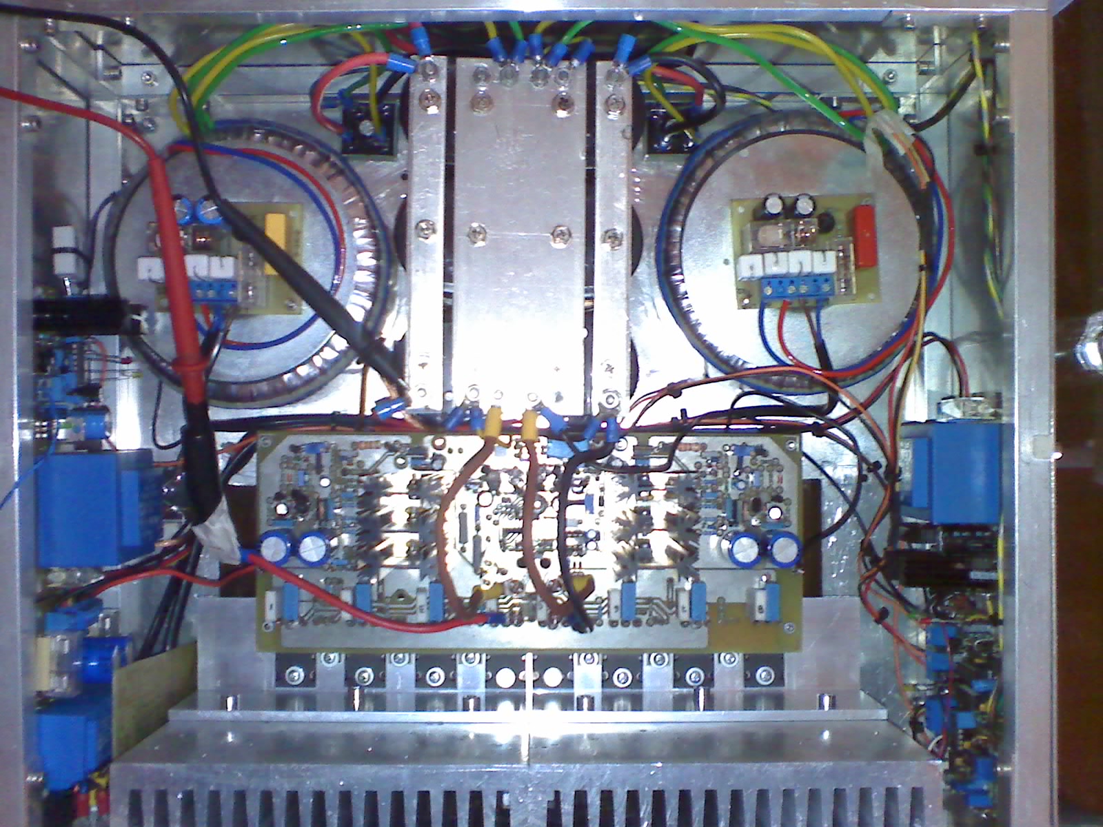

Borbely's Millenium75
Hi, showing off some pictures of the Borbely's Millenium75.
Class A all Fets, 75 Watt monoblock design. The heatsink is 25cm tall. Bias current is at 2.2A so it runs hot! During hot season like this, I need to to turn on the aircon to keep the room temp at 25C so the heatsink won't exceed 55C.

Nice choice for heatsinks & Rca connectors 🙂 i love those neutrix connectors.

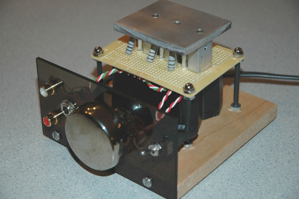

active ground channel source follower headphone amp
This is a three channel active ground source follower headphone amp. The heat sink and volume knob are also DIY, in fact, if you include the medical expenses incurred as a result of making the volume knob many would consider the volume knob alone to be audiophile quality. Most of this amp came from my parts box. I scavenged a vandal resistant stop cover for a Sloan flush valve at work and turned a core from some scrap Delrin I had on my lathe to build the volume knob and I machined the heat sink using a chop saw and drill press. The front panel is just a scrap of bronze Acrylic I had laying around and the base is a scrap of Maple from my wood bin. She sounds wonderful and is a great conversation piece to boot.
WoW! What an amazing piece of art!Also check the websites in my sig line. Large resolution picures here: Wiring Assembly
