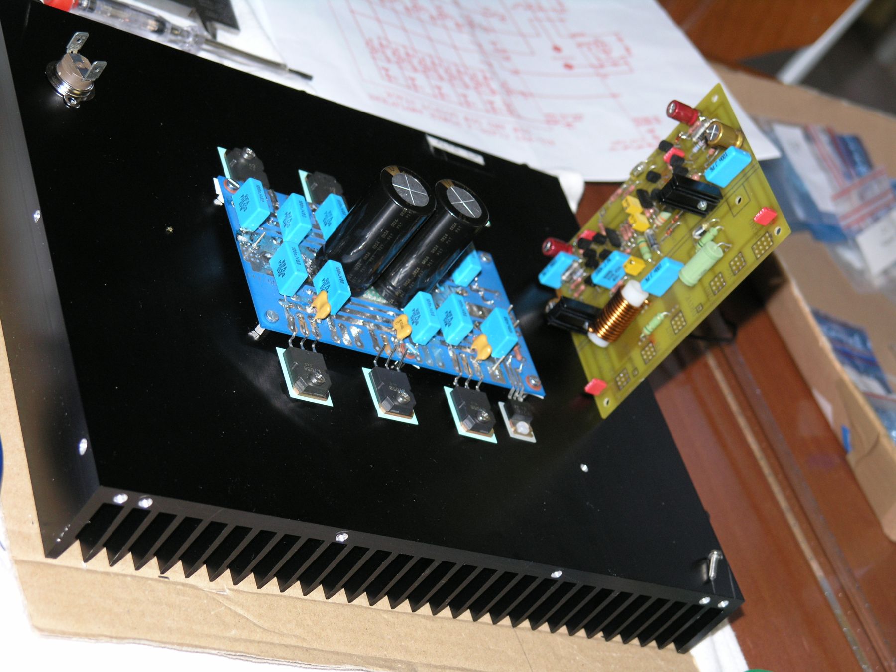

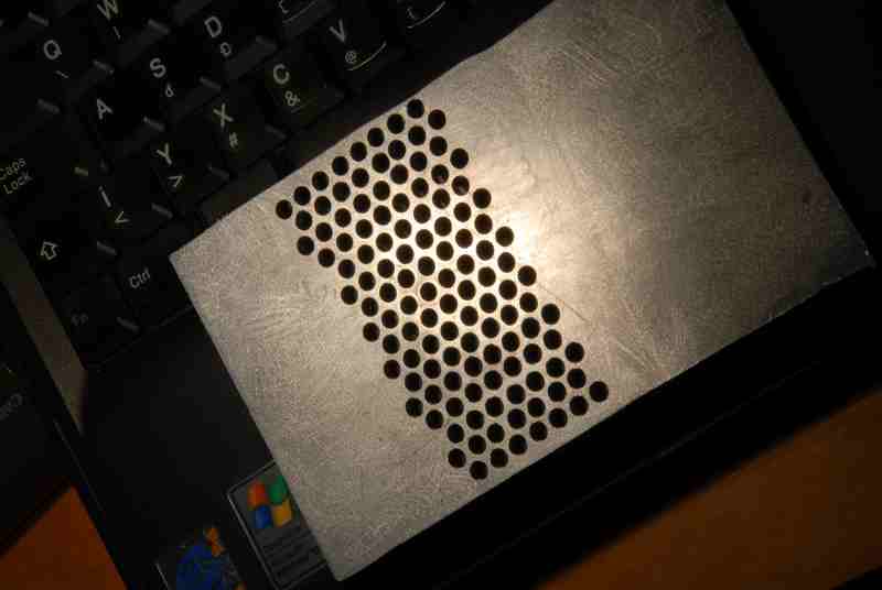

for this one I used as dima (drill guide) this mm paper http://lnx.edsdidact.it/shop/images/294.jpg
quite precise at the end,at last for my standard 🙂))

Thanks , I drill only🙁 , fine I will use this ,
some time 3.5mm hole is perfect size,we can put 3mm screw, or tapping for 4mm screw or live as is 🙂
As I jump from SS to tube ,what suggest for big hole ? Punch?
Dear nico, milling cutters are specific tools. Are not for drilling simple holes for screws. For this purpose the common HSS drills are preferable because have nose tip which can centralized in punched centers. Instead a slot drill has a flat cutting surface which can't centralized. Of course you can use a slot drill yet with a drill press providing that the workpiece it is tightened securely on the support table. To make the thing short, it is waste of time to open screw holes using milling cutters. Moreover, if the workpiece has a thickness from 2mm and above, then yet a common drill bit can open a perfect round hole.
I use milling cutters only for such works like the ventilation holes or for opening holes for buttons, LEDs, switches etc on the front panel. Also, for cutting square holes.
For big round holes it is preferable the use of HOLE CUTTERS with a drill press. If you look at the picture of the rear panel of my amplifier, i did the holes for the XLR sockets with a hole cutter of Φ22mm at the drill press.
You must not forget two things for a good result:
1) Good tightness of workpiece on the support table to stay stable during drilling
2) For cutting or drilling aluminum sheets the use of diesel oil for lubricating the cutter to not melt the aluminum. For metal sheet drilling you must use for lubricating a mix of: a) 80% water b) 10% thin motor oil (say SAE10W) c) 10% common soap. This prevents the damage of drill bit due to overheating.

From this picture, it is obvious that you are an excellent machinist.
Your project as well it is very nice, and implemented with Hi-End class parts like the Cornell-Doubilier Silver Mica capacitors.
My compliments sir! 🙂
Fotios
Thanks so much Fotios for encourage , as this my first serius try on alu ,before I work only on wood.....
Very usefull your suggestion😉

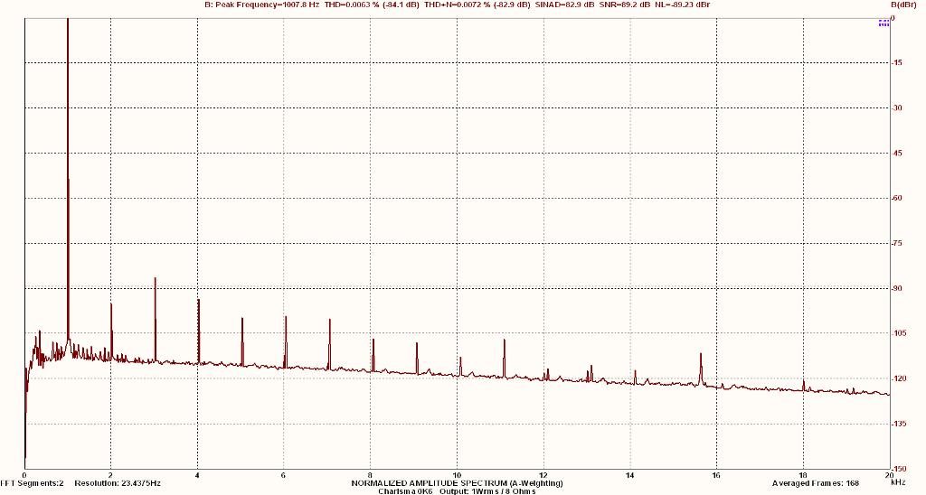

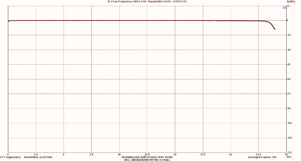

Some measurements of charisma 0k6
Measurements of amplifier output driving a dummy load of 8Ω with 1Wrms. Software used is the Virtins M.I. Pro3.1 via a Sound Blaster X-Fi Platinum. The sampling rate of sound card was 48KHz and the bit depth 24bit.
Fotios

Aluminium drilling
Dear Fotios!
I need your opinion.
I love it onto the idiotic one his pierced cover your amplifier.
Exceptionally precise, just like the rest of his parts for the thing.
But for me only single old B&D I have a drill, with a rack.
I took from my primary payment yet, before with 32 years.
That's right, we are old old men like this.
Let the deuce take it.
Oh now if I do not guide it the drill stem, crawls away into that goddamn aluminium the drill stem. The component of the mincer than drill scheme
may it be a solution?
Let my wife not find it out by the time I use her mincer only.
I desire to you a beautiful day:
Gyuri

Aluminium drilling
For beginning not bad. Only enough exhausting, and not enough efficient.
So that for you, Fotios, I do not recommend it because you starve to death if you do it so.
But this here DIY, because of this allowable the mincer method.
Gyuri
