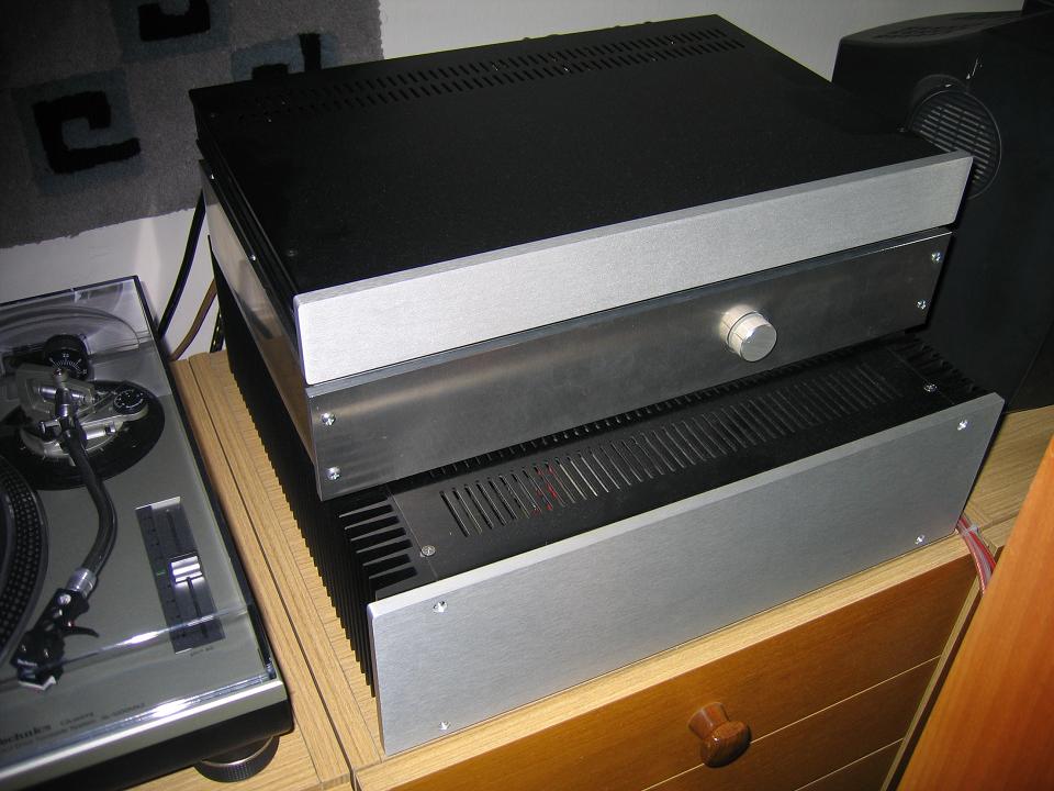

Just finished my first discrete solid state amplifier (a pair of monoblocks). They're pretty basic, with a paralleled TIP2955 / TIP3055 output stage. The hardest bit about designing the amp was fitting everything into the compact case, but it worked in the end.
The heatsink / PCB assembly slides out to allow biasing, measuring servicing etc., pictures three and four show this. The PCBs are my own design, made specifically to fit the case.
