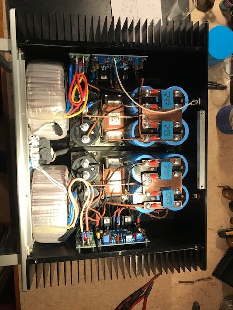

And mine are ready.

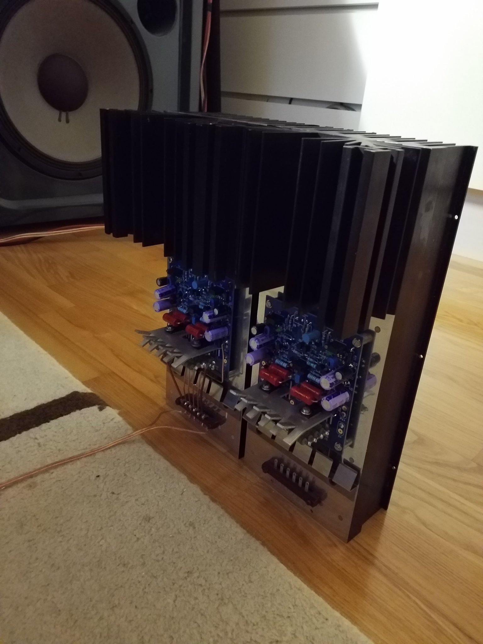

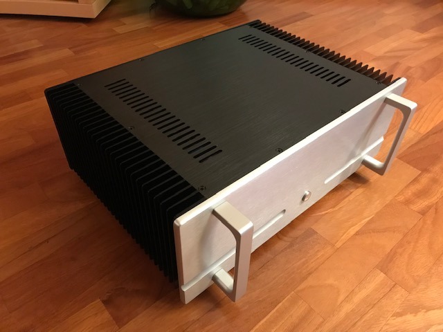

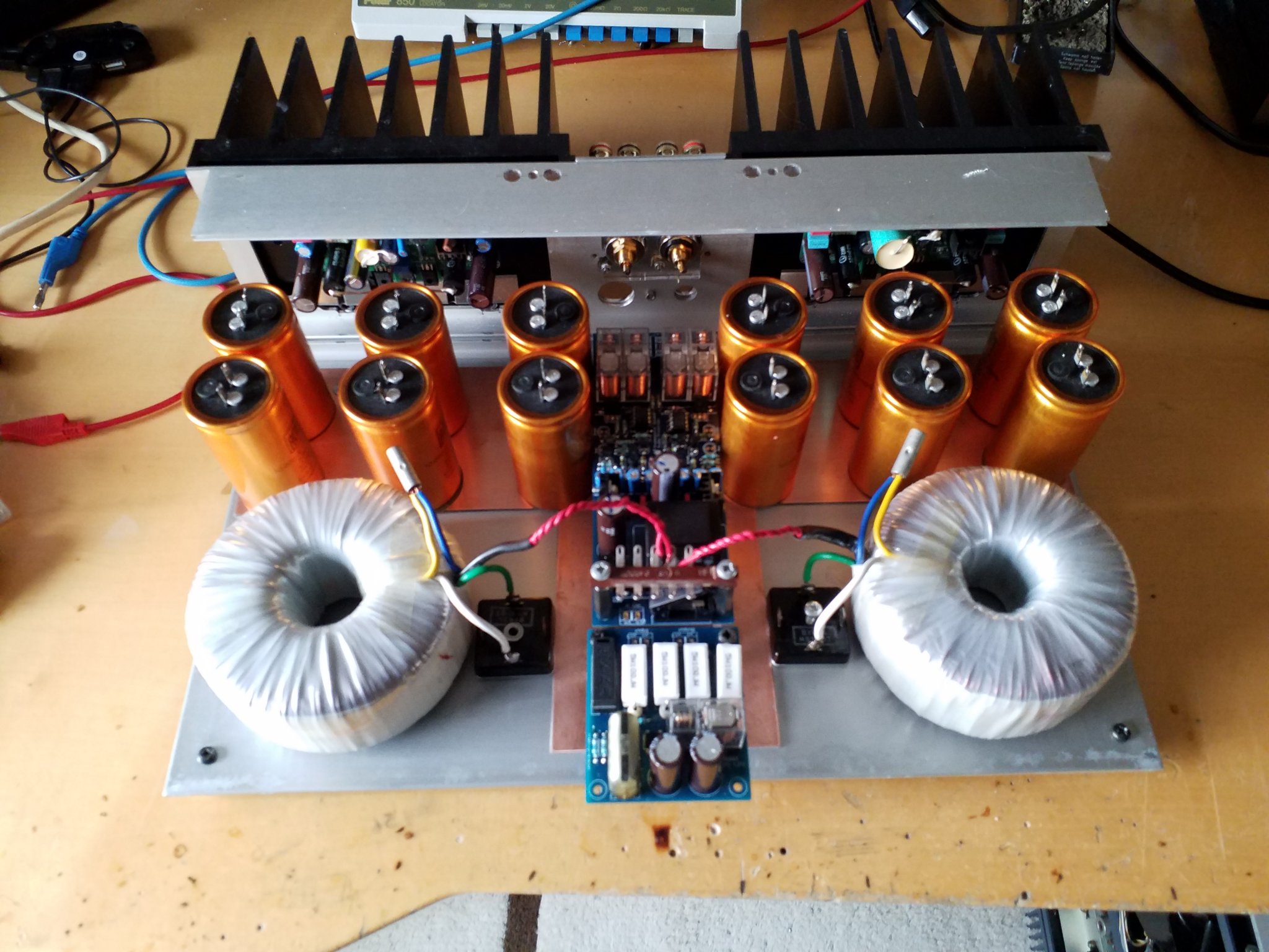

Apex A40 introduced in Class A in bridge version.
Each block of 2 planks in a bridge.
Capacity of each block 250,000 microfarads.
As this is my personal child, it also bears my name.))))

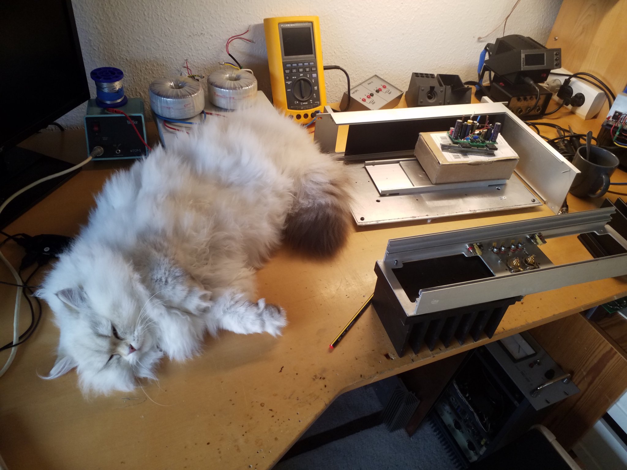

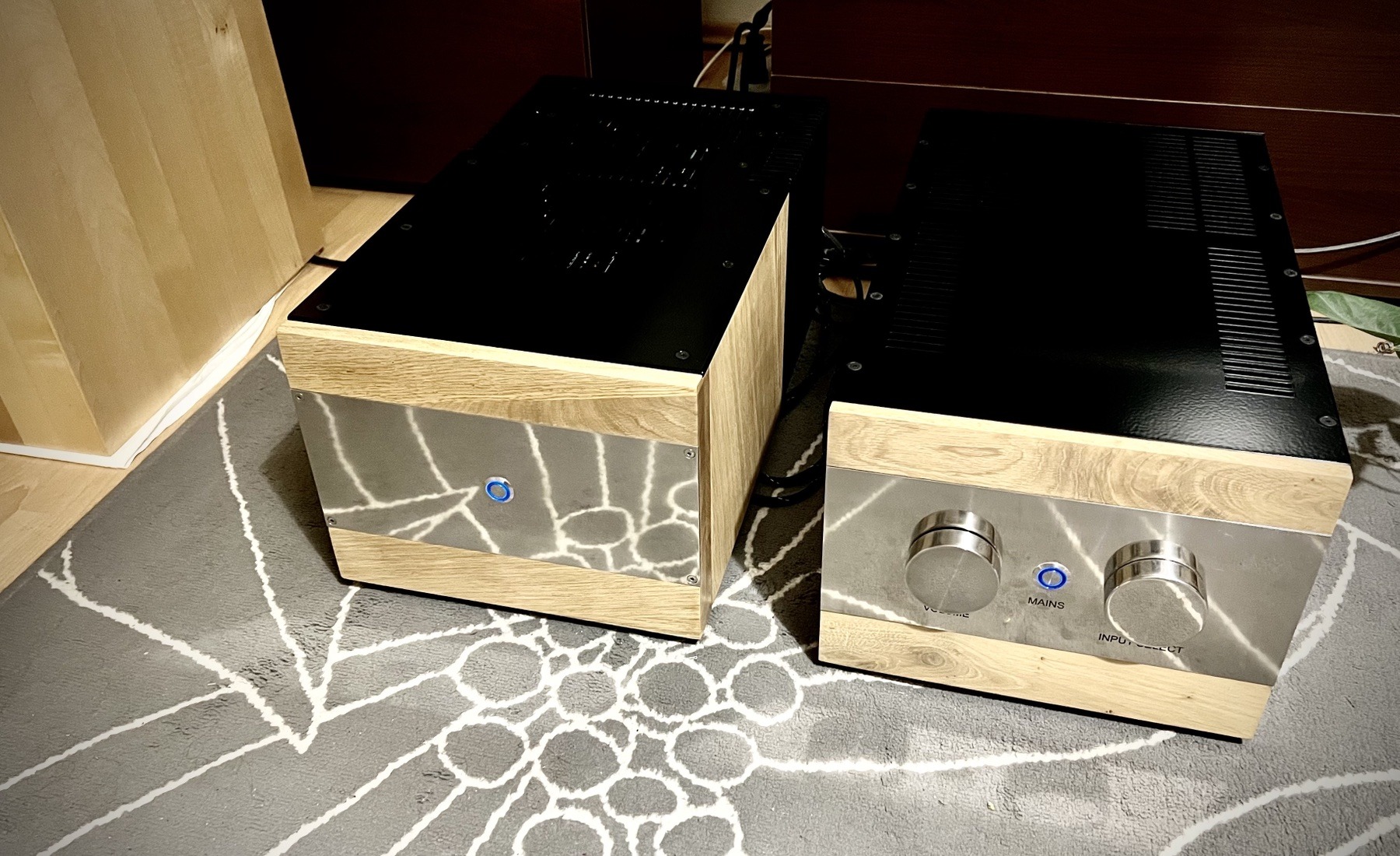

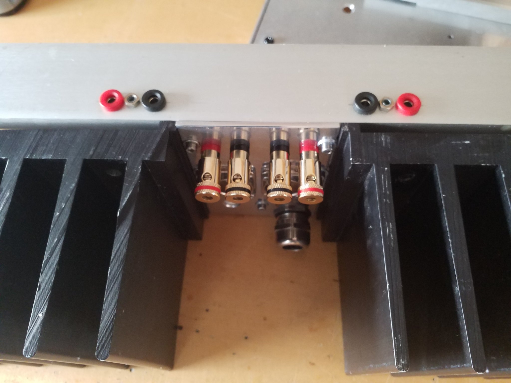

Hello.
I've been gone from diyaudio a few years due to a few family crisis, but I'm back again.
I haven't been doing any DIY for a long time but picked up a old project, the famous p3a by rod,
I found a cheap chassis in used condition that fitted okay.
Its fully dual mono, will use crc supply.
In a few days it will be operational, and I'm quite excited about its sound.
I made the bias adjustment external, accessable on top of chassis, two 20 turn trimpots and four banana plugs, will make adjustment easy and precise I hope.
Last photo shows my assistant napping

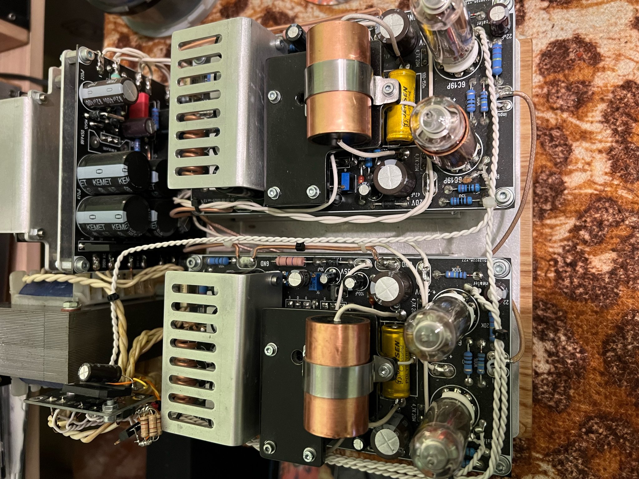

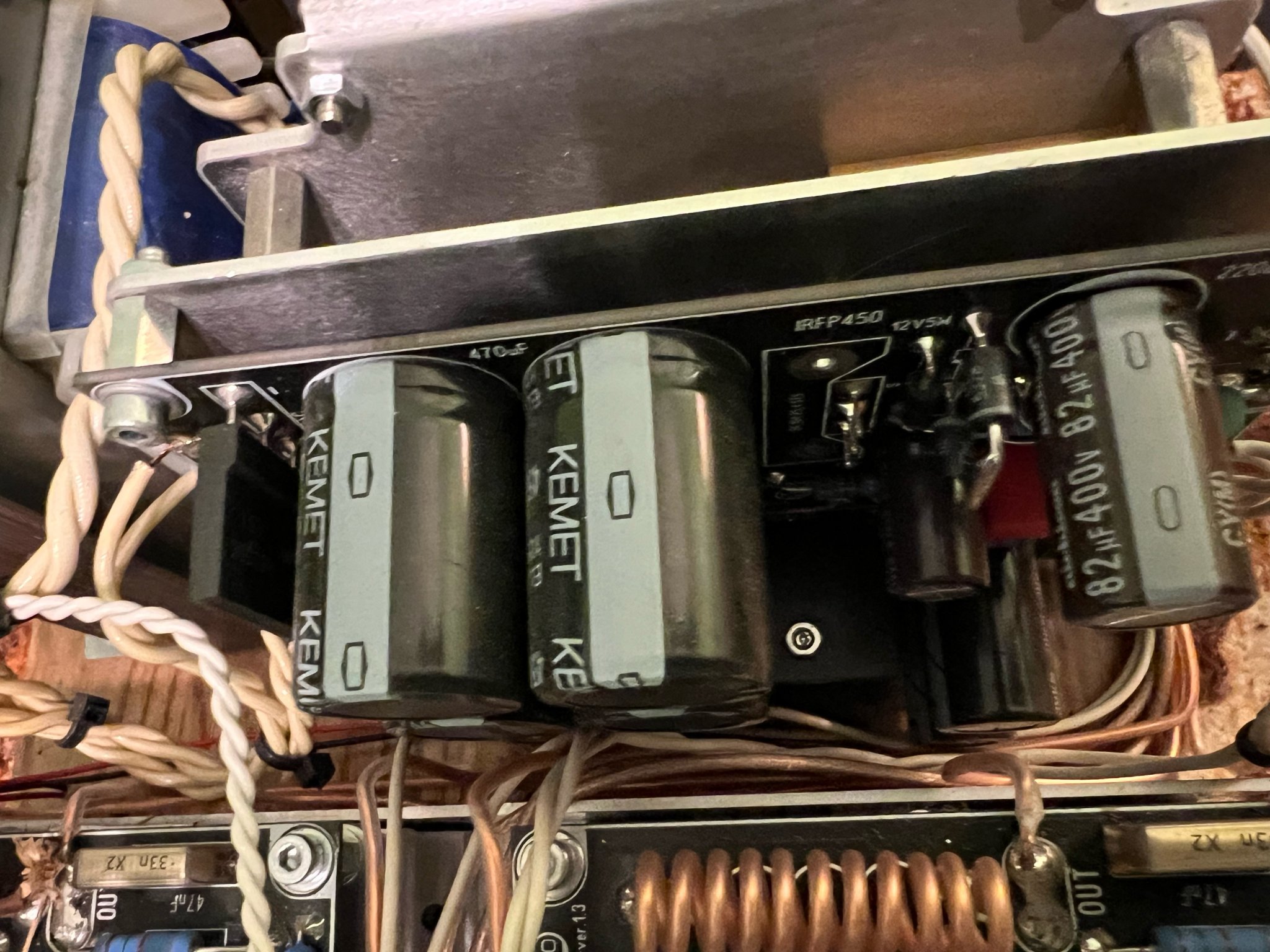

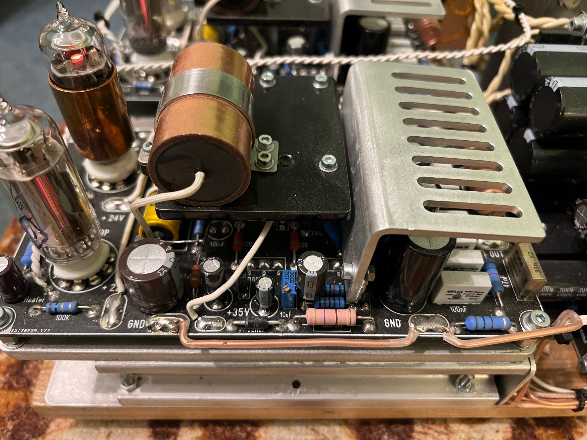

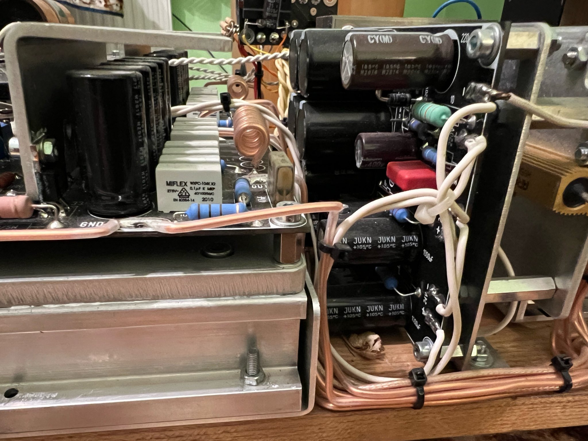

Much better... I have the same kubota boards..

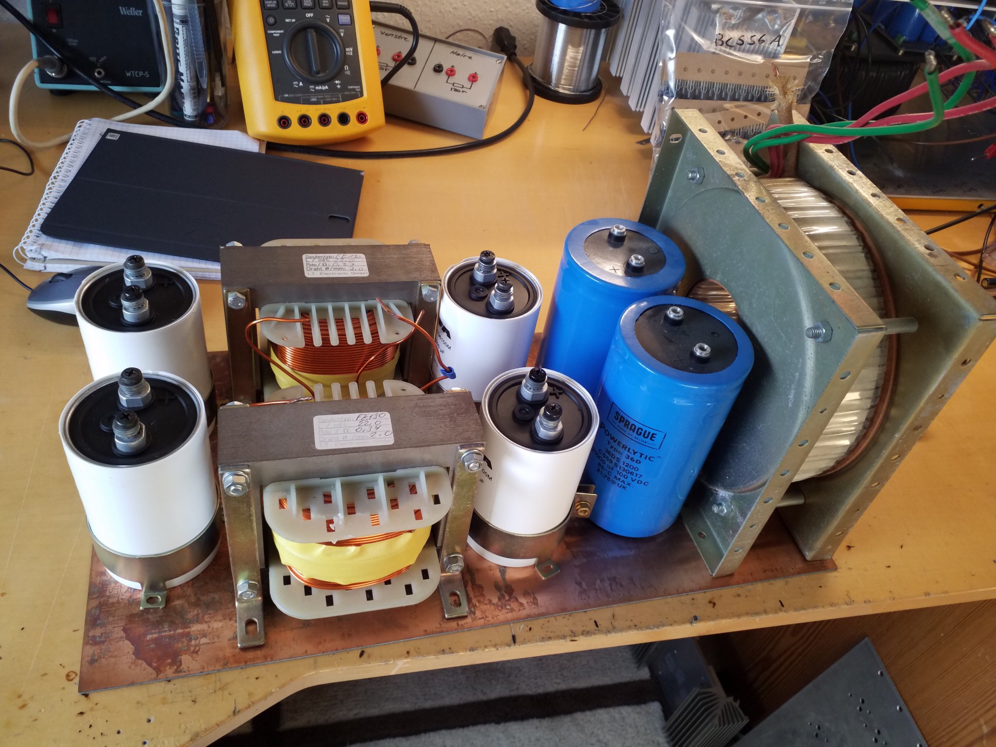

Hmm not satisfying?? Have you tried putting the L right after rectifier? What's their inductance and dc resistance?
Dc resistance is 0,34 ohm Each winding
80mH its a lundahl LL2772 in common mode connected on - and + rail
First had 75000 uF then choke, after that 31000 + 31000 per rail per channel. Bass was boomy and treble with sibilance. Replaced choke for 0,33 ohm and sound is much better
