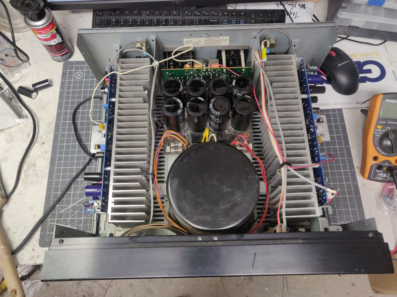

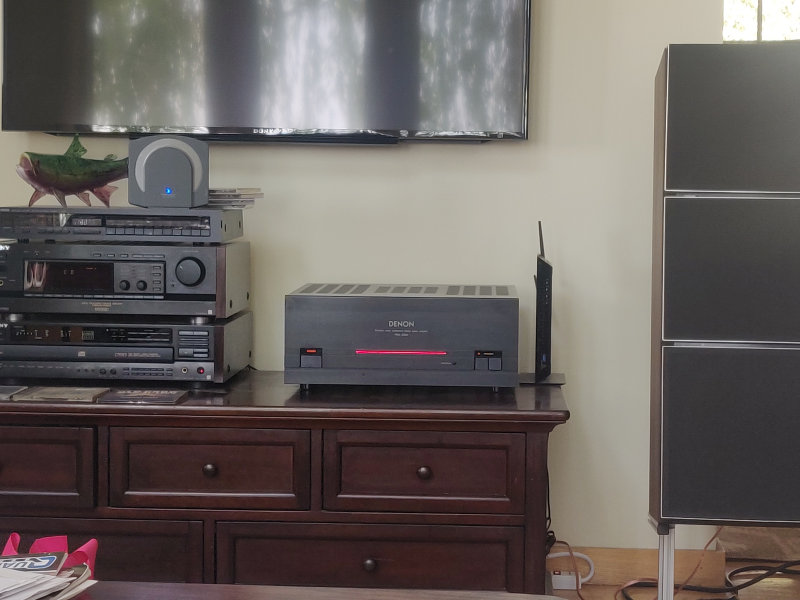

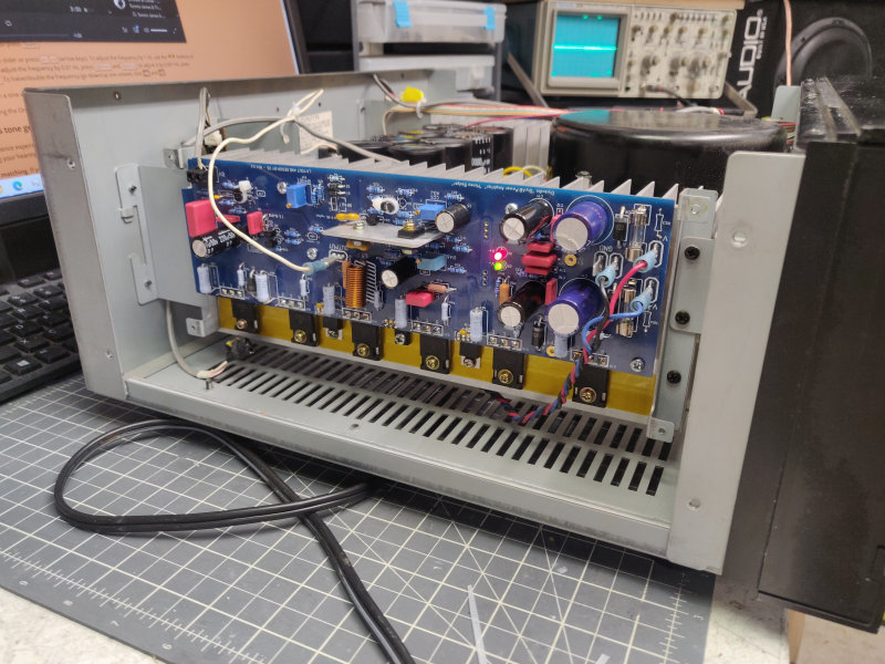

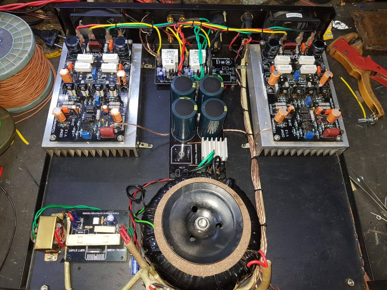

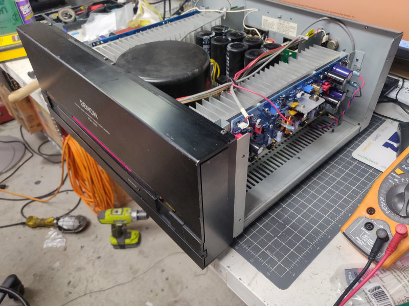

Recently finished up a honey badger into a Denon POA 2200 case. I basically just pulled the Denon amp boards out and used everything from the Denon. Perfect fit. All Denon soft start, speaker protection, and diagnostic circuitry is retained and fully functional. +-72v rails. Dual mono power supply below the transformer. 40,000uf filter capacitance per channel.
Very pleased with the performance.
Listening to medeski marin and wood's the dropper right now.

Excellent fit, looks very nice, cheers to you and MMW 😁

Great Idea, I have a 2800. If you replace those speaker terminals and those stamped metal pieces with wire you will improve the sound.
Regards
