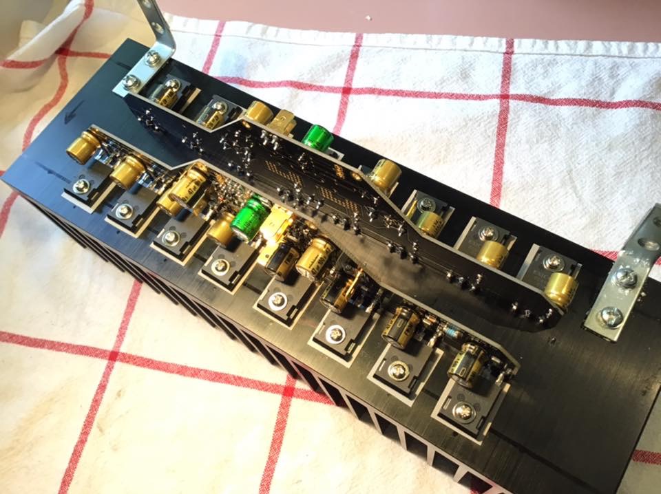

Which cables were used, the grey ones shaan?
1.5mm dia medical grade cables.
Thanks mate.

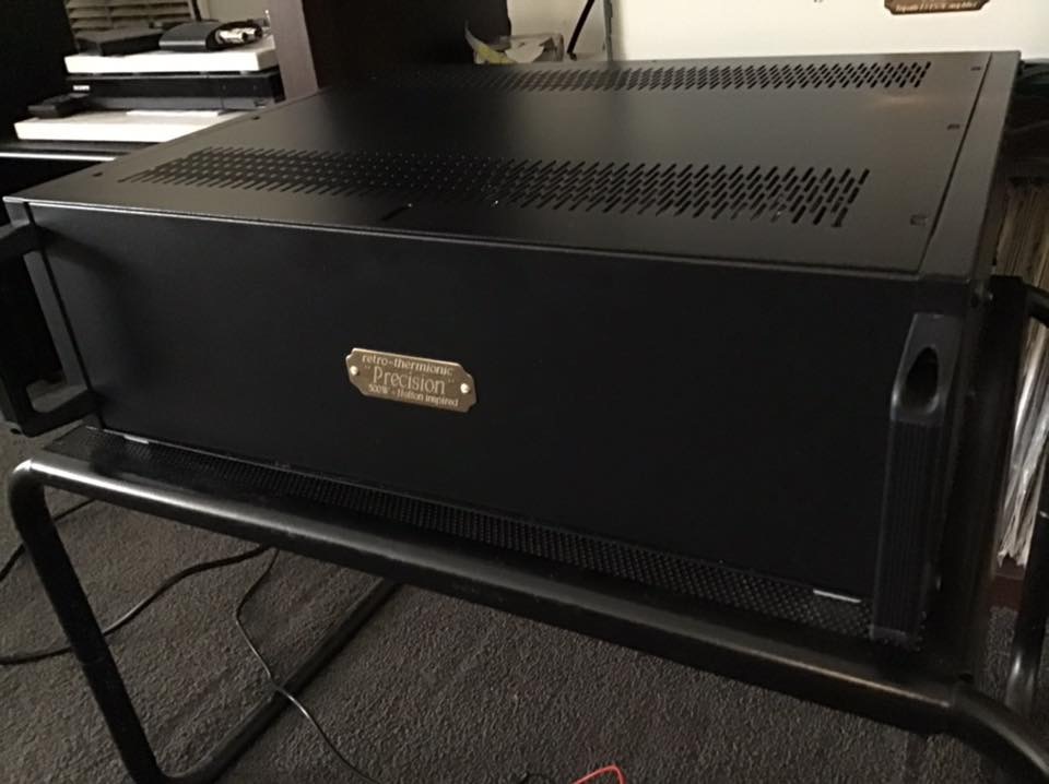

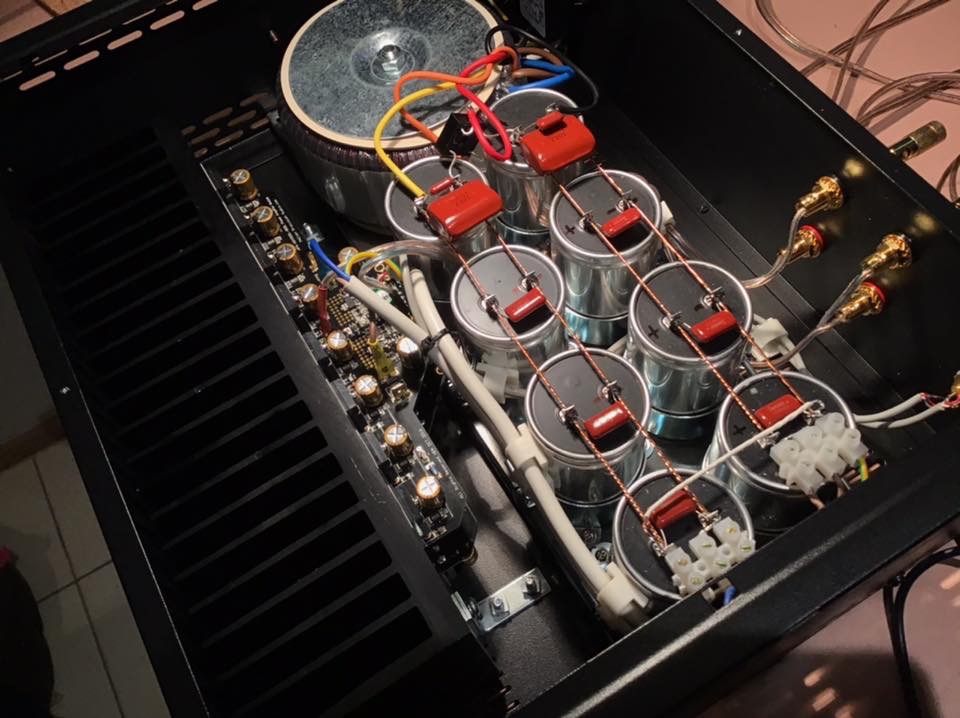

Monoblocks based on the V4H, just finished.
No CNC yet. All cuts in the chassis made by hand (with the help of a wood router). Plain anodized body and teak front.
Beautiful job Shaan!
The monoblocks were perfect!

Shaan,
Excellent work, the monoblocks look really neat.
What are the chassis dimensions?
Holton Precision 300W

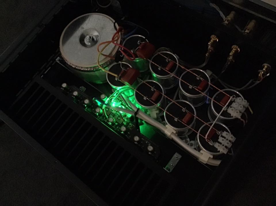

625VAC TRANNI, 80,000uf of 100V caps. 300W Class AB, 500W into 4ohms.
It seems a dot is missing....625VAC TRANNI, 80,000uf of 100V caps. 300W Class AB, 500W into 4ohms.
Shaan,
Thanks.
13"d x 11"w x 5"h
