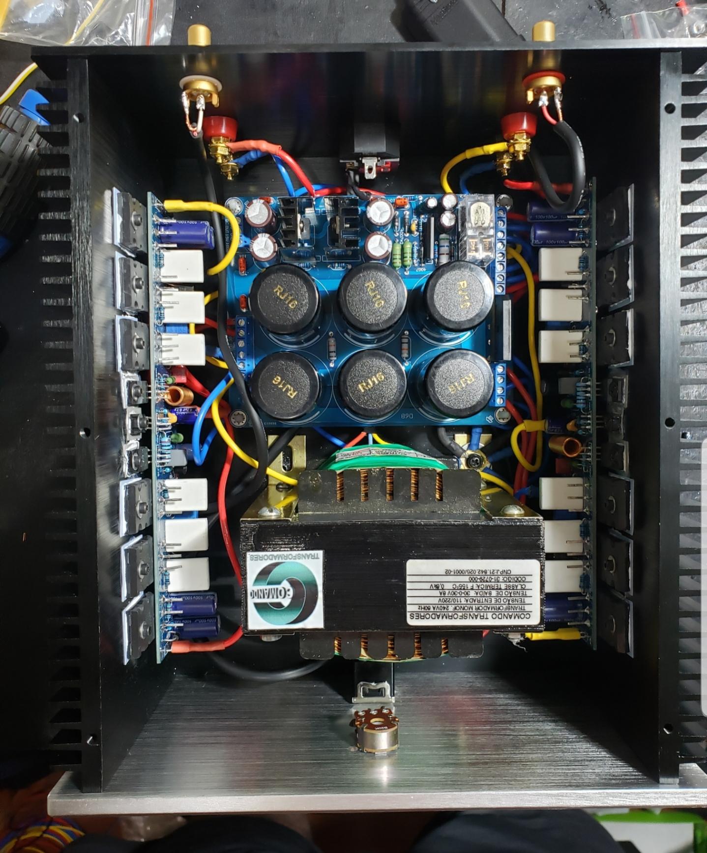

So there's something wrong with all this because when I measured the power, I used a 1KHZ sinusoidal signal and the heat sink got hot, but not to the point where I couldn't touch it with my hands.
During the auditions, he gets warm, except one day when I decided to turn the music very loud. This day he got a lot hot but nothing to worry about. I found the temperature quite normal considering being an AB amplifier.
Anyway, I will exchange the power transformer for one capable of providing 350W.
Maybe with this 350W power transformer the heating will be too high?
Below the specifications of each heatsink.
Heatsink Dimensions: 110mm x 260mm, thickness is 7mm,
Each heatsink has a net weight of 0.8 kg.
Soja, with a 350W transformer and the same voltage, you effectively still only have a 70W (8 Ohm) amplifier. You might get away with the cooling as is for that, but on 4 Ohm, I would worry about over heating. I'd guesstimate you might get about 110W out of it on 4 Ohm, as is but too much heat would be an issue, I'd think.
But I could be wrong.

Is it a finned heat sink ?
But with a 350W power transformer versus a 240W power transformer I would have lower voltage drop. Or am I wrong?
Measuring at 1Khz sine wave and 4ohms load the power supply voltage dropped from 42V to 36V.
I imagine that with a higher current power transformer, I have lower voltage drop.
Yes, with fins.
See the photo of the heatsink.
Yes, the voltage drop of the bigger transformer will likely be less, but you still have difficult to predict voltage drops elsewhere, as in the rectifier, traces, wires and bond wires which will all impact more the lower the load impedance is.
But that is not really a concern, it's more of a given. The concern is possibly overheating when operating at rated power and/or lower load impedance.
The ribs on the heat sink seem, just by the looks of it with respect to your proposed power rating, a little bit under-engineered.
But, I could be wrong.

Truth. You're right.
I have sized the connection cables to prevent or minimize potential current losses through undersized cabling. But I don't know what parameters the board layout designer took into consideration when sizing his tracks.
Currently, the nominal impedance of my speakers is 6 ohms and I do not intend to use speakers with a nominal impedance lower than this.
As for heatsinks, really their fins are not as large as they could be.
Therefore, I will not abuse high volume and impedances of less than 6 ohms.
These days, during my auditions, the heatsinks are comfortably warm and no more. In this way I hope this amplifier has a long life.
Thank you so much for your answers, It's been great for me to know other points of view and enhance my knowledge

Just keep an eye on the operating temperature and you will be ok.

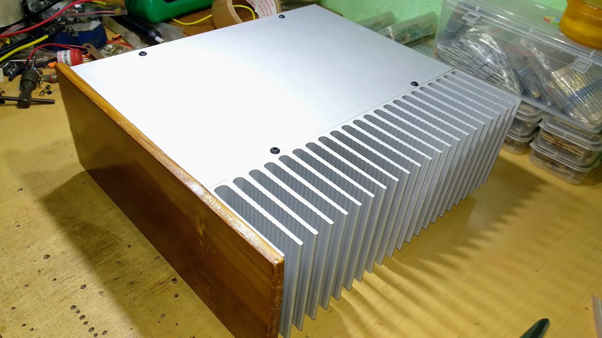

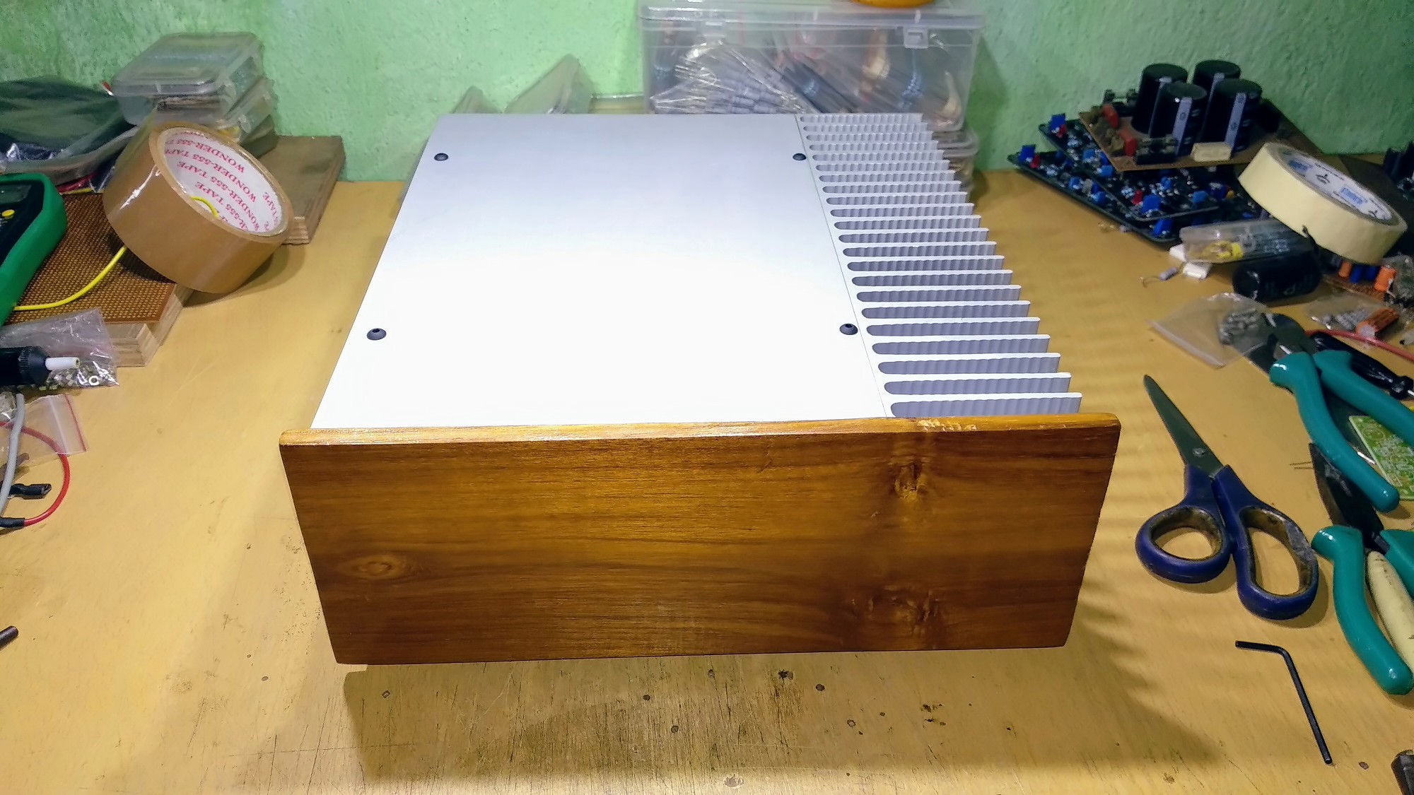

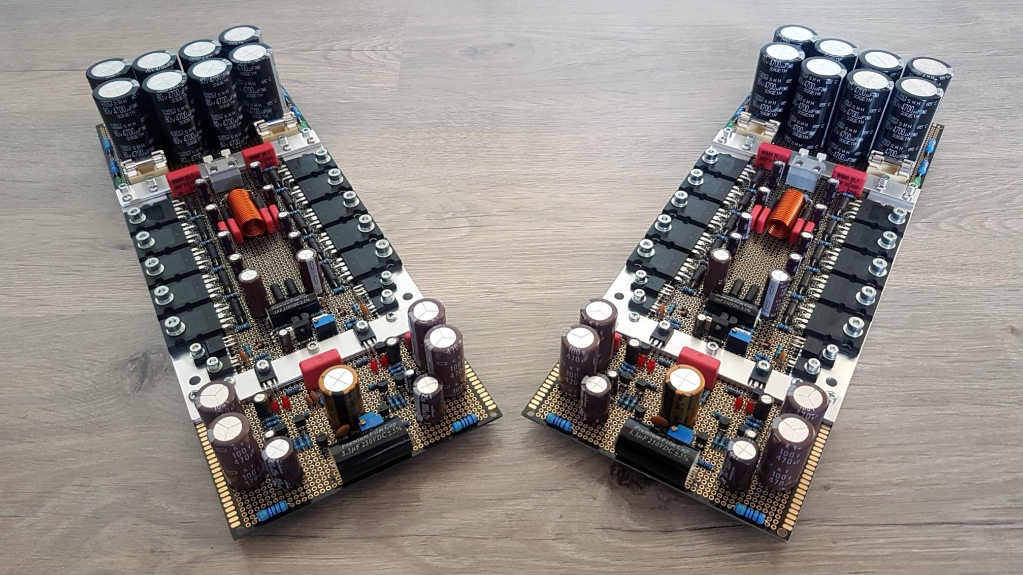

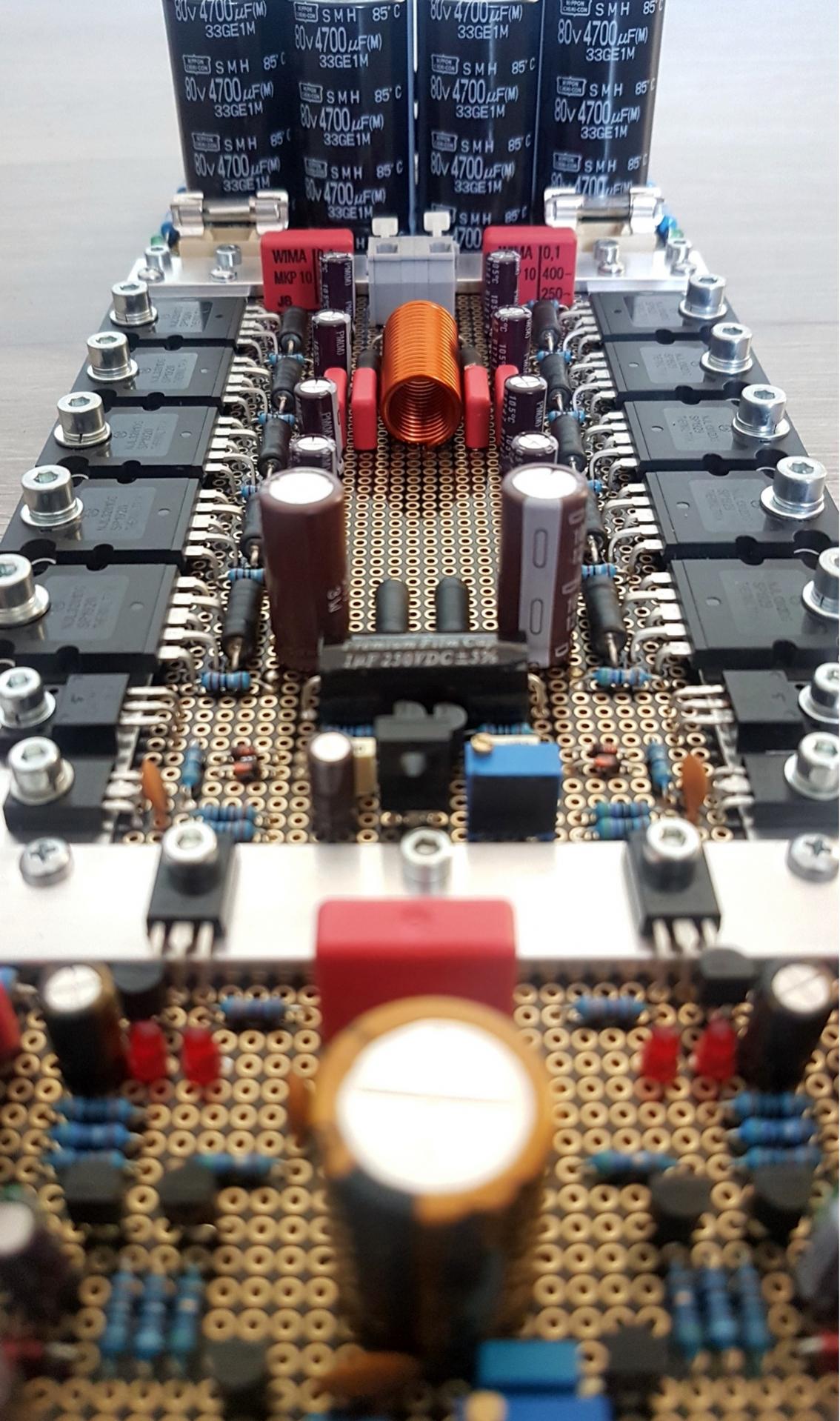

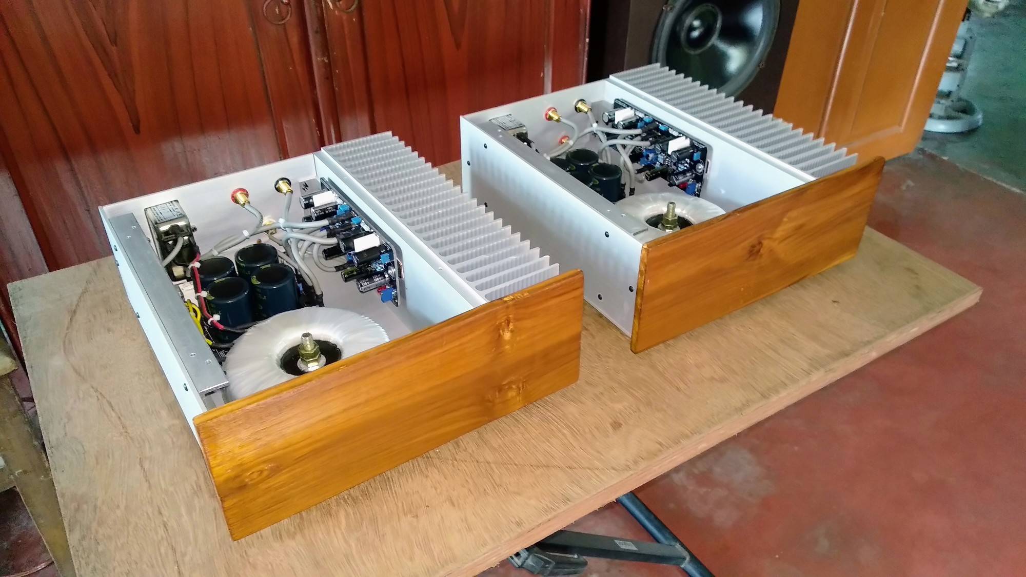

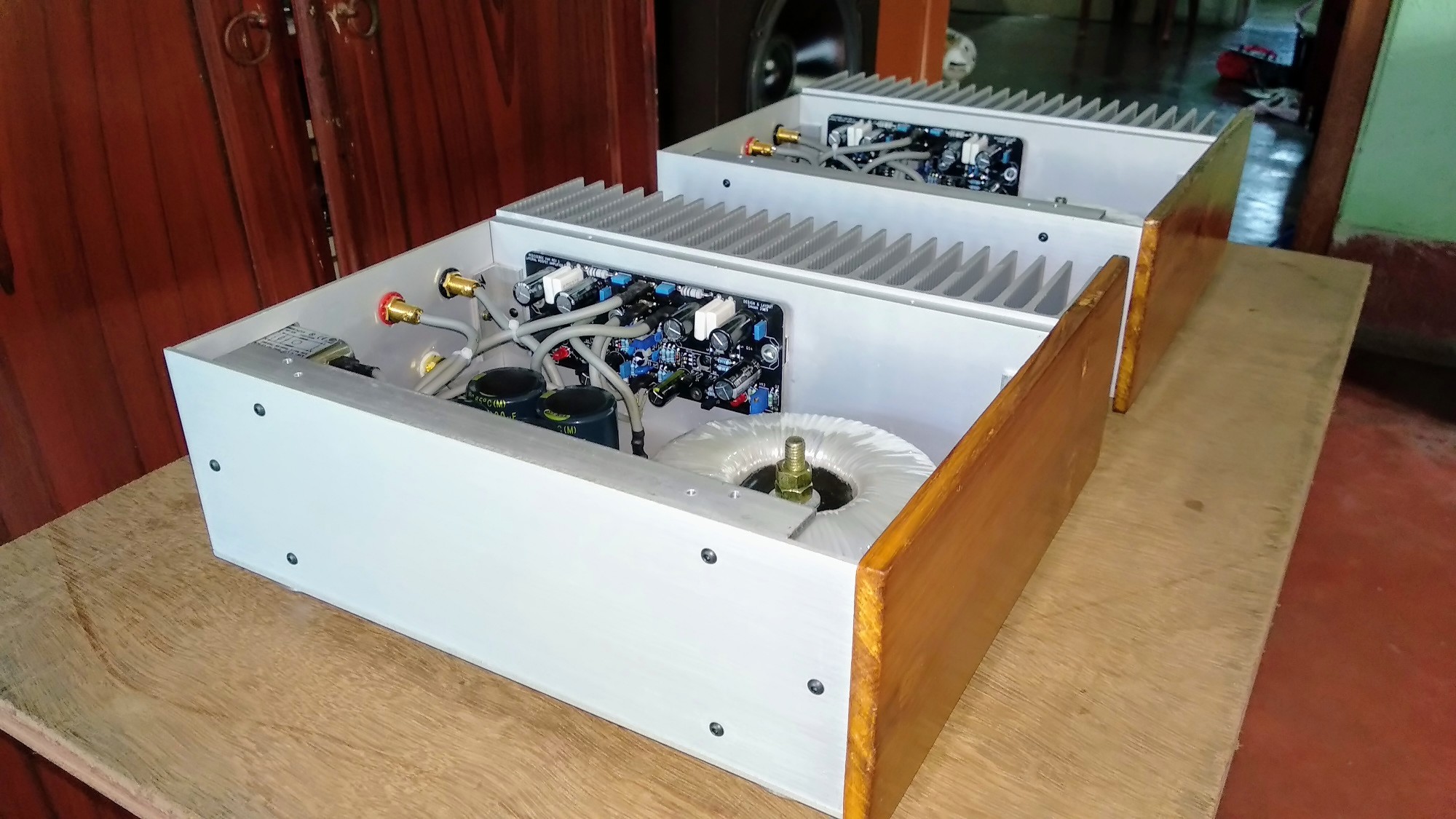

Monoblocks based on the V4H, just finished.
No CNC yet. All cuts in the chassis made by hand (with the help of a wood router). Plain anodized body and teak front.

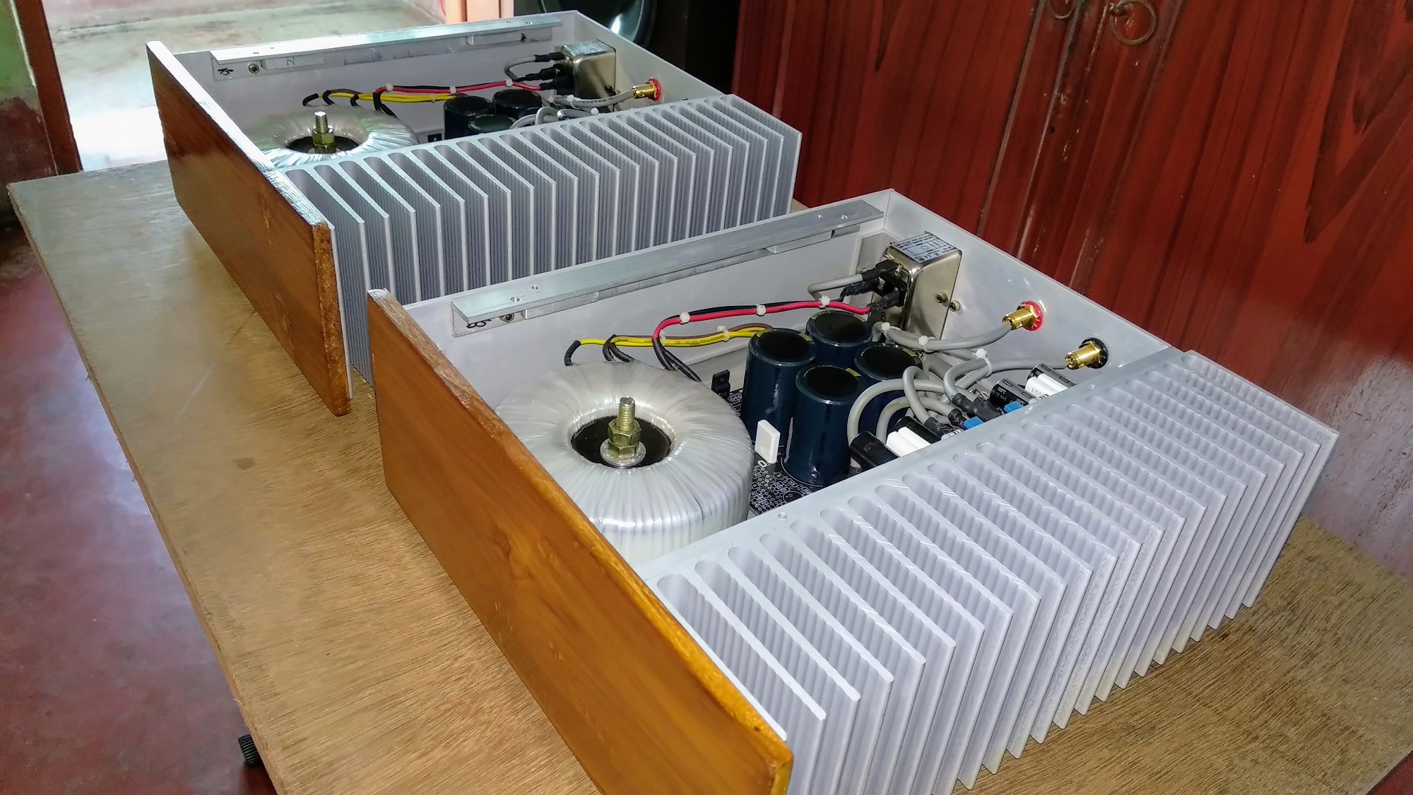

Beautiful.
Beautiful, but why not symmetrical blocks?
Beautiful.
Thanks.
Both channels were made the same in order to simplify the build and decrease the chance of misaligned screw holes.
