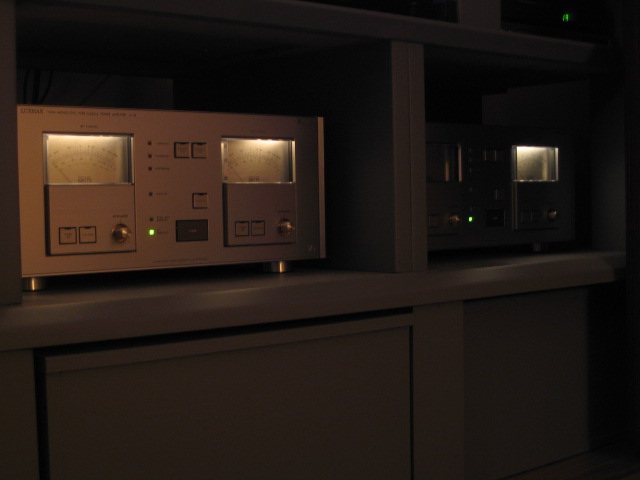

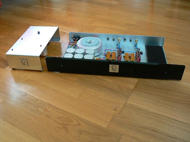

Luxman M-05

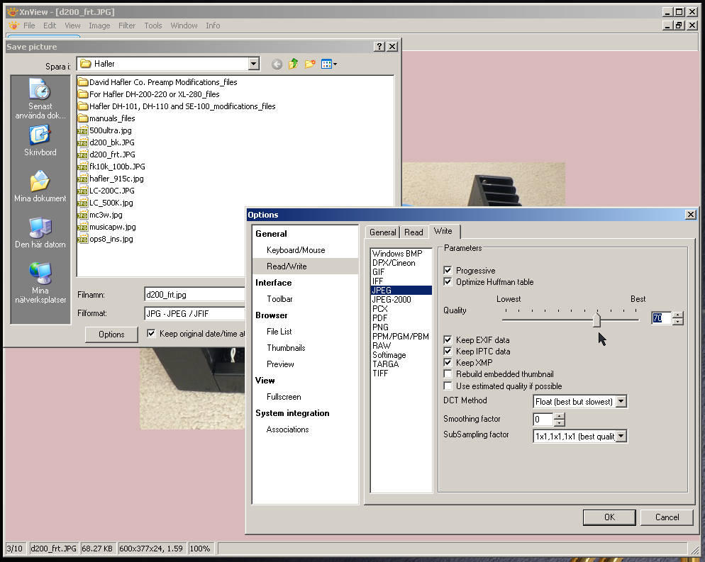

You have to use one Image Editor program.
To make them less than 1000x1000 pixels and less than 100 kB file size .
I use XnView freeware. Has got Image Resize function.
http://pagesperso-orange.fr/pierre.g/xnview/endownloadwin32.html
And when I save JPG image I can select reduced quality of the copy saved:
... from 0% - 100% JPG image quality.
Usually 60-70% quality gives a small enough file. Compressed in format.

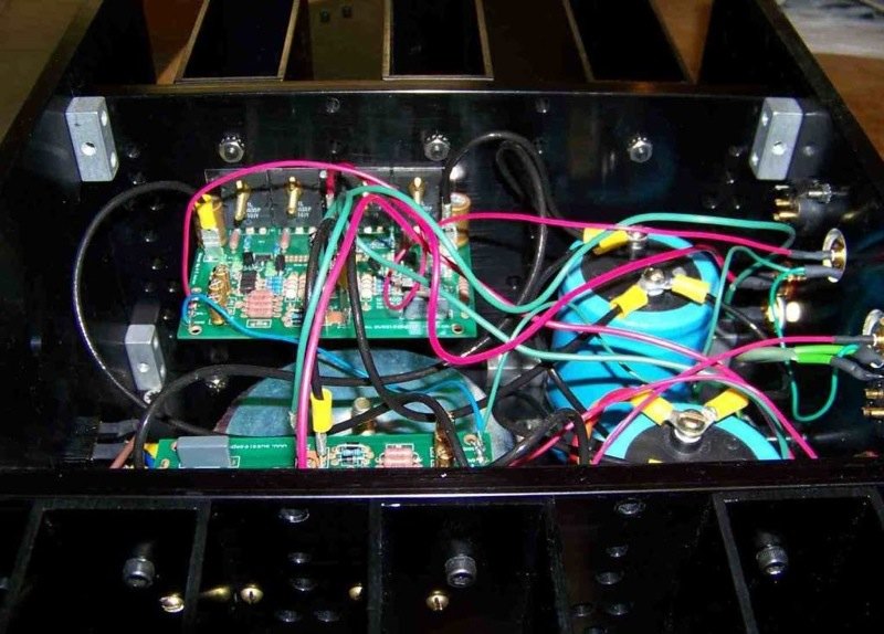

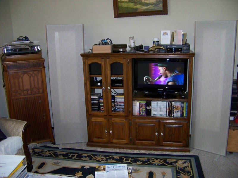

In use:
That's Marcus Miller and Eric Clapton's jazz band, Live at Montreux 1987 (a great album).
The Grandfather's old windup Edison, left. The Amp drives two Magnapan MG-1.6, signal conditioned by Bottlehead tube pre-amp ... Yes, I did straighten the picture after this was taken.

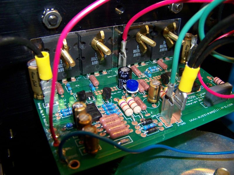

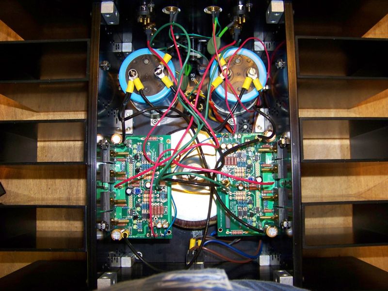

Very nice FastEddy. Those Aussie amp modules sure look good I must say.
Tip: Use a big washer or better still for DIY a piece of PCB between your mosfets and the wing nuts or mounting screw. This will spread the force on the package and prevent die crack inside the package.
I know well of what I speak - you would never guess the number of customer complaints I've seen because of cracked power device due due to excessive mounting torque or lack of a spreader of some sort .

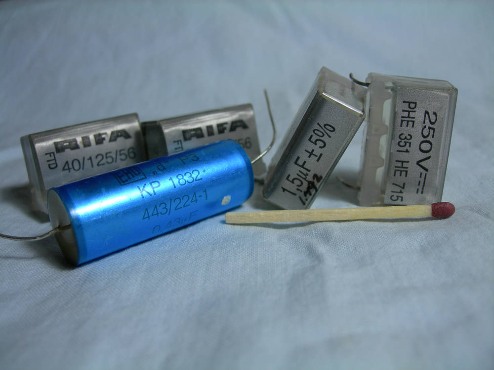

Axial: Roderstein KP1832. 0.43uF 200V polypropylene
RIFA: PHE 351 HE 715 250V
I found a whole bunch of these 1.5uF caps at an old PCB.
They look quality. But I am not sure what they are.
The value of 1.5uF would be good for some amplifier input.
