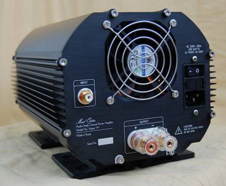

Nice implementation Dr. EM. It is obvious your excellent craftsmanship. Bravo!
I have only few comments for the pasive parts that you are using. All resistors are metal film except the 5W emitter which are vertical wirewound. If you have the economic posibility, the next time try to find Metal Plate Cemented resistors (MPC), there is a online store in Germany which is distributor of Futaba resistors, in packs of 50. The price is fairly good. I don't remember the name, type in your browser Futaba MPC resistors to find it. Futaba also offers a big variety of metal oxide film resistors up to 10W and many other difficult to find types.
As for the caps... you have made a cocktail from first quality types, such the Cornell-Doubilier silver mica, the LCR polystyrene foil and the WIMA polypropylene foil with the lower quality Arcotronics polyester which are the white caps. I know, that they was in your stock probably, and Farnell does not have WIMA MKP in 100V range. The same RS components. Try a search in "Selectronic-France" and in "ELFA-Sweeden". These two on line stores they offer a big variety of caps for audio use in good prices and in small quantity if you wish. Evox-Rifa (Sweeden) are good alternatives for WIMA. Also Arcotronics (Italy) polypropylene type are grey colour.
Please, don't misinterpret my comments as criticism. I reffered all above only for information about these stores for any member from Europe who is interested. Me also, i have two amplifiers in use with resistors and caps of middle quality and origin which i don't know :D
