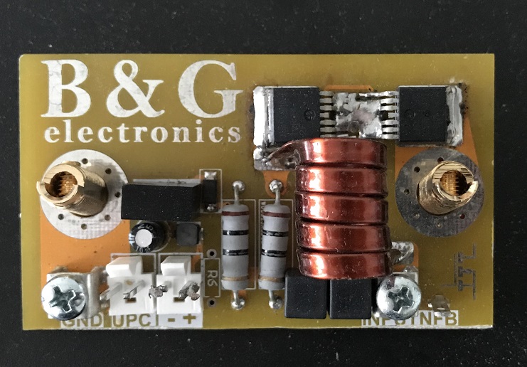

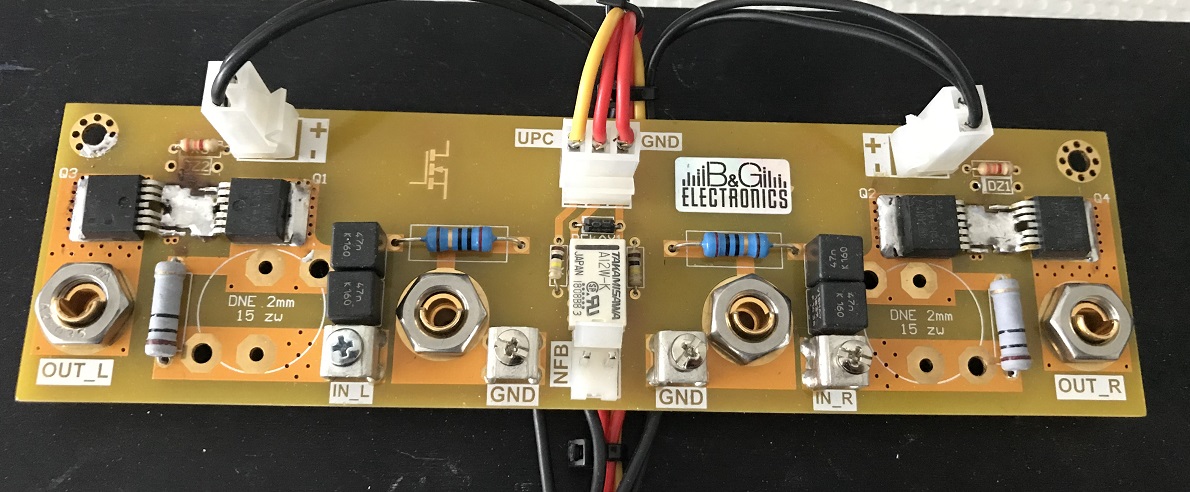

I'm going to make small pcbs with power mosfets to handle the loudspeaker disconnect, instead of populating the pcb with relays.
I was struggle with MOSFET Relays a many month ago and even made master thesis about this. MOSFETs has alot of advantages but you need to build a little bit more complicated driver to them.
On screens below is my way to do this.

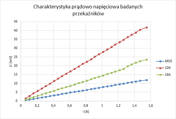

Did You check the characteristic of the MOSFET? How drop voltage on junction depends on polarisation of the gate?
On Screen below You have comparation between traditional relay and MOSFET relay.

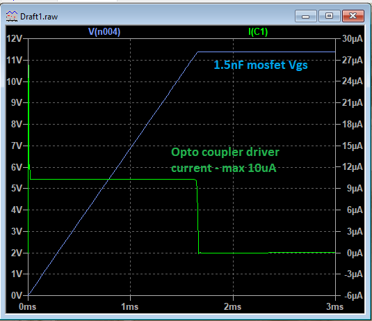

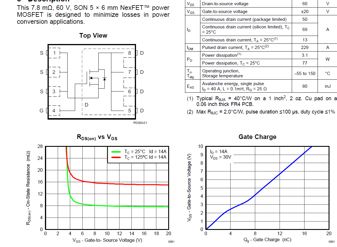

You do not need 50mA of current to drive the mosfet's gates it is nonsense.
To drive the gates YES You need a bit of the current to charge DG GS capacitance's, but basicly You need a proper Vgs voltave, usually about 10V is Ok - just look at the example bellow, from Vgs=6V on RdsON have practically the same constant value. Photovoltaic drivers are sufficient enough to drive mosfets in SSR aplications. With 10uA of current and 1500pF You have about 5ms to turn on the mosfet fully - more than enough.

That depends, for me 15-20% is a lot and we take a look only on resistance.
One thing, if junction resistance is higher You loose more energy for heat, temperature of junction is higher and RDS ON rise with temparature. Power MOSFET has almost 10nF, so the time is even more. 5ms is to much time for me.
piglet

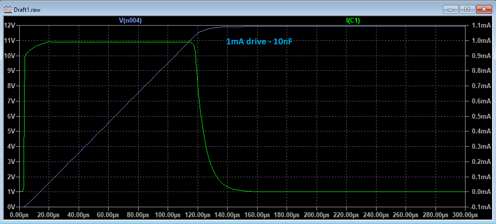

10nf driven by 1mA gives about 60us switching time. No any sense to faster switching in SSR relays.
RdsON --> difference in between 8,0mOhm vs 8,8mOhm is like nothing to compare to the series resistance of the connectors used to connect from amplifier PCB to the output terminals + resistance of the speaker cables.
Heat loses difference on junction for single mosfet (caused by a bit lower Vgs voltage You talking about) --> 10A * 0,008V = 0,08W for 10A of constant current passing through the mosfet.
80mW@10A and 0,0008R per mosfet is really no difference.
I recommend using more current than 10uA to switch a MOSFET relay. Both to get crisp switch-off and to be safe against gate leakage currents at elevated temperatures.
During a fault condition their may be 10A or more flowing through the MOSFET, with 50V or more available to push it through MOSFET and speaker voice coil. This will heat the MOSFET die up super fast as well as accelerate the speaker coil to the endstop, sub-millisecond switching times are well worth aiming for as its perfectly achievable:
1mA will switch a 100nC gate-charge MOSFET in 100µs, which seems very plausible as both an opto-coupler current and a switching time. And 100nC is not the largest gate charge in a power MOSFET by any means - 1.5nF is not credible for a low on-resistance MOSFET capable of breaking 100V - gate charges of 100nC are more like it, which you can think of as 10nF if you like.
