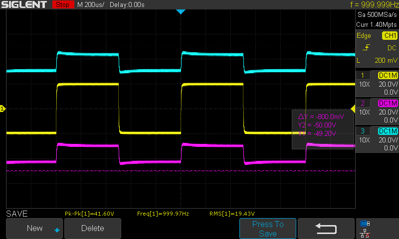

My amplifier board OM2.7.Сhecked together with protection and SMPS SG3525.
Amp Class AB.
Power 100W/4Ohm. +-35V
100W/8Ohm +-45V
Distortions 10W/5Ohm about 0.0005 %.

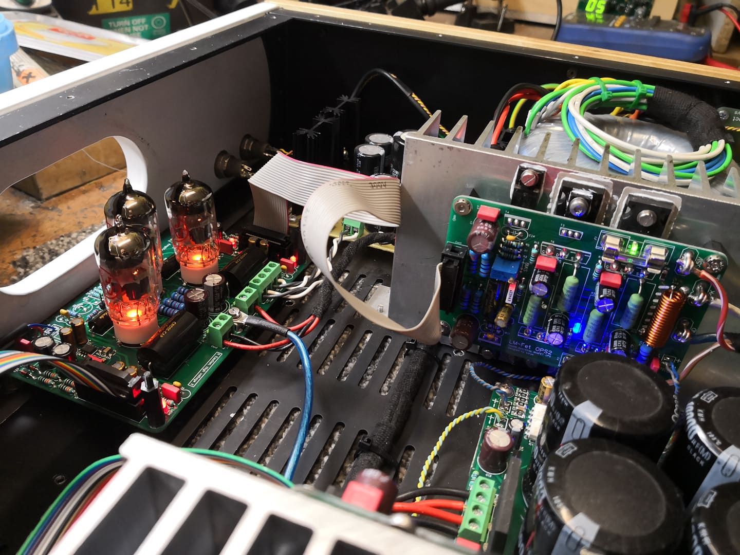

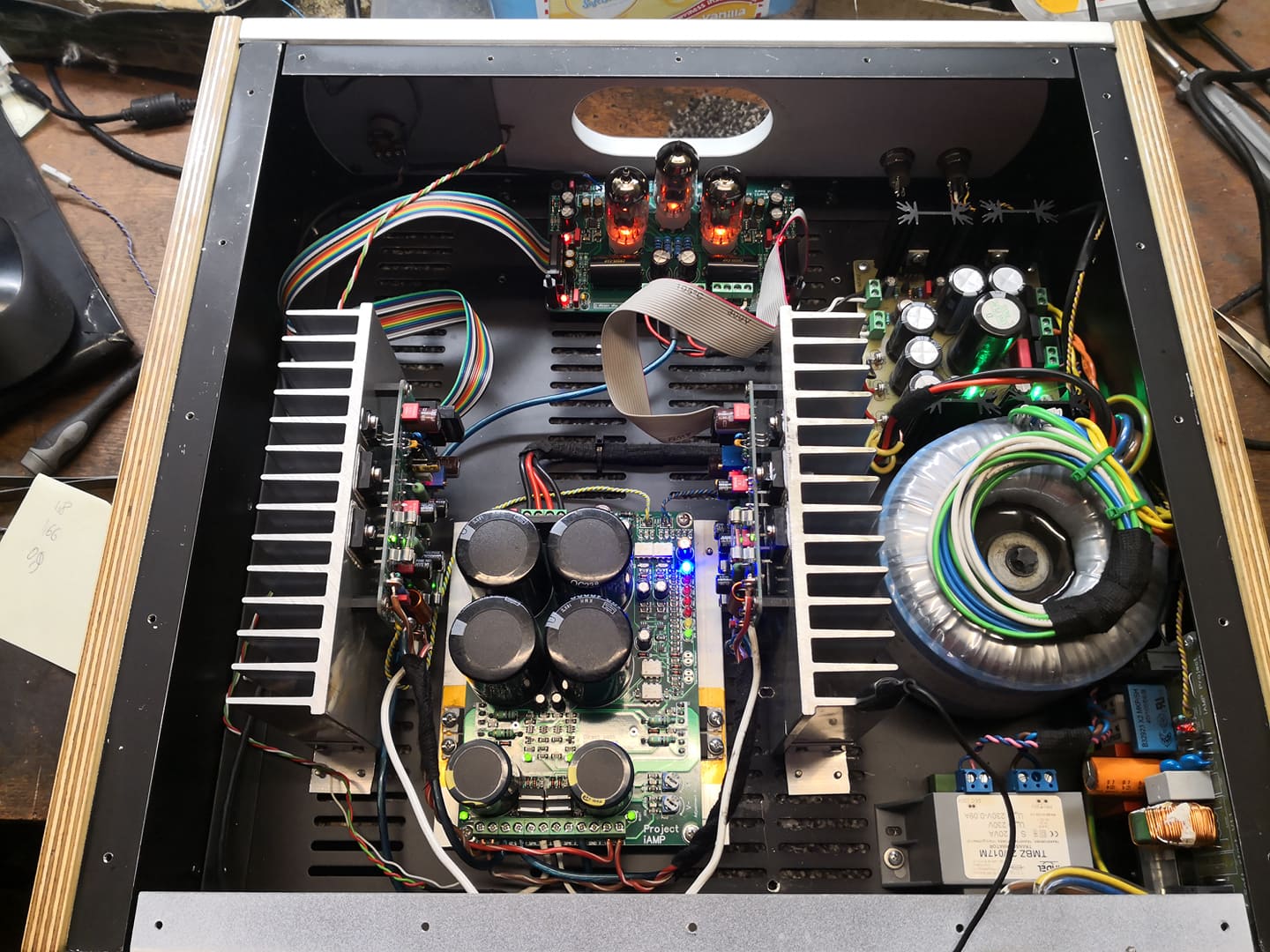

I have made probably over hundred of amplifiers, the new hybrid is in top 90s for sure 😀

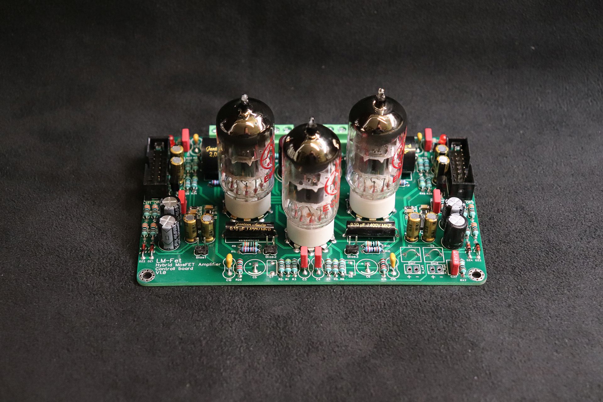

Tube voltage stage does the job very well, tubes should amplify the voltage and transistors should do the ''current'' job.

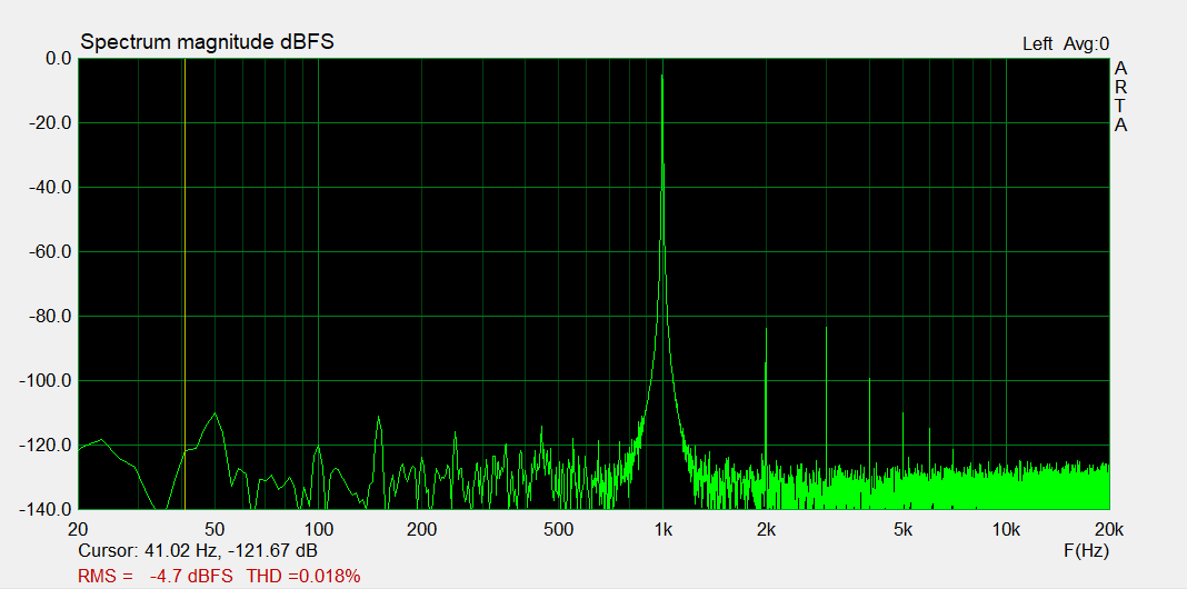

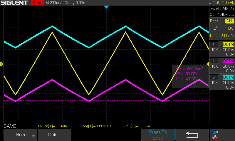

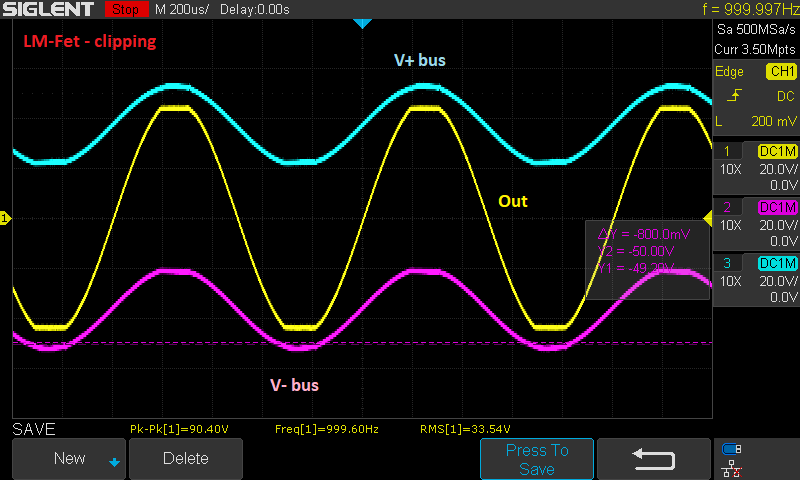

Yesterday I have finished up the LM-Fet project, measured if all is good and listened for couple of hours. It is hard to write any kind of review about own work but must say this one is highly recommended. High current resistor bootstrap does the job better than low current diode one, it adds only about 0,003% of THD in total and allows to drink all of the voltage from the PSU rails, so nothing is getting wasted, just like in a good kitchen. Harmonics profile looks good to me, I was only a bit worried about of higher order order harmonics to appear in FFT grass but they are over -100dB bellow so as for AB class with mosfets and tube driver/VAS it is not so bad at all.

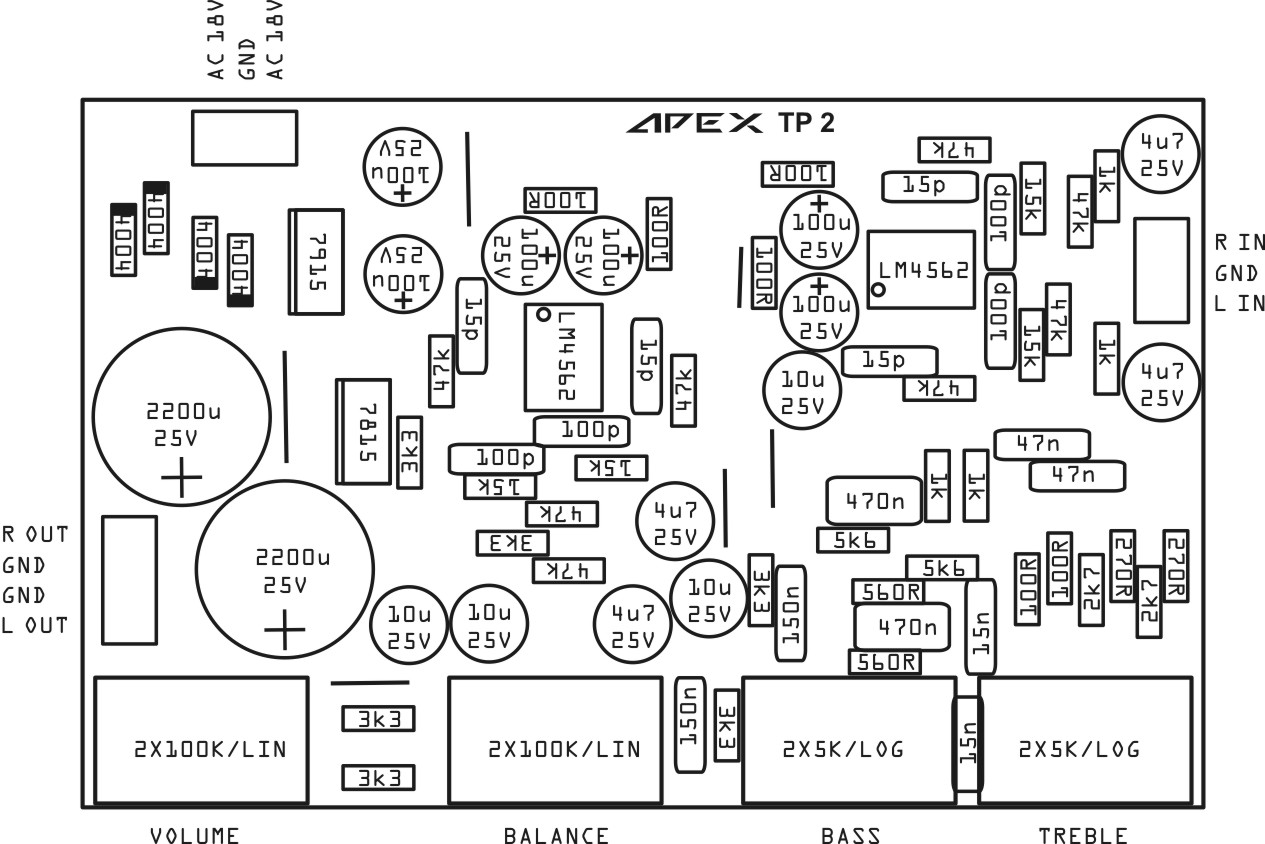

Nice work but preamp is ML3 not TB3.
Regards
Regards
you're right, too many projects in my head🙂

There is TP2 preamp with psu on board

Yes it will be very soon, first I will have to make some ''write up'' job and paste it. The opposite current source drive with 0mA balance works very well.
Bellow schematics of control board, the first prototype.

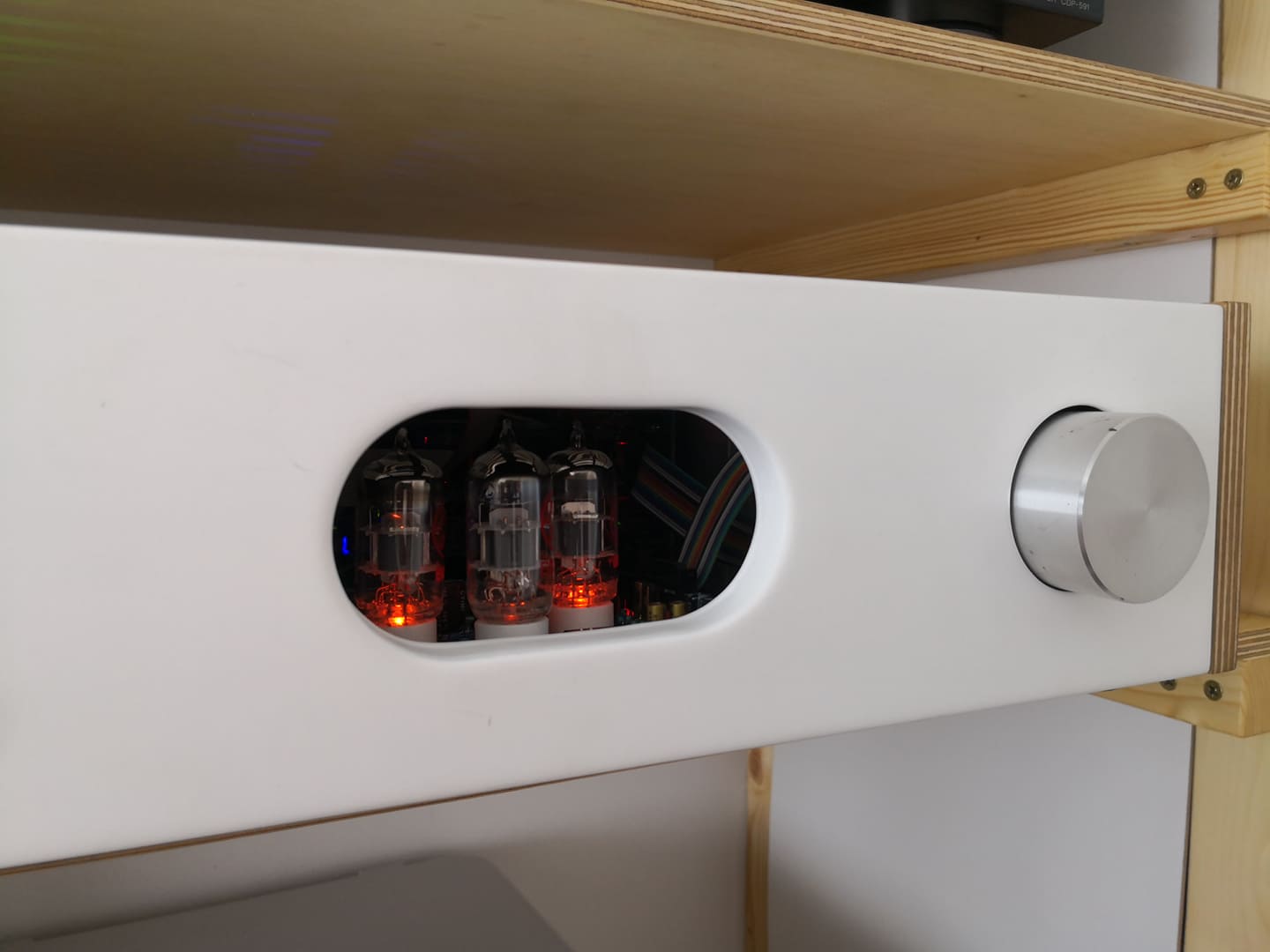

Preamplifier finished 🙂
Looks nice piglet, tell us a little bit about the preamp, and I'm also curious about the output stages.

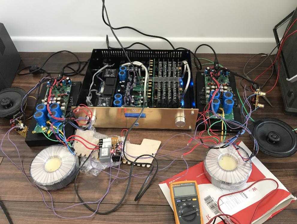

Hi again chalky.Hi Thomas, My board sets have arrived and I'll be picking them up from the Post Office tomorrow ( need to pay some import duty ). I have bought complete semiconductor sets for the four channels that I'll be building. Easy to get almost perfect matches between groups of npn or pnp transistors, but alas npn to pnp matching between any of the complementary pairs used isn't that great. Doesn't matter quite so much for the output stages because of the topology, but would have reduced the raw thd of the input stages a little if matching was better. Ah well thank goodness for nfb! Regards, David
I'm curious to know how your 4 boards are coming along?.

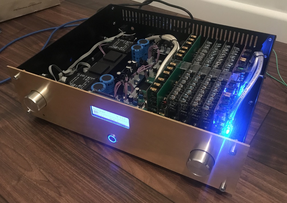

Today I finished input board and power supply with softstart and DC protection, had a faulty diode and some oscillation on input, but it's fixed, input board produces nice sinus and square waves, so I think it's okay.

Yes, I designed all PCB, draw model chassis in 3D CAD and written software for driver. Now I'm able to control only by RC5 remote controller but in the future I will put Bluetooth inside and I will controll everything from smartphone app.
