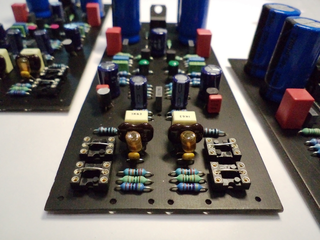

Here is a few pics from my newest toy ..a phono stage form the past with a few small refinements .
Some brief description can be found here http://www.diyaudio.com/forums/solid-state/298164-phono-stage-past.html and since a member has been sarcastic with my drawing skills i think i am going to use that and call it :
The Dotless phono stage ...
At this stage I am playing with variety of hfe and choice of semis and parts
Kind regards
Sakis

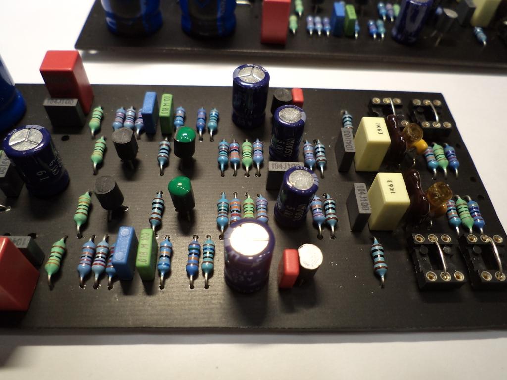

Hand made ( spray paint ) Mark, I am producing a few prototypes to see exactly what semis i am going to use , what grade from hfe aspect , and a bit of mixmatching regarding caps ...
The board is home brew and originally was 2 sides so we had to remove the one side and didn't look nice So spray paint it will be ....
We have ordered nice made boards but will take some 20 days in between id like to complete measuring and define my variables
I like to measure a complete device not simulation ...

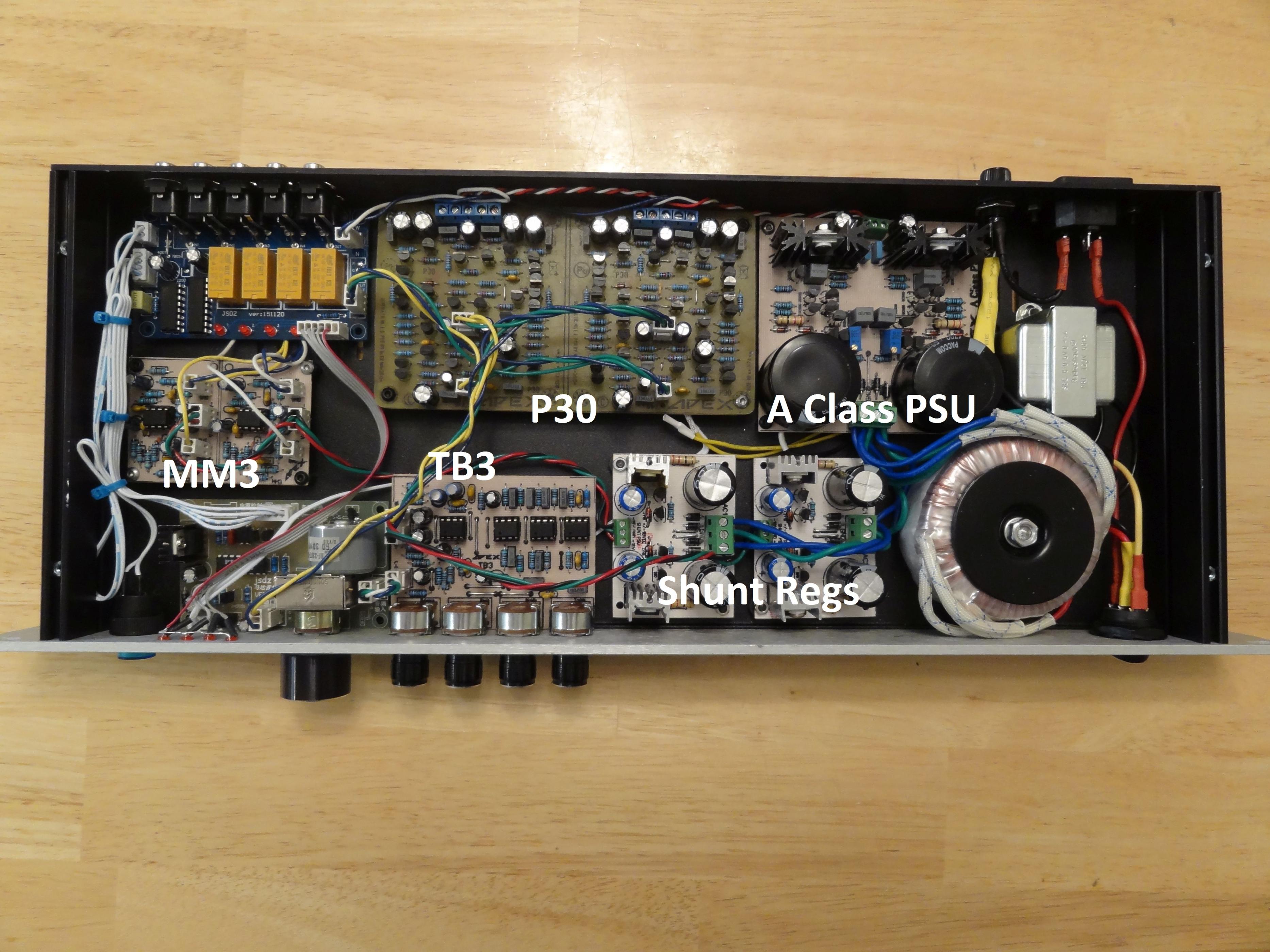

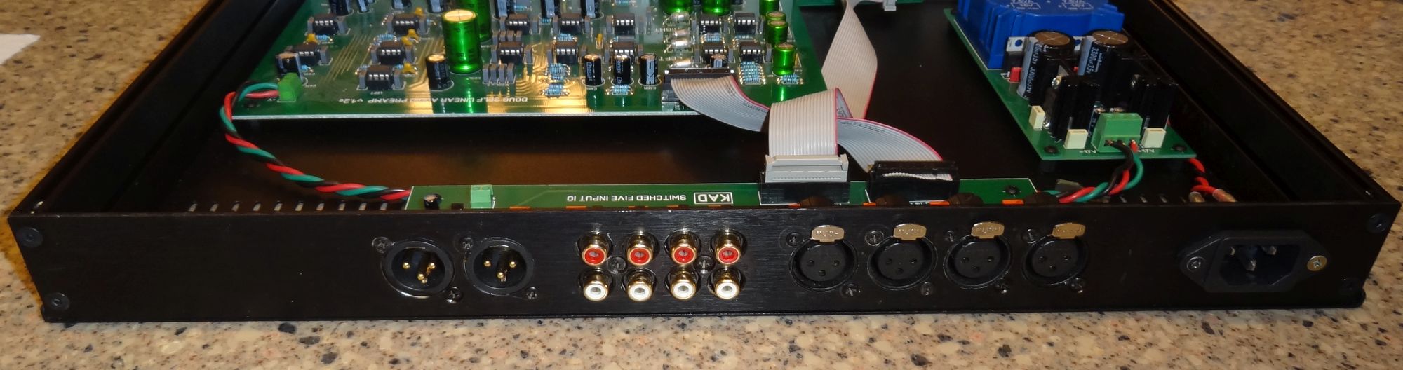

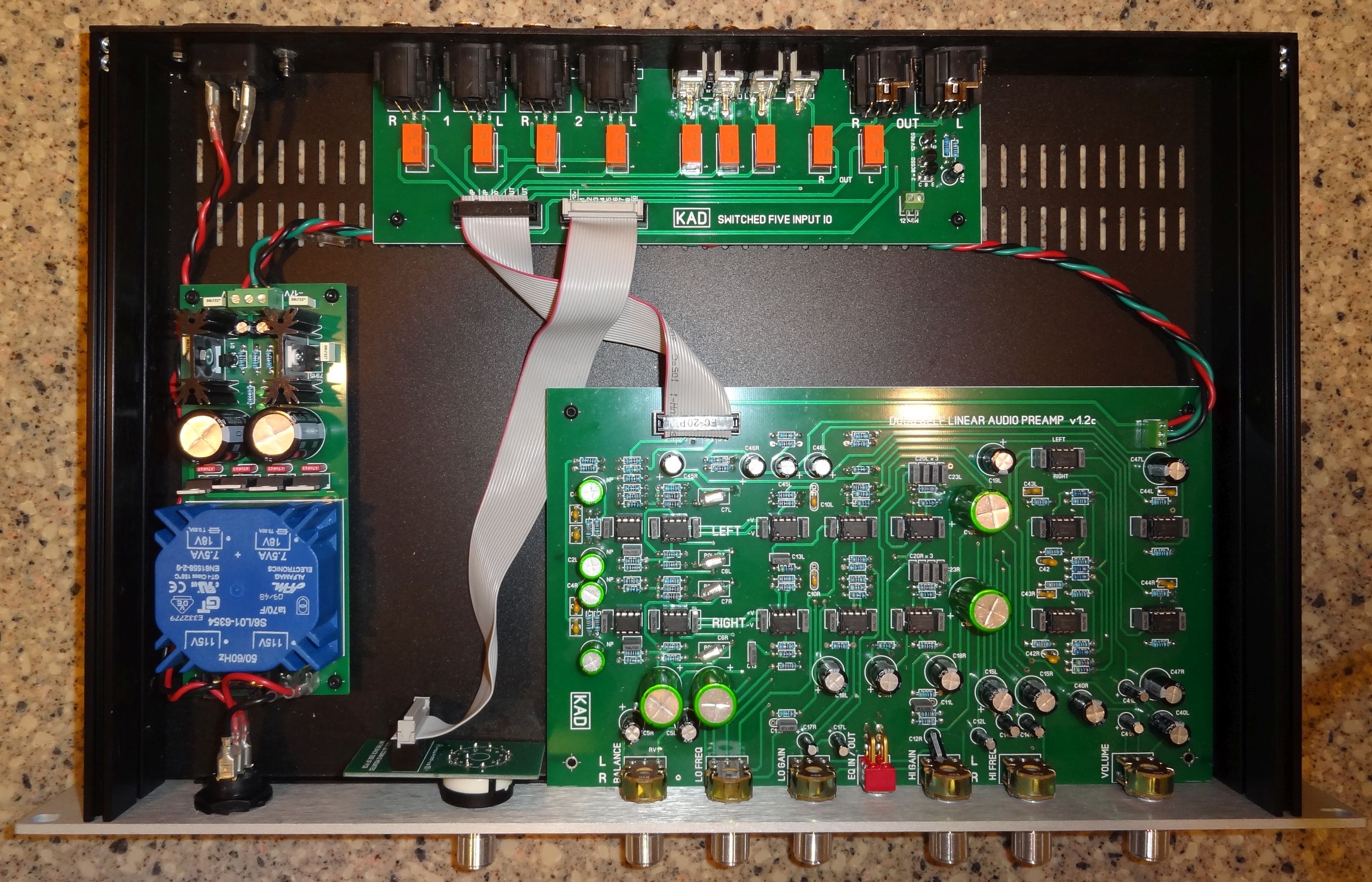

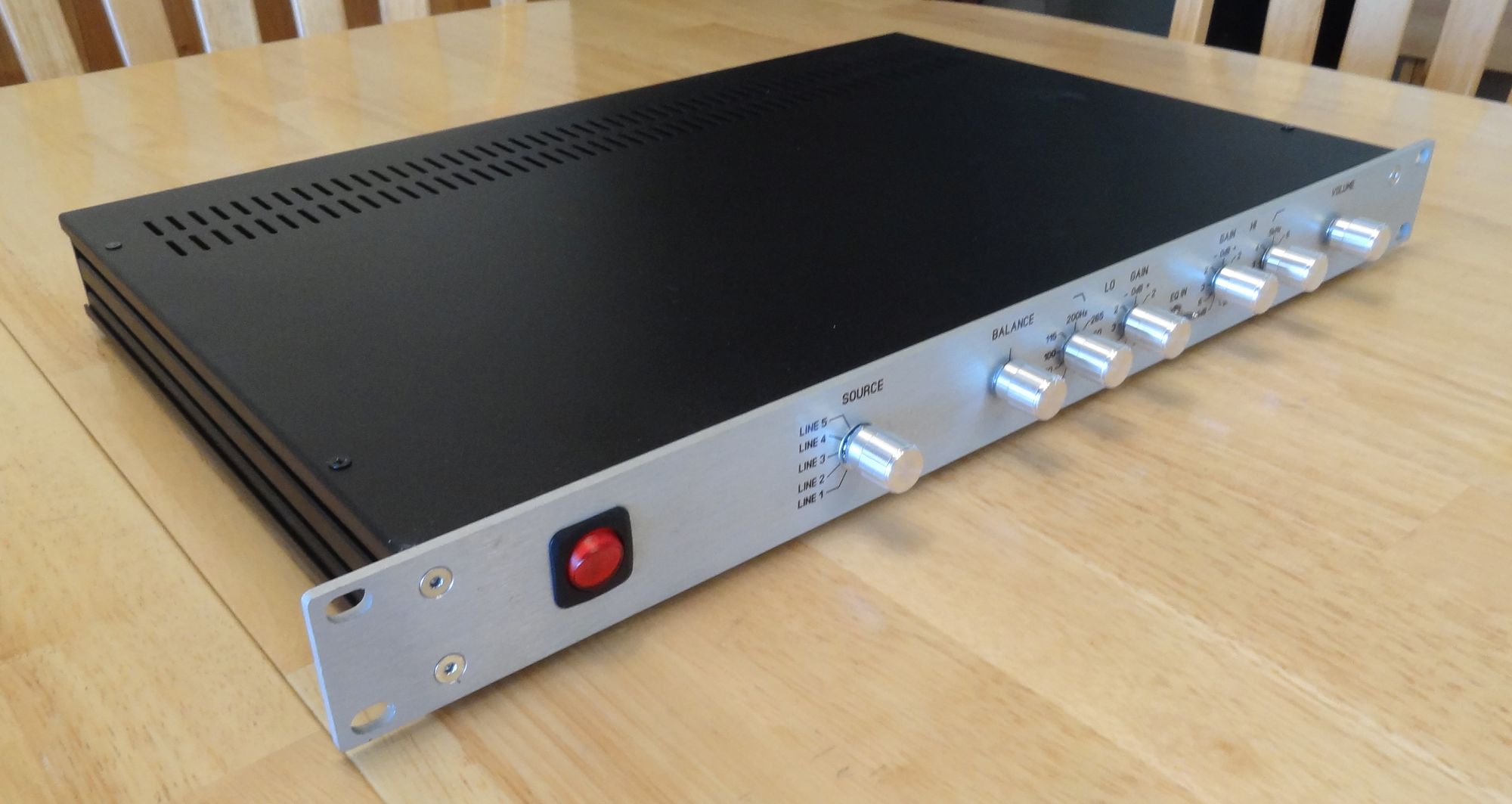

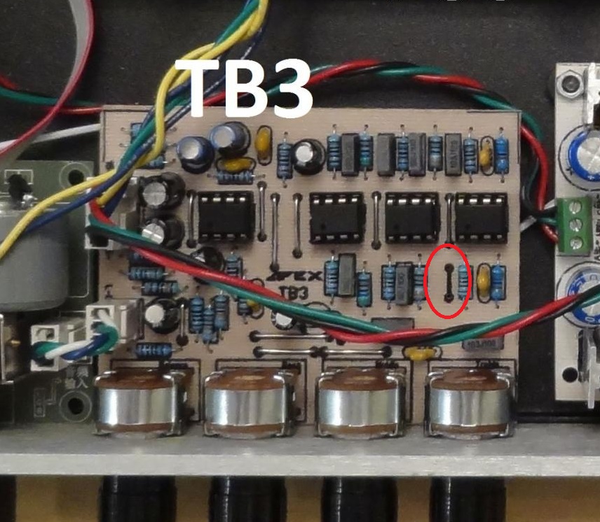

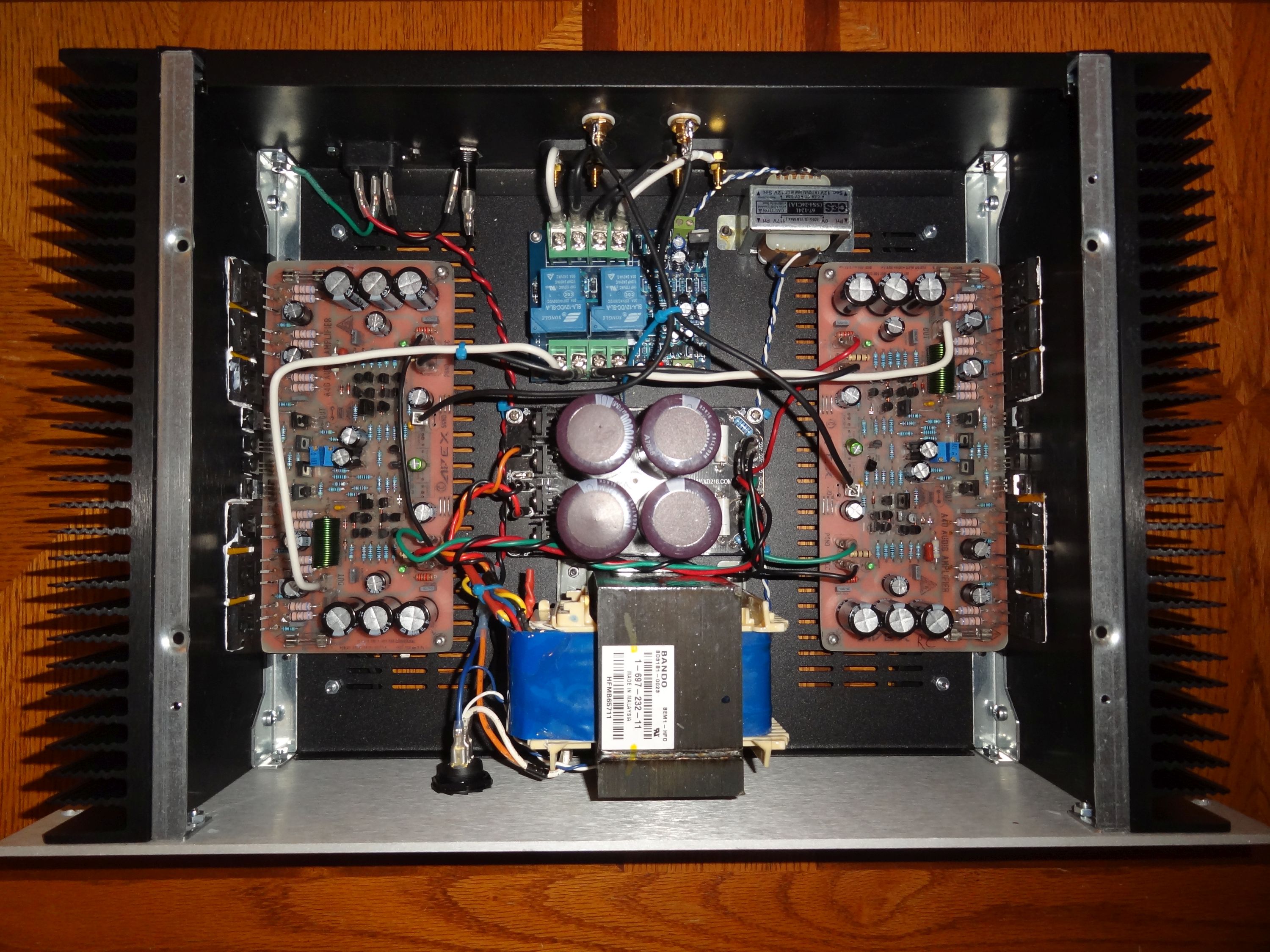

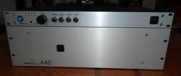

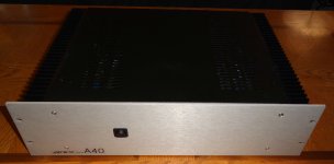

Long time member but first time posting pics in this thread. My son asked me to build him an amp. I decided on Apex designs. I built him a P30 preamp and an A40 power amp. The P30 is all Apex except for the remote volume and channel select. I has a MM3 phono stage, TB3 tone circuit and the P30. The P30 is powered with the A class PSU +-24V, the MM3 and TB3 are each powered by their own +-18 Shunt PSU. For the A40 I used the layout designed by Alex. It is running on +-59V rails. 20,000UF per rail. The cases were purchased from the DIY audio store and I did all the drilling and labeling myself.
The system sounds fabulous and powerful.
Blessings, Terry

How'd you do the panel lettering and what would work on black coloured panel ?
Check out Waterloo engraving. You can get your panels laser etched for almost nothing.

Look like one jumper mising on TB3...
Regards
Regards
Mile's got lynx's eyes!
Yes, i caught that earlier when we were working out the balance control. I should have taken a new picture.
