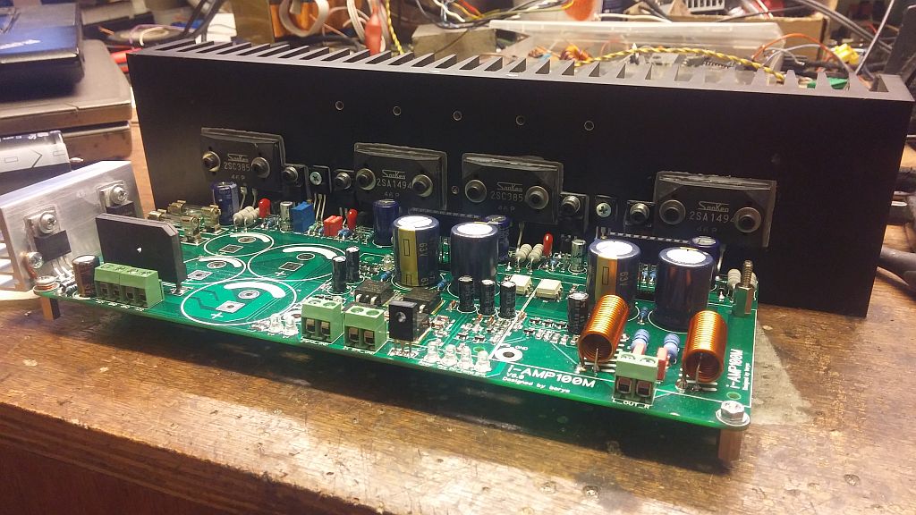

My last project (three of them at the one PCB), very happy that I didn't blowed it up. I was going to test all protections but by mistake it has testet itself 😀

Looks like the modular (V+/PD/O/ND/V-) way has spread like wildfire here on the
forums .
NICE AMP - bet that would match or beat any OEM (or even audiophool) amp out there.
EXCELLENT layout and implementation. (A+++ professional).

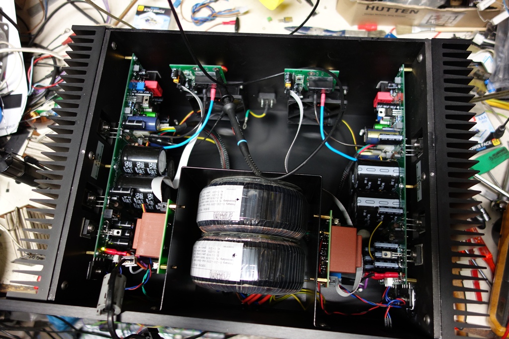

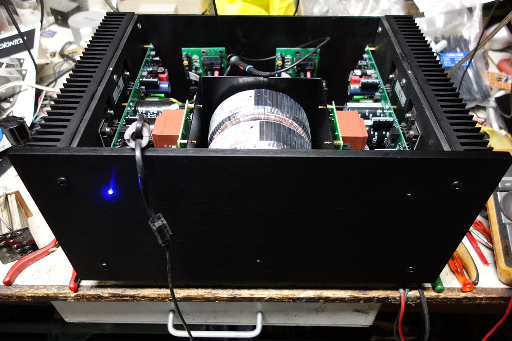

I've been a member for a long time, but this is my first post here in diyAudio.
Here's the amplifier I named Decker, due to the arrangement of the PSU boards. I made it for my little boy.
Nice name, nice arrangement, nice protection, nice amp.

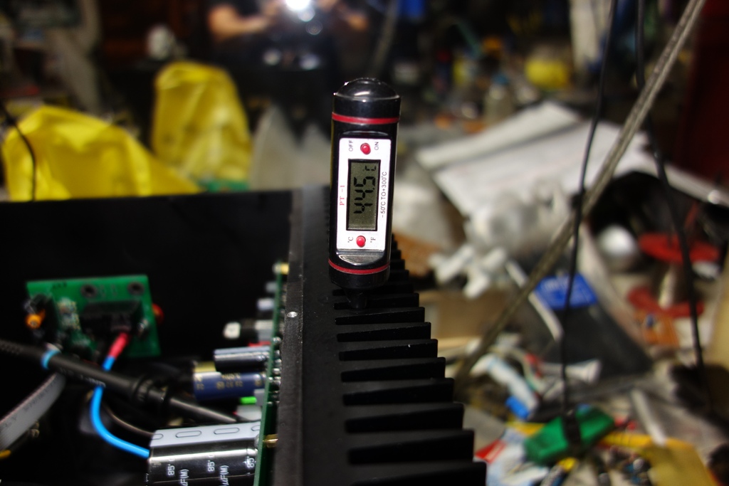

Also nice small heatsinks over the output transistors. But do they really do any better?
Fuses on the left board seem to be slow blow, different form the right one.
Would you share Decker's schematics?
Congrats, little boy must be laughing easily.
Thanks for the very kind words Max...
I did not do thermal measurements with this amplifier. With the 90' angled aluminum bar attached to the aluminum back-plate, it is already sufficient for normal listening levels. The supply voltage is only 50Vdc rail-to-rail at 110mA idle current. They looked good in my class-A amp, that's why I decided to just use them for this amp also.😀
Yes, the fuses on the Left are slow-blow, and so as in the Right.
The final fuses were 3.15A Fast-blow.
Decker is based from Rod's P3A, with some (maybe lot's) of changes.
Leo
