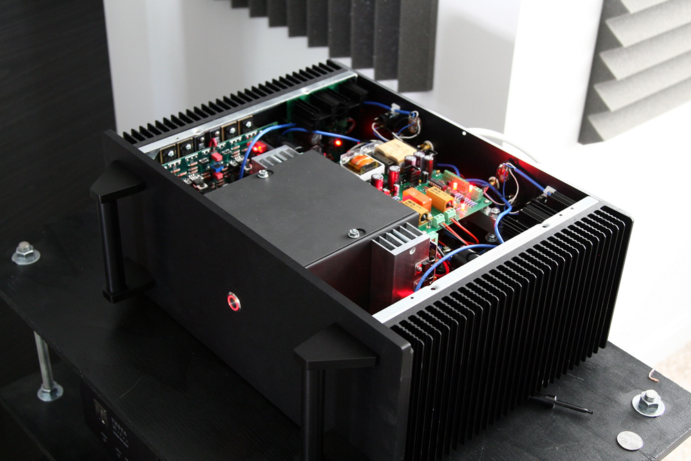

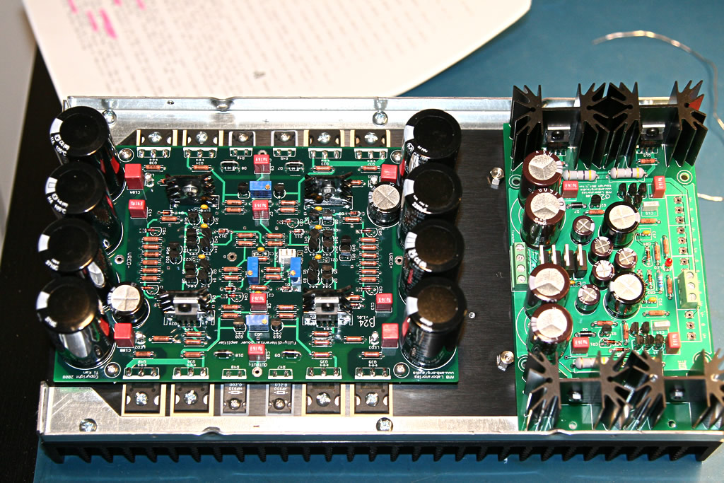

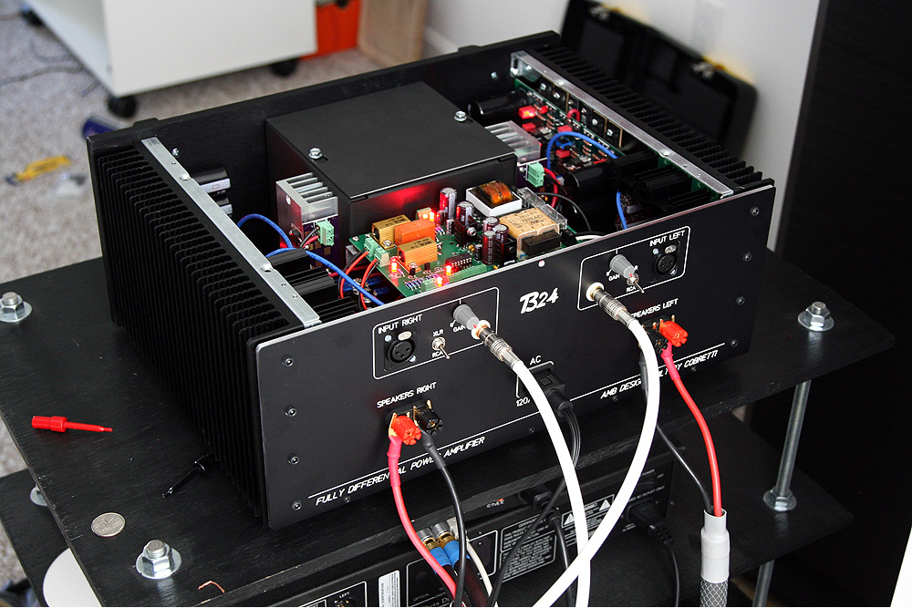

This is my b24 fully differential amplifier - AMB design.
The β24 fully-differential power amplifier
I made my own power supply, slow start and DC speaker protection circuits. I really went to town with total of 6 transformers. 2x300VA Plitrons for output stage, 2x15VA Plitrons for main boards and 2 supporting transformers for st.by and DC protection. The sound is really good with lots of power.🙂

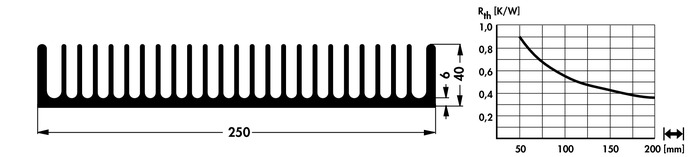

Judging by the iec socket on the back panel those heatsinks are 30cm tall, which makes it 80cm or more deep. At a rough guess he's packing 10kg of heatsink there. Depending on the location of output devices and heat spreaders he could be fine.
Pinocchio what's the c/w for those sinks.
This is a 5U chassis (almost 223mm tall) by 500mm deep. The heatsinks are rated 0.2 C/W (2 per side joined with the plate) and I also added a 12.7mm thick aluminium plate bolted with 22 screws very tight. Don't worry, there's anough metal in there. Worst case scenario I will turn down the bias a little. I don't mind if I have 50-75 watts in Class A and the rest of it in AB it will still be pretty good. But my tests so far seems to indicate that it will be fine.

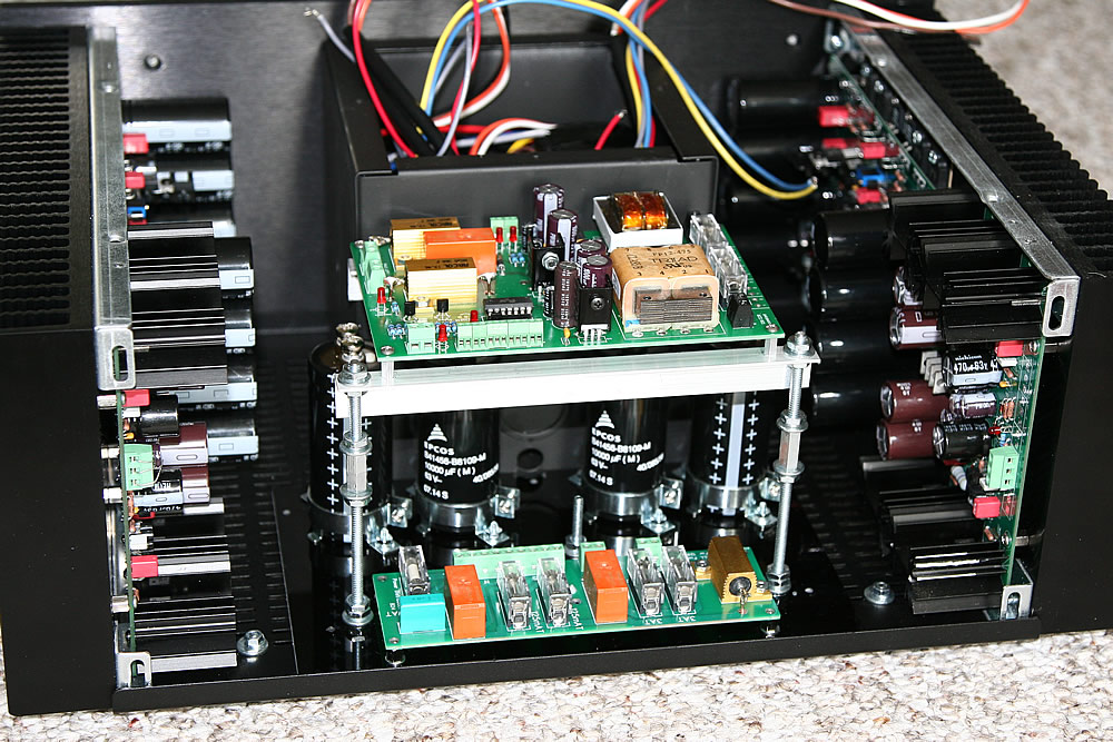

Wow! Very nice build!! I made myself a b24 a couple years ago, I believe you also had started and then waited, Am I wrong?
Anyways, excellent build and yes this amplifier is excellent! I'm actually modifying mine to also use a softstart and remove the bleeder relay and resistors that was in Ti original build (I followed his build).

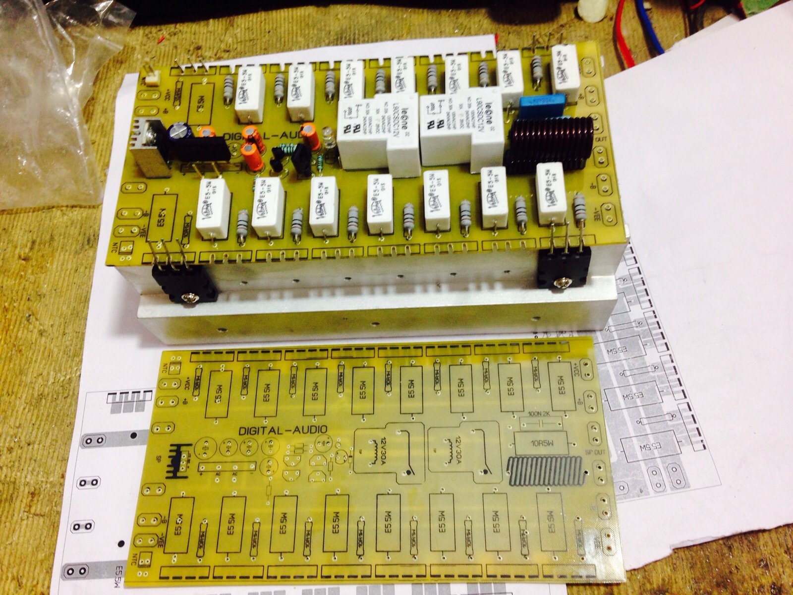

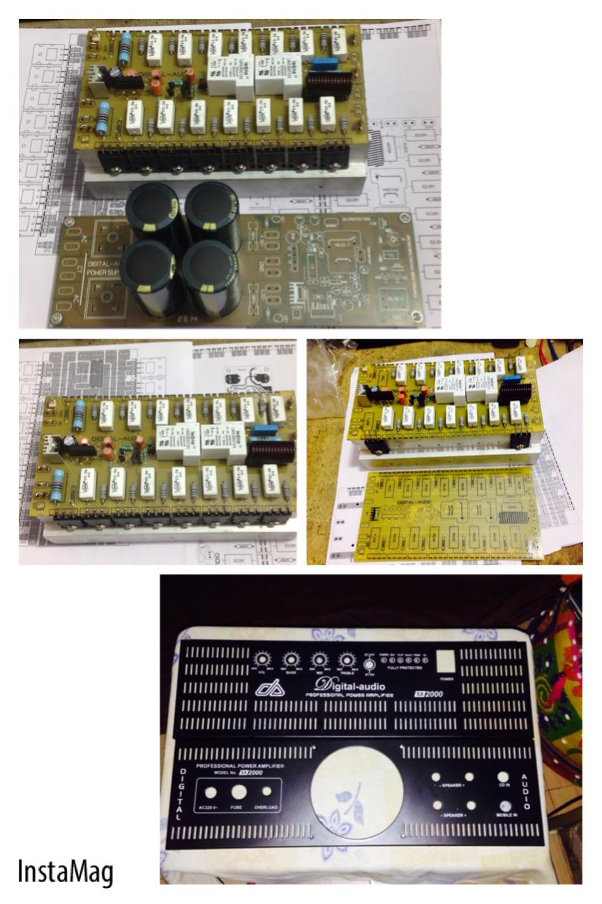

PA amplifier AB class
Hello
greetings trying to make a ab class amp for my friend finished output
pcb 16 pairs of output transistors for mono channel for the dc protection
2 30 ampere relays parallel
warm regards
Andrew😉

My heatsink is much thicker than this. This is not even a 1/4" thick and mine is thicker than a 1/4". The fins are also wavy making them longer than they look.
I did a test with bias to 65W in Class A yesterday and my heatsinks are close to 50 Celcius so I'm guessing I won't be going much higher, maybe 75 Watts in Class A but that's way enough for me needs.
Do
was your chassis closed at the time? and for how long did you let it cook?
The top of the amplifier was installed and it was running for about an hour which is sufficient to know. The temperature stopped climbing after ~40 minutes. Anyways, the 100 watts is a dream but in reality I will most probably put it at around 40 watts in Class A, it gets too hot in the room. In reality and practically, 25 watts in Class A should be sufficient and the rest in AB.
I have to test my comfort level in the room after setting the bias to be at 40 watts in Class A and if too hot in the room bring it down. It will also save on electricity! 😀
