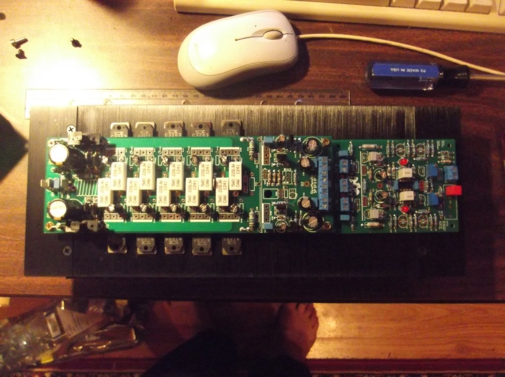

The idea is to get the most efficient heat transfer possible. This is way more important than having the devices run at the exact same temperature - heat kills. I many times have seen devices mounted on a tiny little piece of 1/4" stock that is then mounted to a heat sink resulting in much higher temperature of devices than if mounted in the fashion above.
Good Listening
Peter
I actually did this with 1 pair per heatsink. It did not work out too well.
One pair would always become the "current hog". Thermal stability was never good
until I moved both the pairs to their own heatsink.
PS- on separate heatsinks, the pair with the drivers/Vbe would always run the coolest.
Swapping the pairs made no difference.
OS
Have made 100s of amplifiers this way and have never had an issue with thermal stability, the sinks very quickly become the same temperature. In addition I place the bias FET on the heat sink for thermal tracking, works like a champ. That being said I only use MOS FETS for outputs, Bipolar output transistors may react different.
Good Listening
Peter
Sorry I don't have any links.
Both Avvid, Wakefield and another? have an app note that describes the optimum layout.
I have seen more, but it was such a long time ago.
If I remember nearly correctly, two rows are roughly 25% up and 60% up from the bottom. Note how close the upper row is to the middle.
Remember that the holes generally do not coincide with the centroid of the heat transfer interface, unless you use clamps.
That would be good if I had a 5U heatsink. I live small , just a 3U 140 X 360 X
60mm. (below).
Here I would have either 3 pair MT-200 or 5 pair MT-100 , not much room.
On this one the P channels would be at 25% , N-channels 75%. If I dropped this to
15%/65%, would I see a massive difference ? I would still have hotter N than P
devices , regardless ??

optimum is not a lot cooler.
It just a bit cooler than non optimum.
moving the two groups down slightly will bring the top row temperature down closer to the bottom.
I don't know whether 20% 70% is right or 15% 65%.
software that lets you experiment with a model would give a better clue than me guessing.

It does matter.
The top row of devices will run much hotter than the bottom row devices.
10degrees will make a big difference to temperature de-rated SOAR, if you are running at Tc=70°C that becomes 80 for the upper row.
If it were Tc=50°C that became 55, then there is not much difference.
