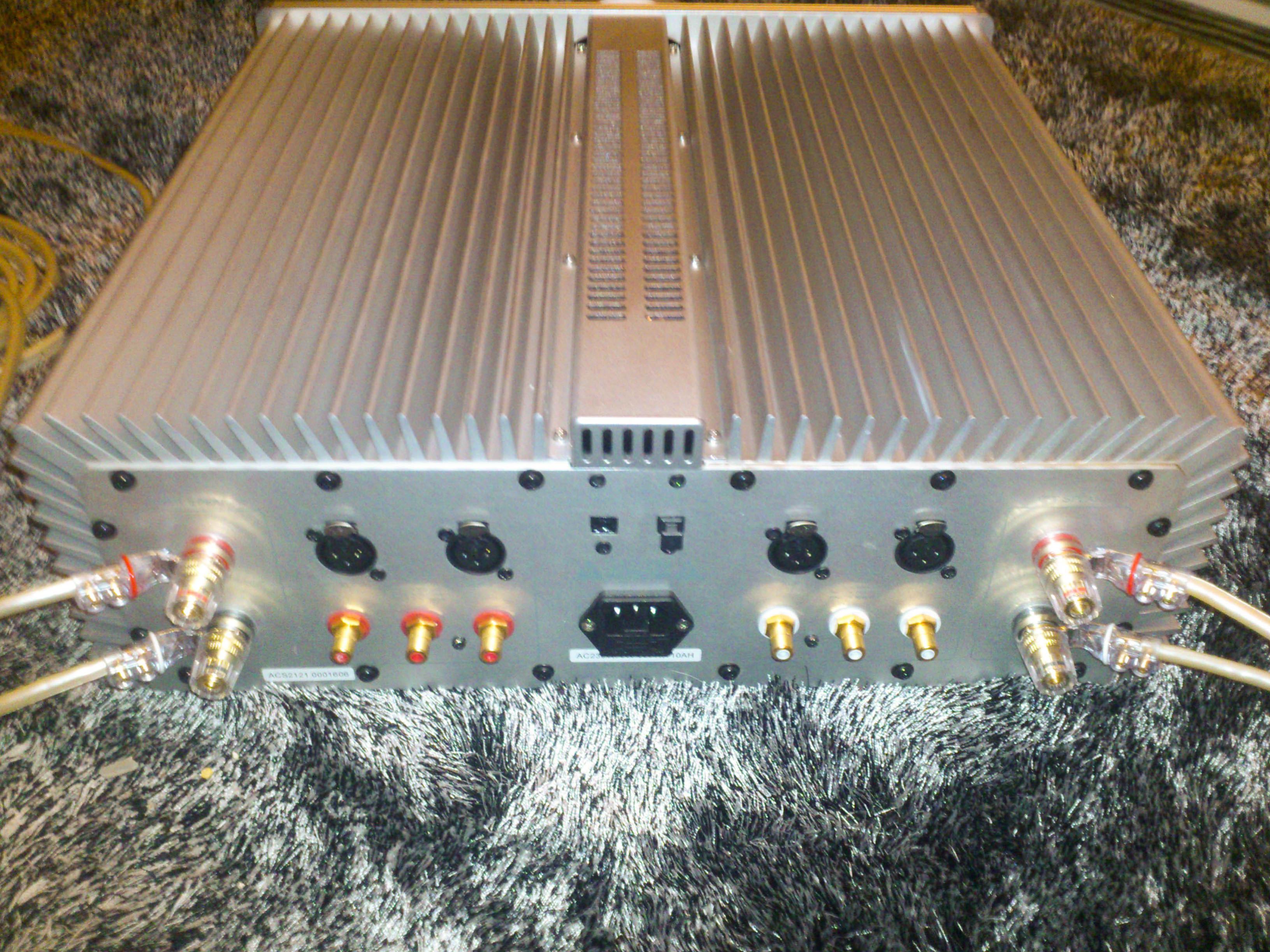

I finished it this evening, at least all the analogue stuff. Still waiting on a couple parts for the fan controller and air filter, so that's running full speed at the moment and annoyingly loud.
When I originally visualised the layout I didn't imagine so many damn wires!
Metalwork kind of hides the ugliness:
And here's one speaker assembled:
I had a quick test of it tonight but haven't cranked it hard yet. The active crossover is an incredible improvement and far exceeds my expectations even though I've done no calibration or time alignment yet, merely set the three different gains to correct for the nominal driver sensitivities. However, my noise floor is horrifically high. Some of that is no doubt (there is a tiny hum) due to my shitty shitty cabling, but there's also much more noise coming from the DCX than I expected.
The puzzling thing is that when I tested the amp on a normal (3-way passive xover) speaker, it was NOT particularly noisy. Plug it into the ones it was designed for and you can hear the hiss from at least a foot or two away.
One thing that occurs to me is that with an active setup like this, all the gain control is way up the front of the signal chain whereas the classic arrangement is to have a volume pot right before the amp input; at low volume levels that pot eats all the noise from the earlier stages. I'm not sure how to get that kind of noise reduction at low volume back without implementing way too many (18+) attenuator boards.

...However, my noise floor is horrifically high. Some of that is no doubt (there is a tiny hum) due to my shitty shitty cabling, but there's also much more noise coming from the DCX than I expected.
Are you using Behringer DCX? They have a high output level and are known to be noisy. Attenuating before the power-amps is definitely the way to go, as you have allready found out.
If your cabling is shitty you don't get noise... you get hum!
Try the attenuator for Aleph P times three, or take a look at dantimax.dk or twistedpearaudio.com Twisted Pear is showing thier attenuator boards out of stock, but contact them, boards may be coming soon.
Yes, DCXs. However, there's plenty of noise even before I plug them in. I haven't tried shorting the inputs to see if that silences the output - if it doesn't then I don't think that putting attenuator last will help much.
There is a buzz more than a hum actually - 100Hz fundamental but most of the energy is up past a few kHz. I think I need to put transformer snubbers into it - in fact I'm sure I need to as the 240V cable runs around 2 sides of the box in order to reach the power switch, soft start and remote-start/thermal-shutdown relay and when it radiates rectifier noise that's been multiplied up, it'll get into everything.
Given that I'm a lazy bastard and don't want to build a Quasimodo, are there (formulae for) default RC values I can go to that will get me 90% of the way there?

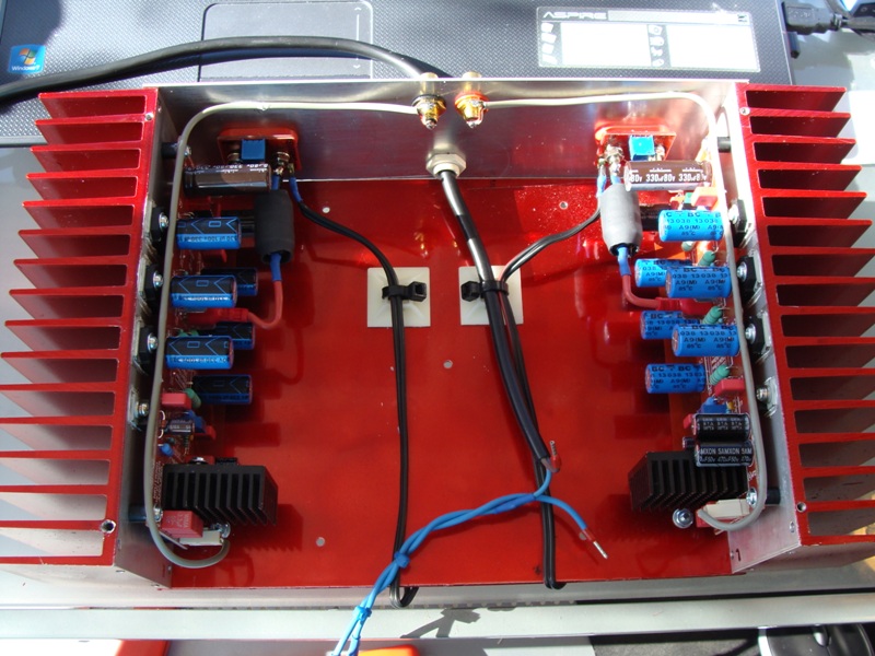

Looking at your image of your amps I see a possible reason for your hum: Your ground path!
You have put the ground star closer to the input, and not - as it should be - close to the output.
Quick fix: isolate the joint where the input ground, the input transistors and the feedback path goes to ground - keep these two/three joined and lift it from supply ground via one 100 ohm resistor.

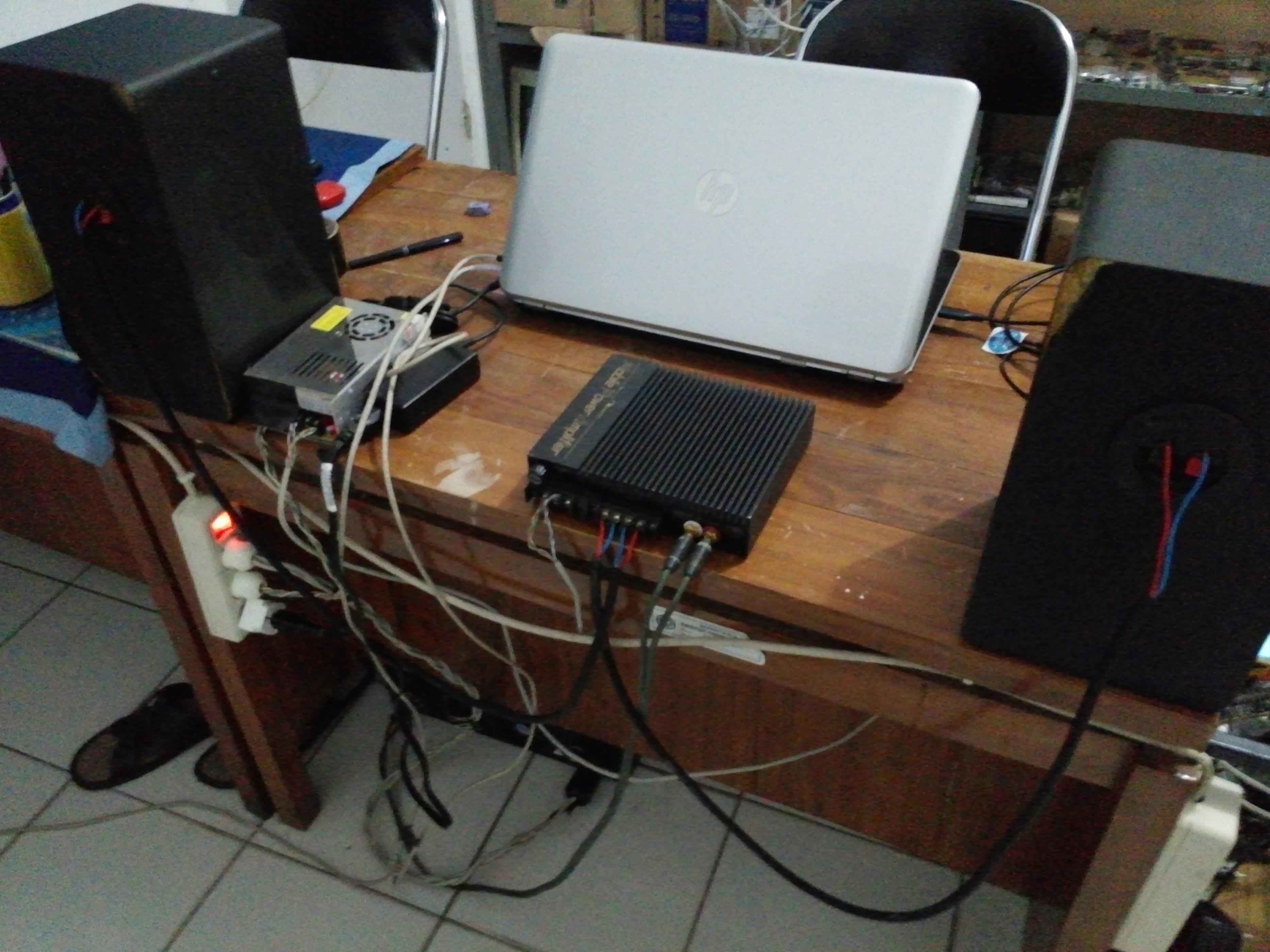

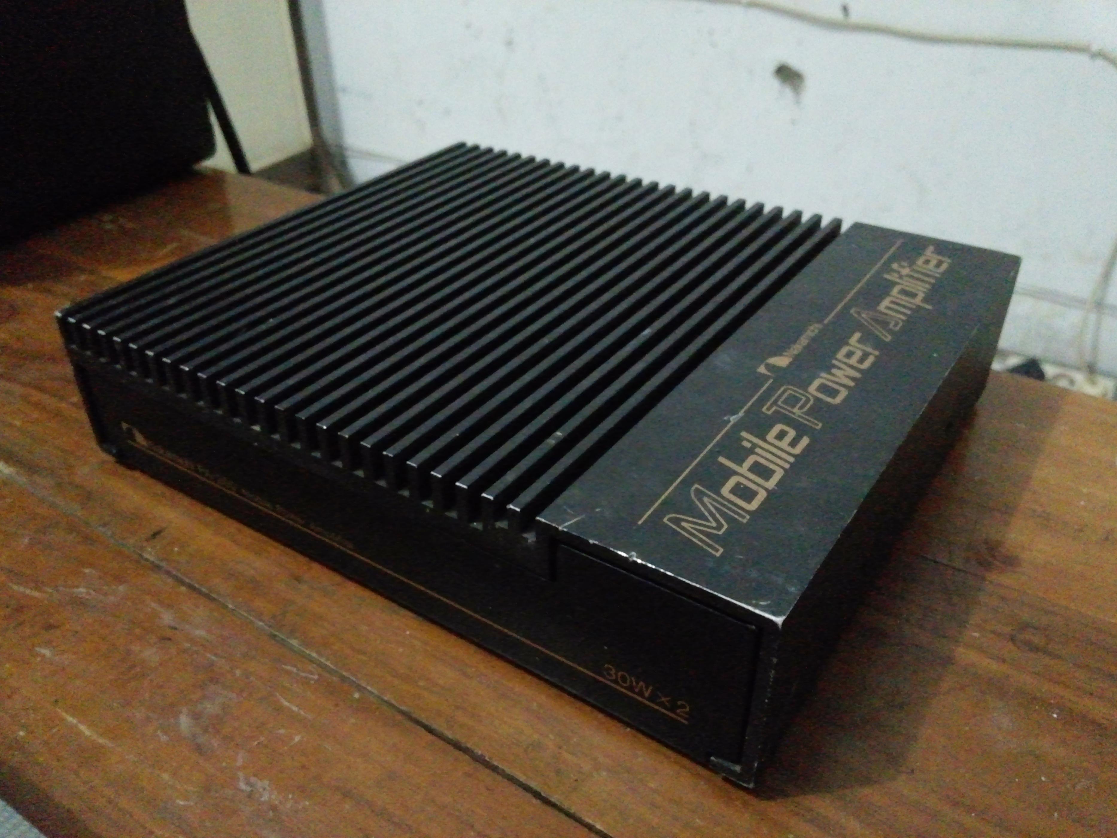

here is my amp..Nakamichi PA-200 re-capped, some little upgrades, and runs on class A..source was from my laptop using USB DAC 🙂
it's a car amp but sounds pretty good!
i actually have a krell clone but since i worked out of my city, this one becomes my main system 😛

That's not the main earth star you refer to, it's a subsidiary star that earths the input shields and heatsinks only and therefore carries no current except for noise induced on balanced cable shields, which is why it needs to be next to the input. The power star is right above the transformers, behind the terminal strip.
I had previously set my amp input gains so that it would clip at about +0dBu in, i.e. a total power amp gain of about 27dB. I wound them down as far as I could (-12dB) which obviously helped the noise immensely. You now need to be within 1m to hear the hiss whereas previously it sounded like rain from 3m away when the DCX was powered up. Once I put in transformer snubbers, I think it might be quiet enough and if not, I'll do the PGA2310 thing to push the DCX noise down further.

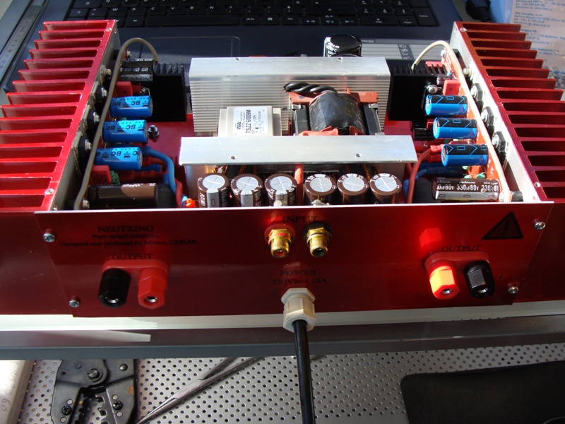

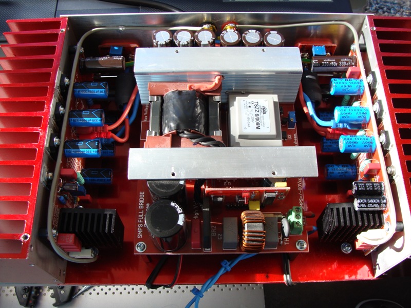

Very nice! the only thing I would "modified" is I would turn around the boards the way the inputs from chassis will be "closer" to the boards.😉
-Amplifier based on LME49830 power amplifier driver.
Output stage-3 pairs matched NJW3281 & NJW1302 ON semi.

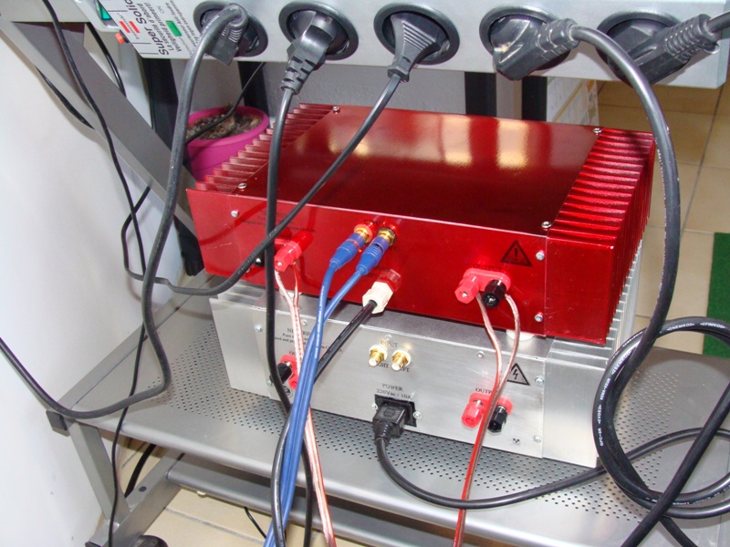

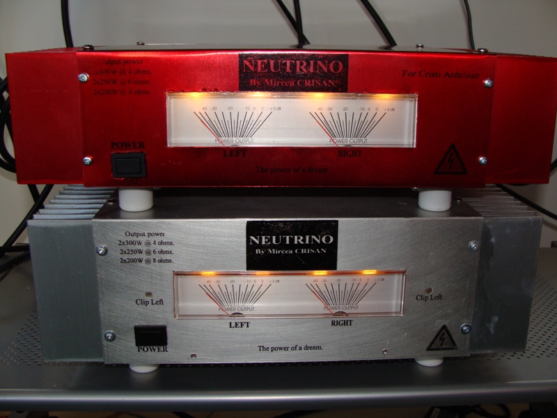

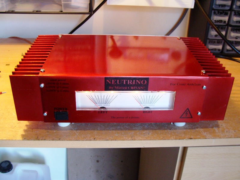

Ferrari red, like it.
Nice bright red. Great job.
Great way to attach the output inductor !
How hot does the heat sink get when playing loud music ?
For best thermal solution , nothing beats the black anodised aluminum fins. But coloured fins will work OK if they are oversized.
