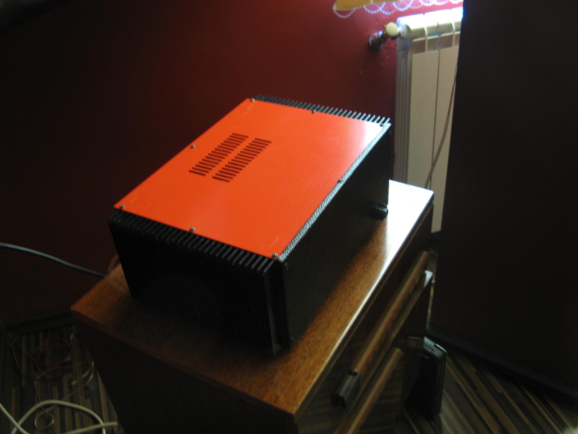

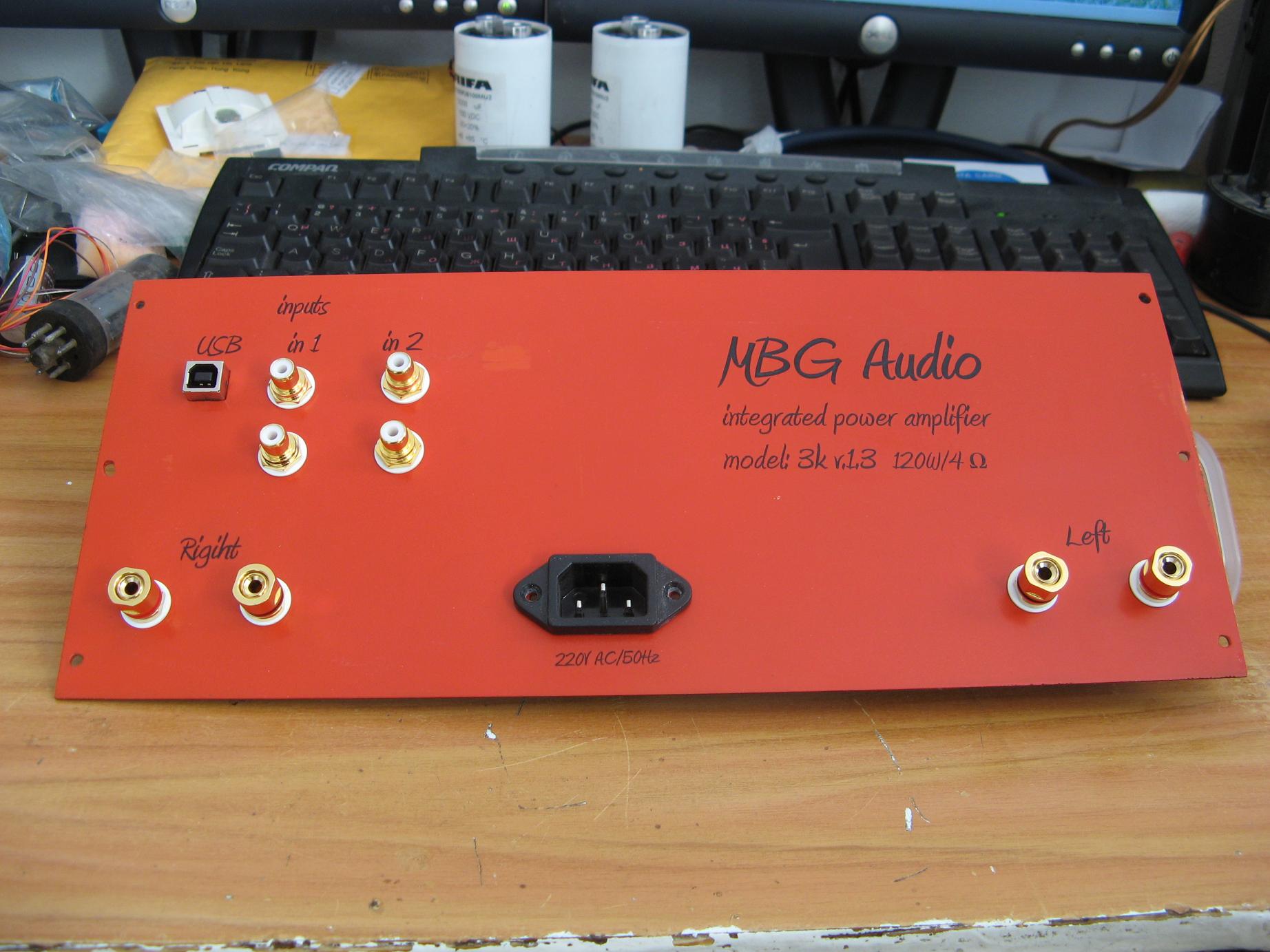

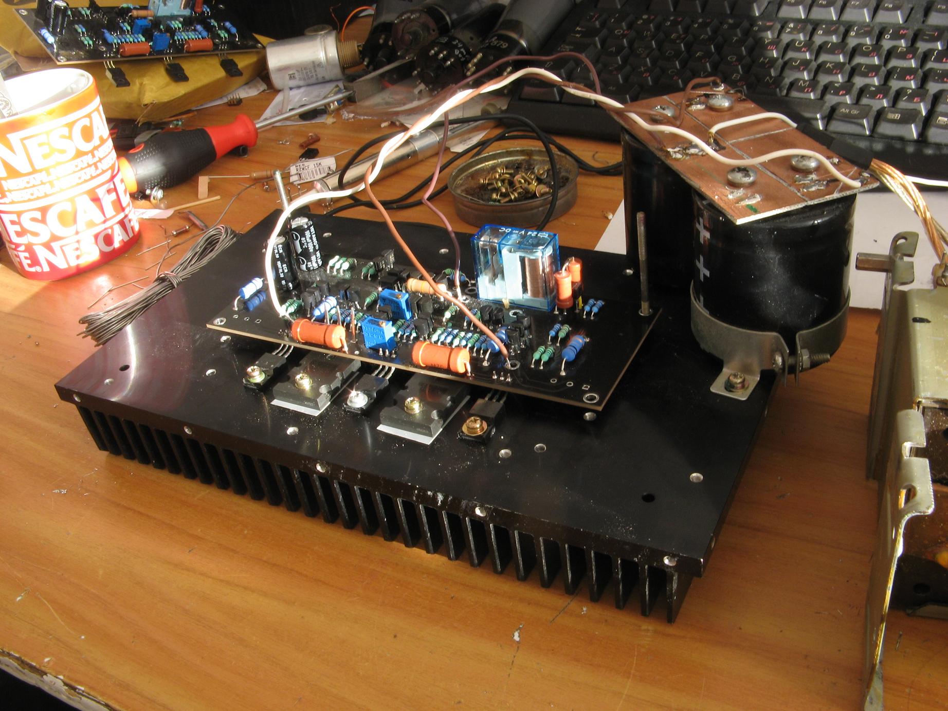

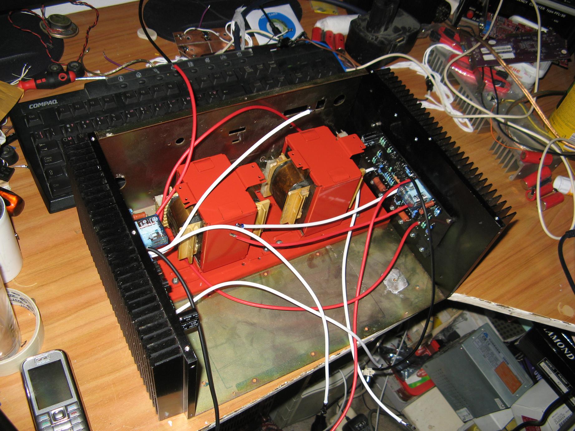

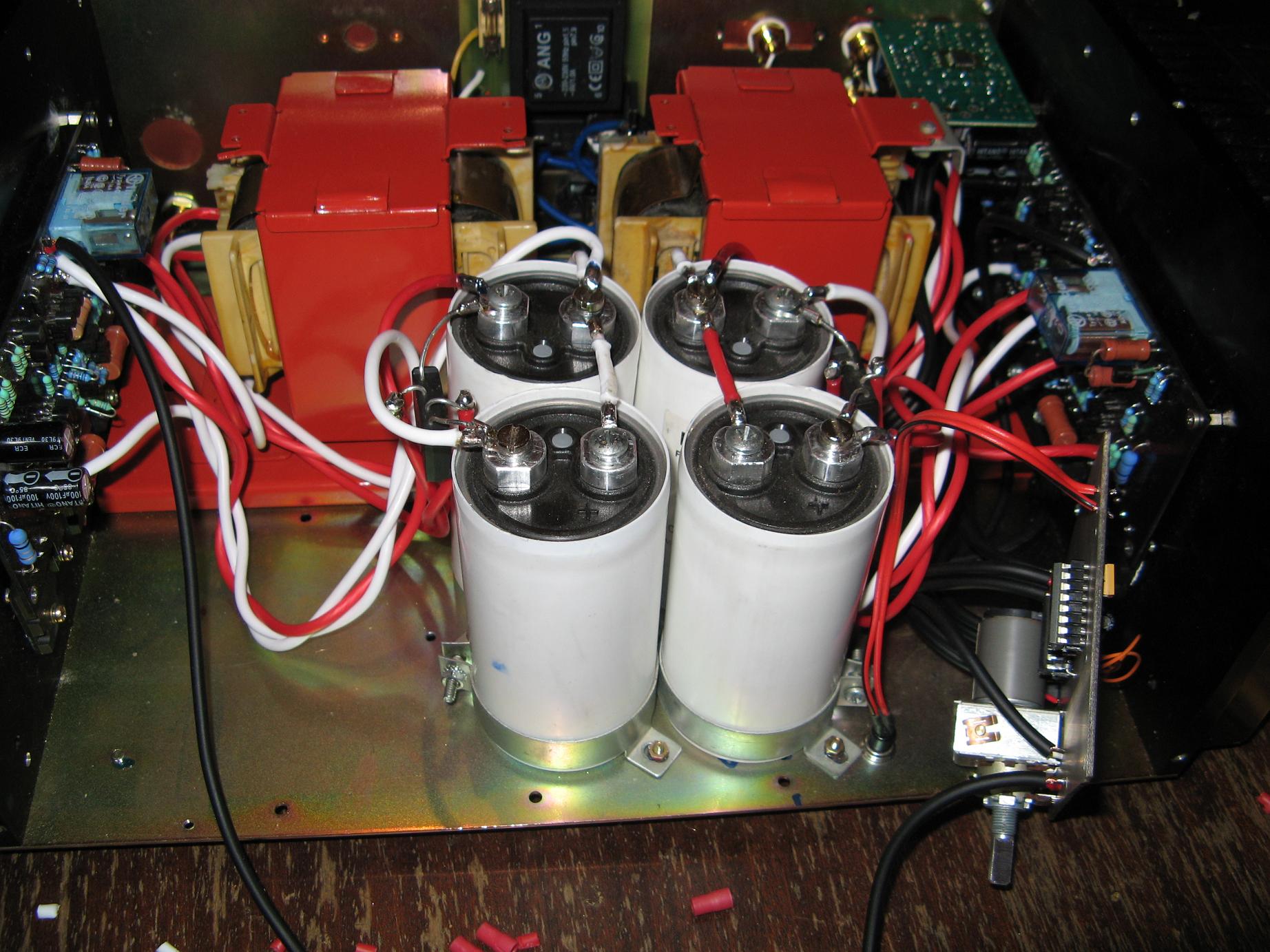

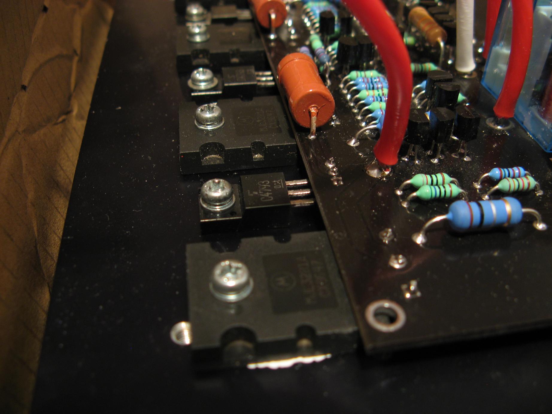

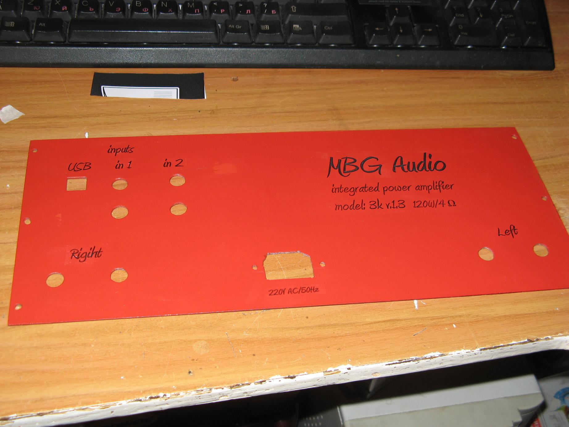

2x120W/4ohm dual monoblock full DC amplifier with integrated PCM2706 DAC.

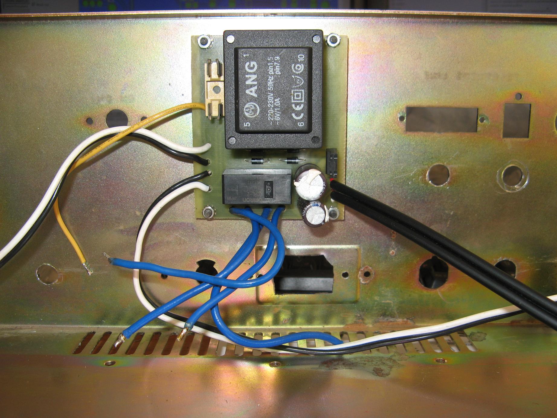

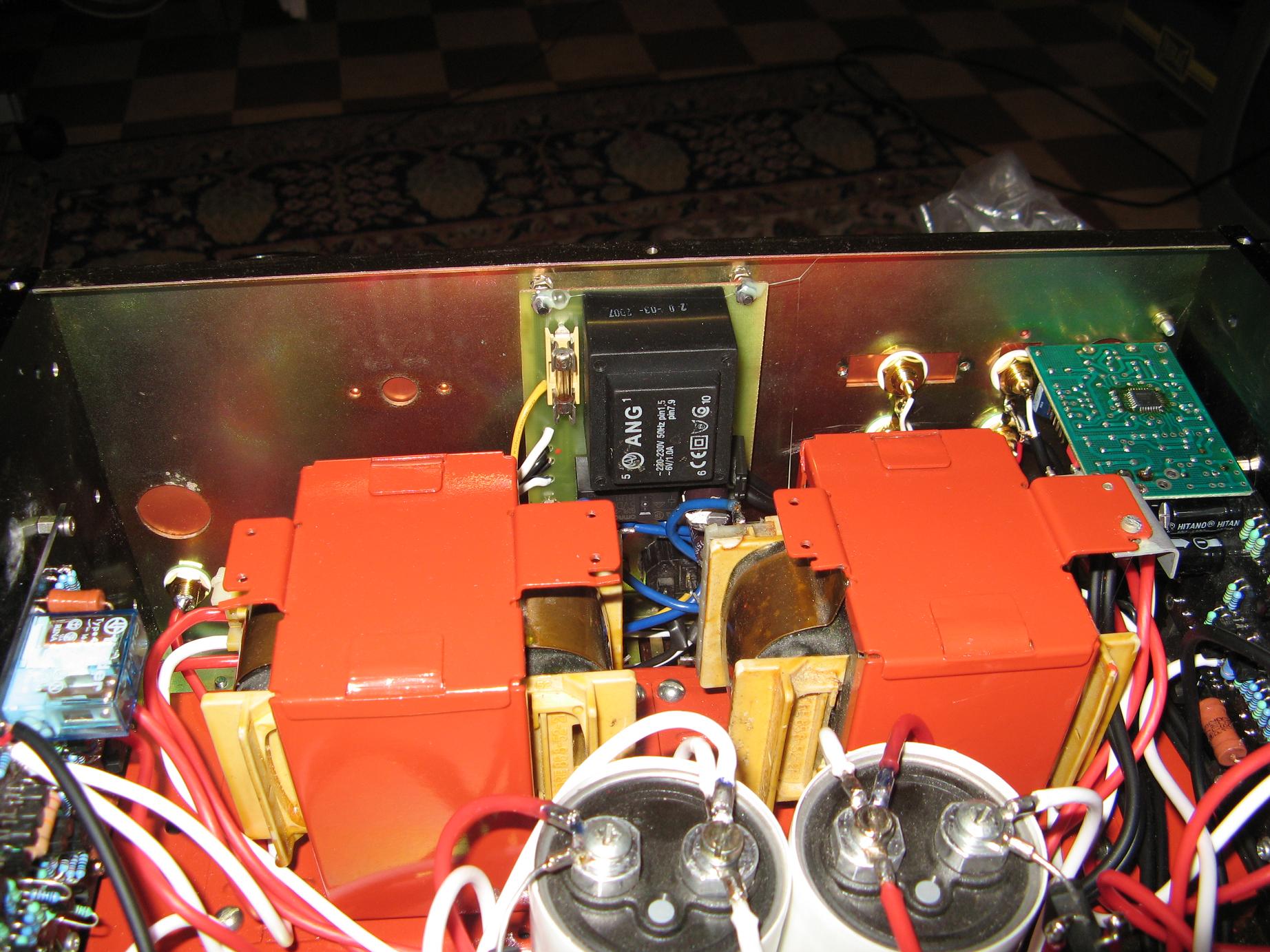

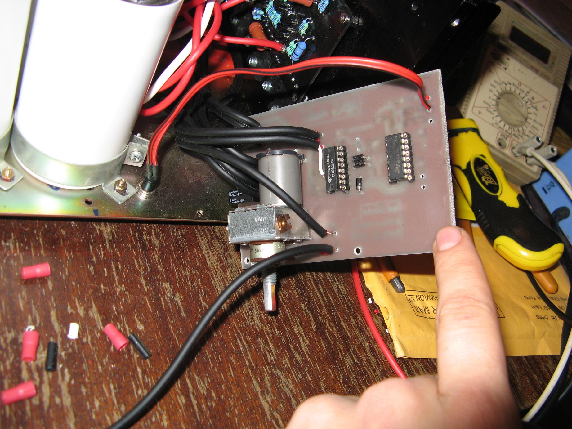

The input selector and "power on" are by one switch, I have modified this schematic - Step Switch Selector
Just connected Q4 to pin 15 (for three inputs) and have used ULN2003 for relay switching instead 4066 + diode logic (summing all three input relays) to fourth relay - this for power transformers. That allows to switch all three inputs and power on by only one push button. It has also mains power off switch.

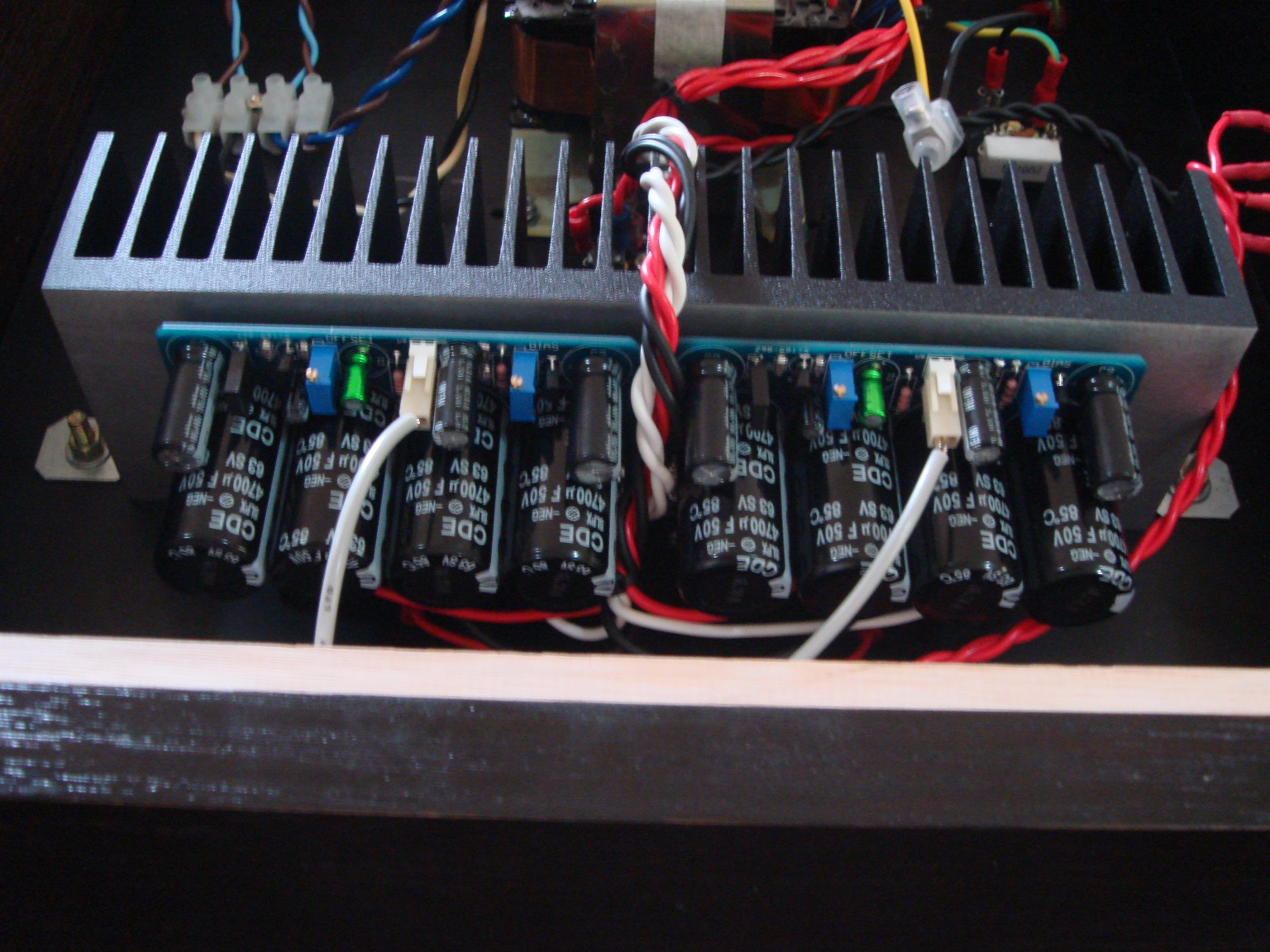

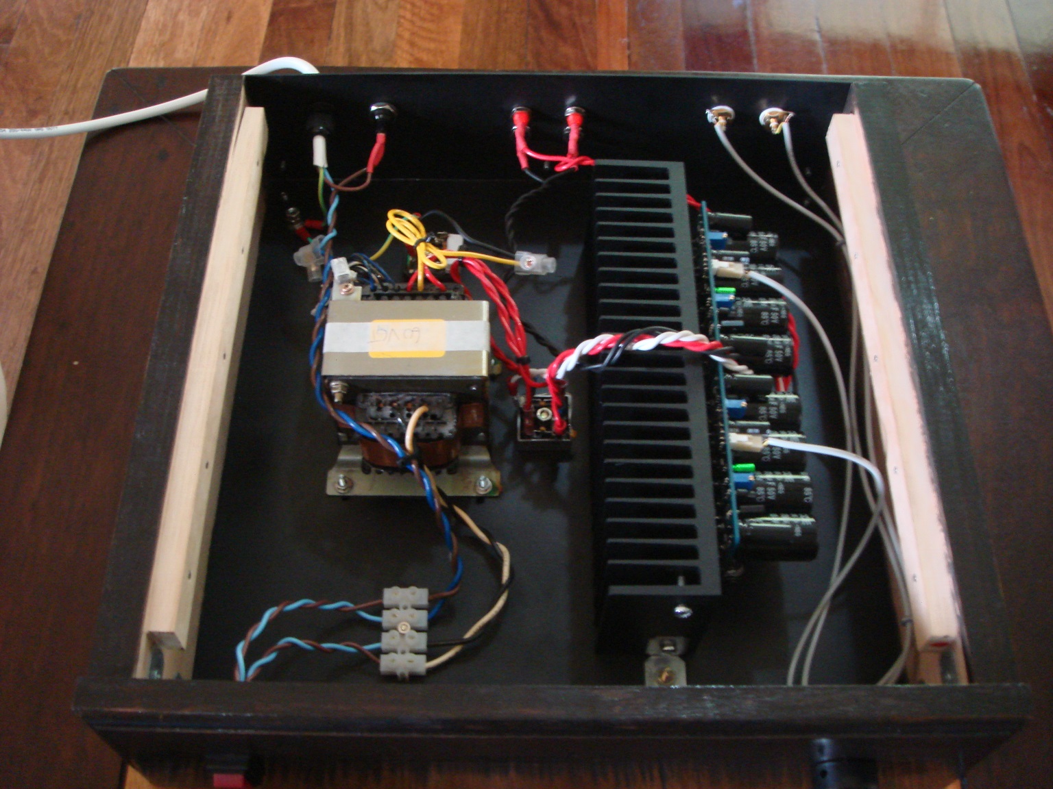

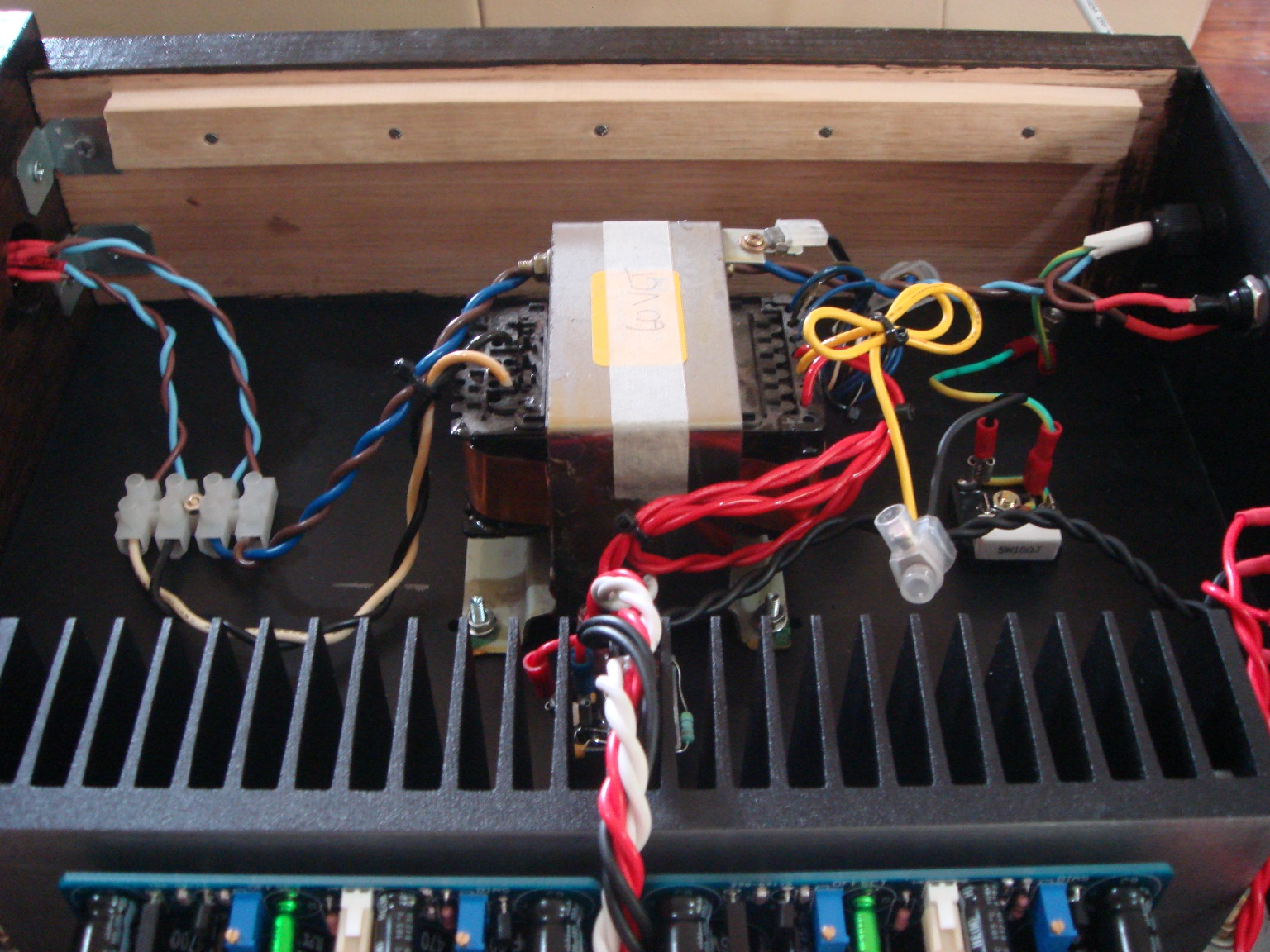

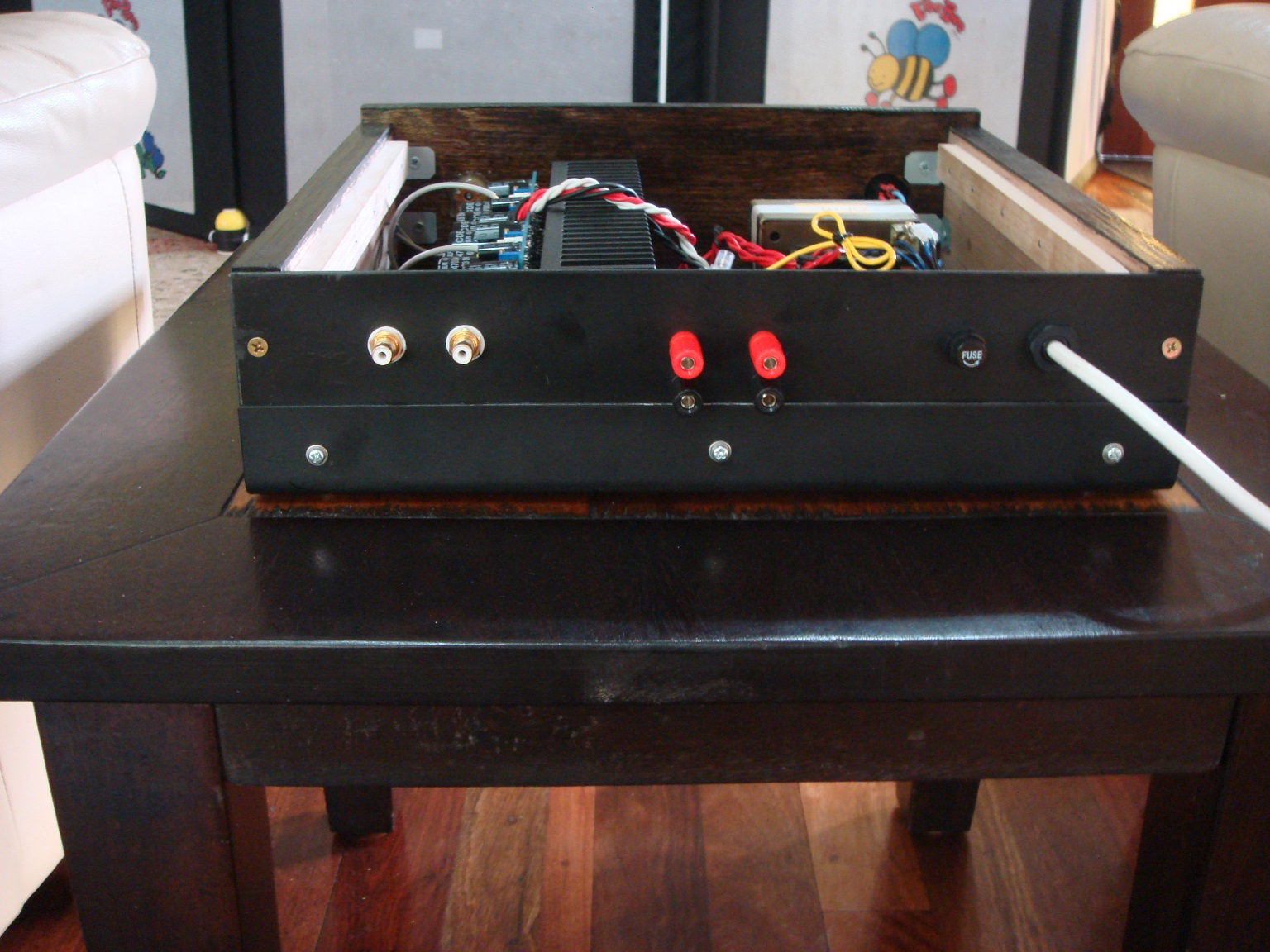

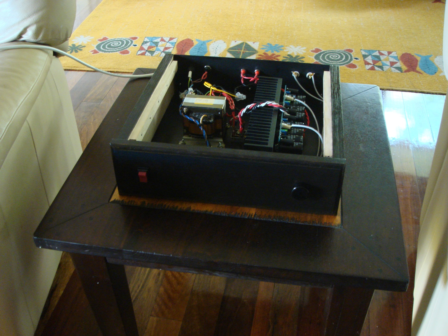

Presenting Bigun's TGM8 design in a stereo amplifier. Details here: http://www.diyaudio.com/forums/solid-state/245619-tgm8-amplifier-based-rod-elliot-p3a.html
This is my first attempt at a case built from scratch using sheet steel for the chassis and backplate, and stained Tasmanian Oak for the other panels.
laplace that's really neat
Cheers. Got it biased today and it played its first album through old speakers with passive xovers connected to the LF amps.
Just need to finish assembling the case front, reattach the LM3886s and it'll be done except for the fan control.
