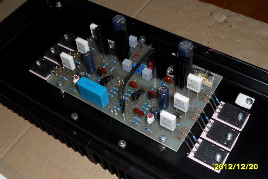

Bensen,
now that's what I call short gate stopper leads.
(as a precaution, you might consider a drop of silicon on their solder joints. think subwoofer and vibration, suspension bridge)

Thanks guys for the feedback!
Jacco, Patrick (meanman) means that the especially the wood looks better in real life. Concerning the holes in the bottomplate; they are not necesarry, the heatsinks are a lot overdimenioned.
About the short gate stopper leads; I blowed already 10 pairs at least of these beauties (2sk1530/2sj201), I learned my lesson.
The way I solder the OPS to the PCB when mounted to the heatsinks is very easy, see the picture below.
See post #123 for some more data and simulation results.

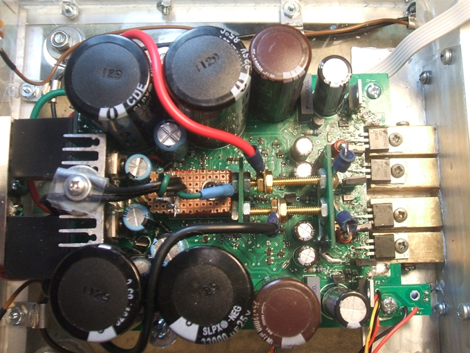

One of my preamps (top)
Hi PMA ,
Can you give details of the aluminum case. What is the web site of the product
regards. 🙂

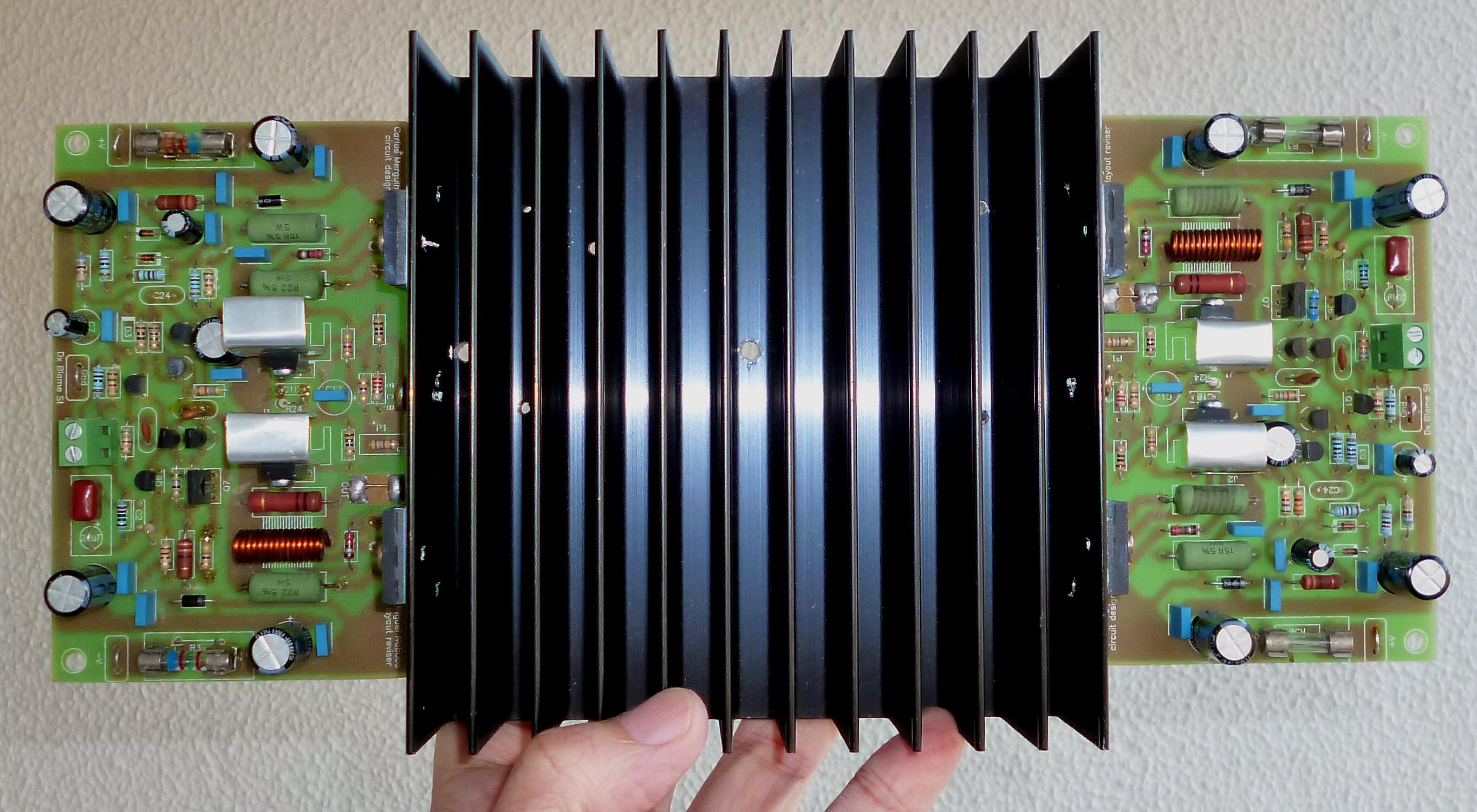

My latest home brew amp module.......
I outdid myself this time with this version of my little power amp module, the sound is immaculately accurate and precise. Nothing seems to be left out of the music program, even the most subtitle background percussion sounds are heard in the ‘sound stage’ presence.
More on this amp can be found HERE.....

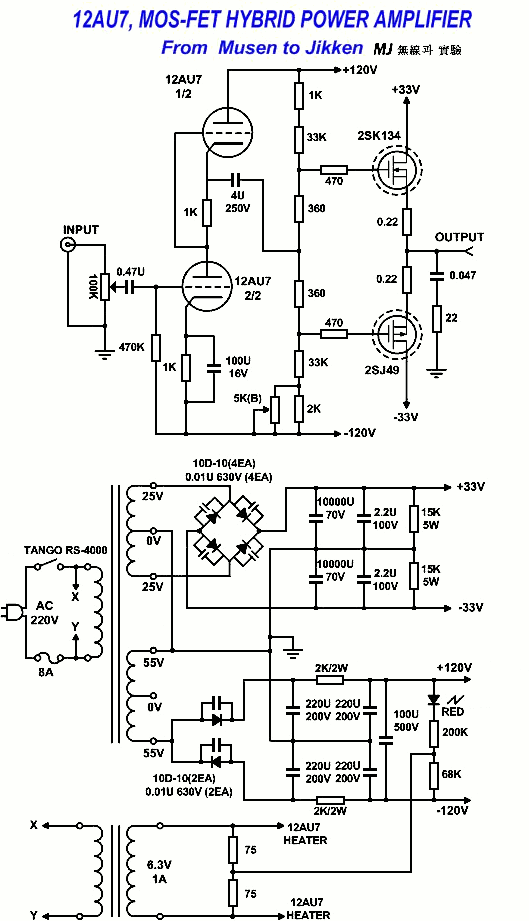

One of my amplifiers. I think the look really nice and sound wonderful. Must admit, I haven't build them myself. If someone recognizes the topology please tell😀
A bit hard to tell but looks like a copy/variation on this

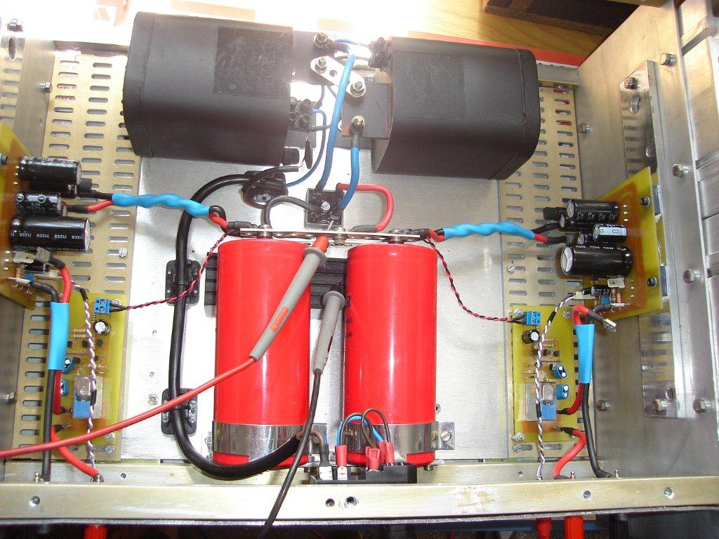

This is my JLH build. Running on 32VDC single rail. Chassis made from scrap 4mm aluminum.
Jislaaik, Dis mooi! 😀
please tell
Looks like the A&T design, by a couple of HTS student graduates.
Simplified copycat version of Frits Savelkoul's monster monaurals, downsized to 25%.
They did a couple of hybrids, from a single J50/K135 pair amp to the 2-pair output stage A-25.

Thanks bkevin ,it sounds good in Afrikaans as well !
hmmm boeremusik at 100db - just gives me cold shivers. enjoy!
