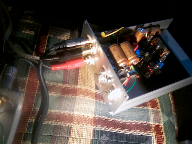

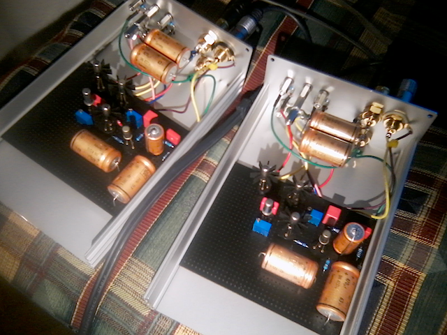

Full Germanium Monoblocks
The new 4 day holiday build (BTW happy new year everybody)

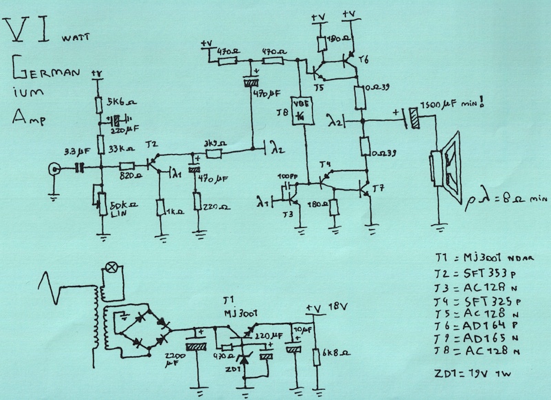

Here i present my newly finished Full complementary class a/b Germanium mono blocks. (no interstage transformers)
I will post better pictures and schematics in the near future (only had my phone camera for now).
The setup is classic, so a singleton input stage, VAS, VBE Multiplier, Sziklai output pairs & bootstrapped of course. (only had so many good devices!)
Some Specs:
1* Voltage: 18 MAX
2* Frequency bandwidth: Not applicable (don't have full specs for the Low Power transistors) but enough.
3* Output Power: what 18 Volts allows.
Transistors: (these are all matched highest gain gold lead units)
Singleton: SFT353 pnp
VAS: AC187 npn
VBE: AC187 npn
Driver: AC187 npn
Driver: SFT325 pnp
Output: AD164 / AD165 pnp/npn TO66 devices
The sound actually surprised me, it's much better then i expected considering the devices used and the design concept. It's almost tube like (dampening factor i guess😉!!)

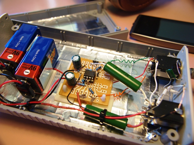

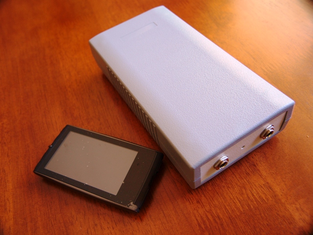

Here's some picks of a CMoy style HP amp: Based on the high performance OPA2134 OPamp chip this headphone amp\driver is good sounding and portable. The schematic is based on the CMoy design with some changes in passive parts values. I elected to run it on two 9V batteries for better battery life and greater dynamics.
There is only 4" total of hookup wire in the signal path and all component-2-component connections on the proto cct. brd. Low ESR 200uf caps and a resistive network provide the differential voltages required to operate the chip without an output cap. The brd. is silver soldered with Mil.spec machined chip socket and Russian PIO caps on the input. Power only comes on when both phone jacks have plugs in them and the power switch (at the back) is on.The enclosure is impact resistant and lined with heavy Al foil for shielding and enclosure resonance control. The sound is clean and bright with good volume and dynamics. The amp is dead quiet with no signal.

Thank you too. You have tucked away the low noise parts towards the back of the chassis. The high current parts are towards the front of the chassis together with the toroidal transformer which is radiating on the power section, you have been busy. Maybe we discuss your power supply in power supply section 🙂
