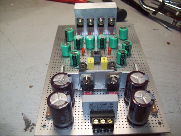

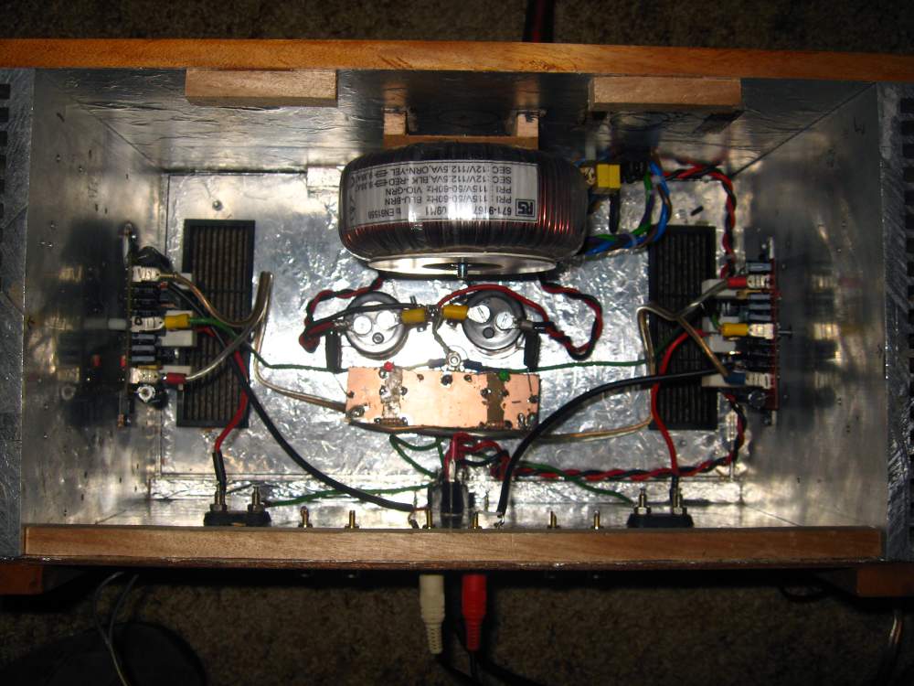

Pics below are of amp in progress (fully working), Mini aleph, Class A, +- 10W per channel, dissipation +- 40W per channel.

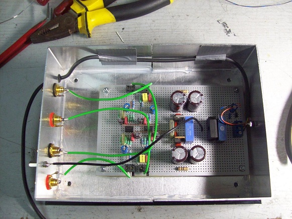

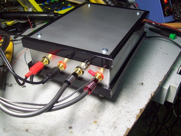

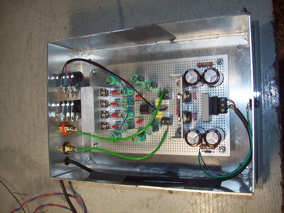

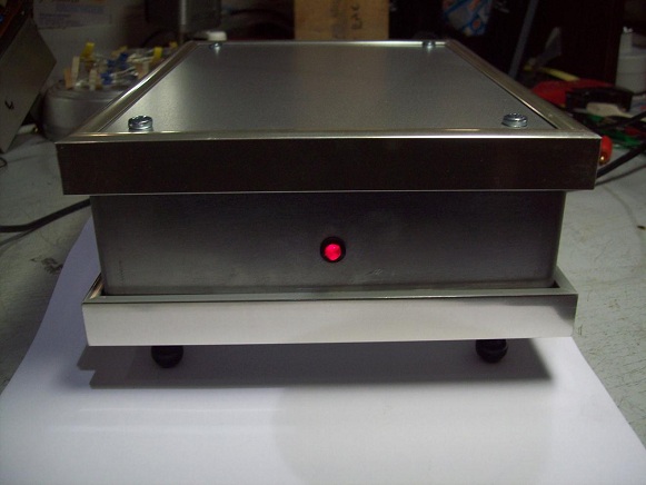

similar to the above i made also a small Riaa .... in both cases the trafo is housed in an outside wall pack ( we do have empty housings for trafos capable of 2x18v 10W )
that come very handy in situations like that .
some photo....
some photo....

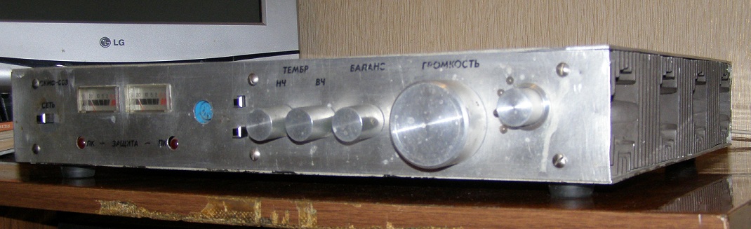

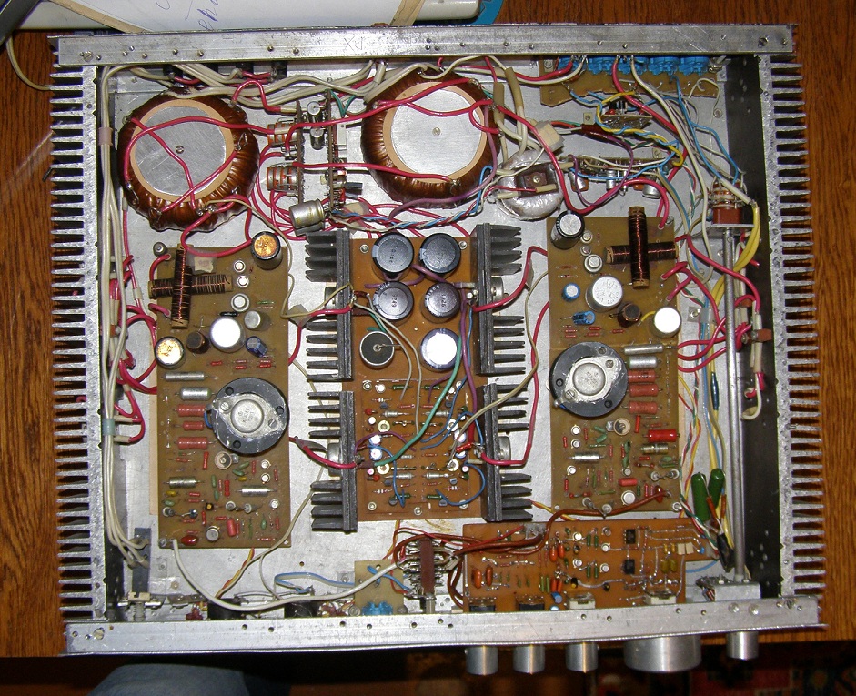

This is my version of the OBH 8SE Phono amp:
electrolytic capacitors in signal path replaced with film-type capacitors;
Power supply based on LM 317 but with batteries sounds little better for me.
Overall I am satisfied with the sound - i like it - it sounds more detailed then my Pacific style RIAA because the THD is lower, i think so.
inside:
Back panel (i still use old TT with DIN connector-do not want to damage the original TT)
front (with Leach amp)

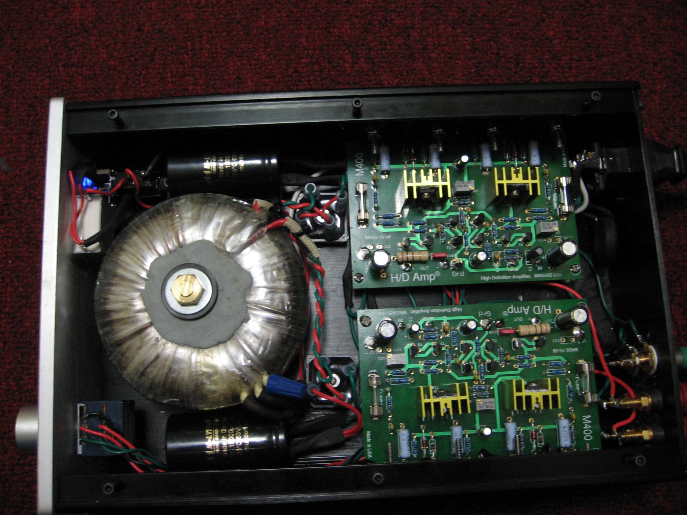

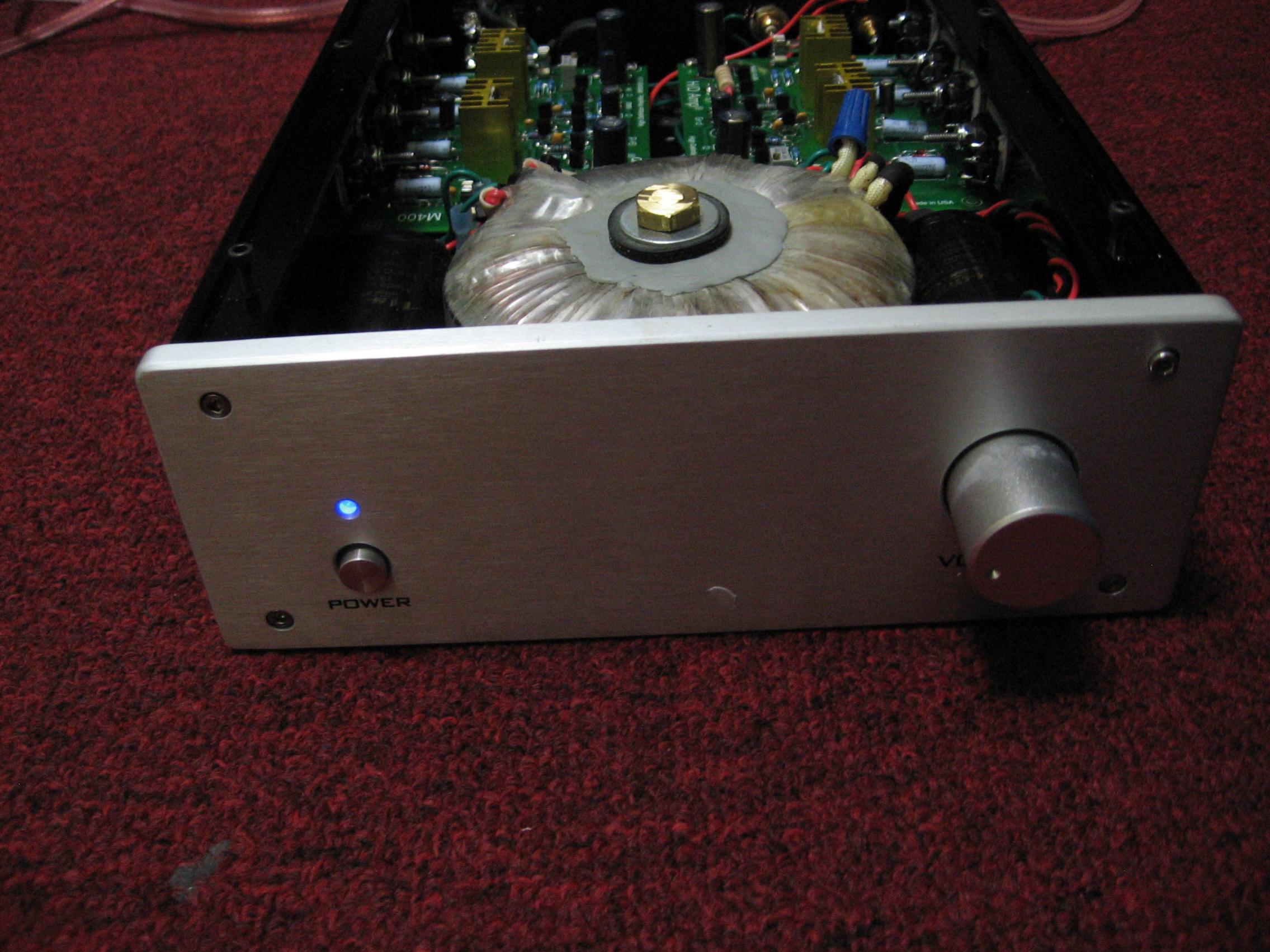

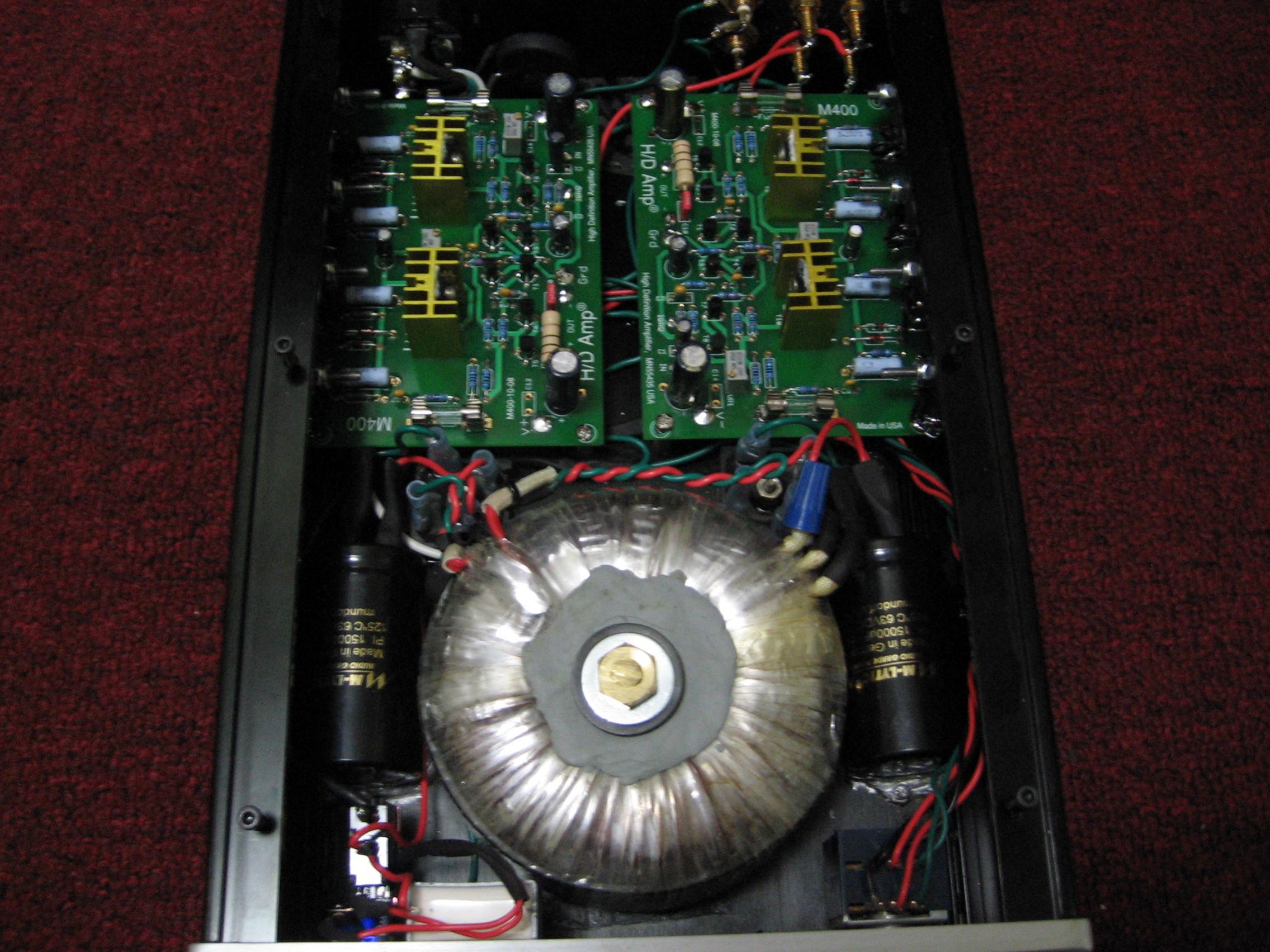

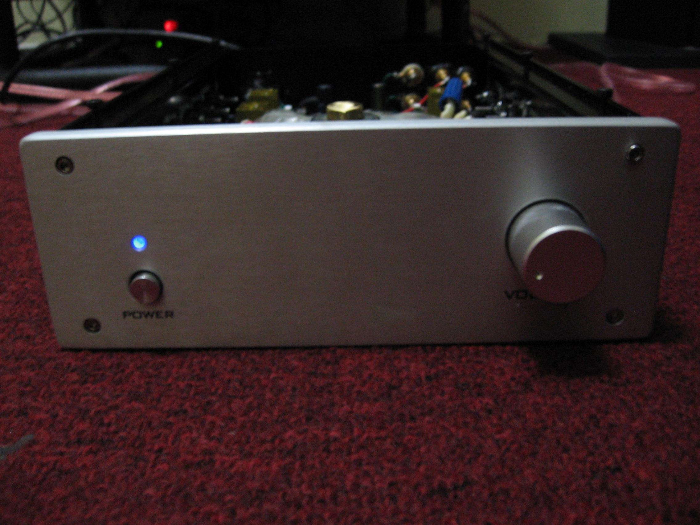

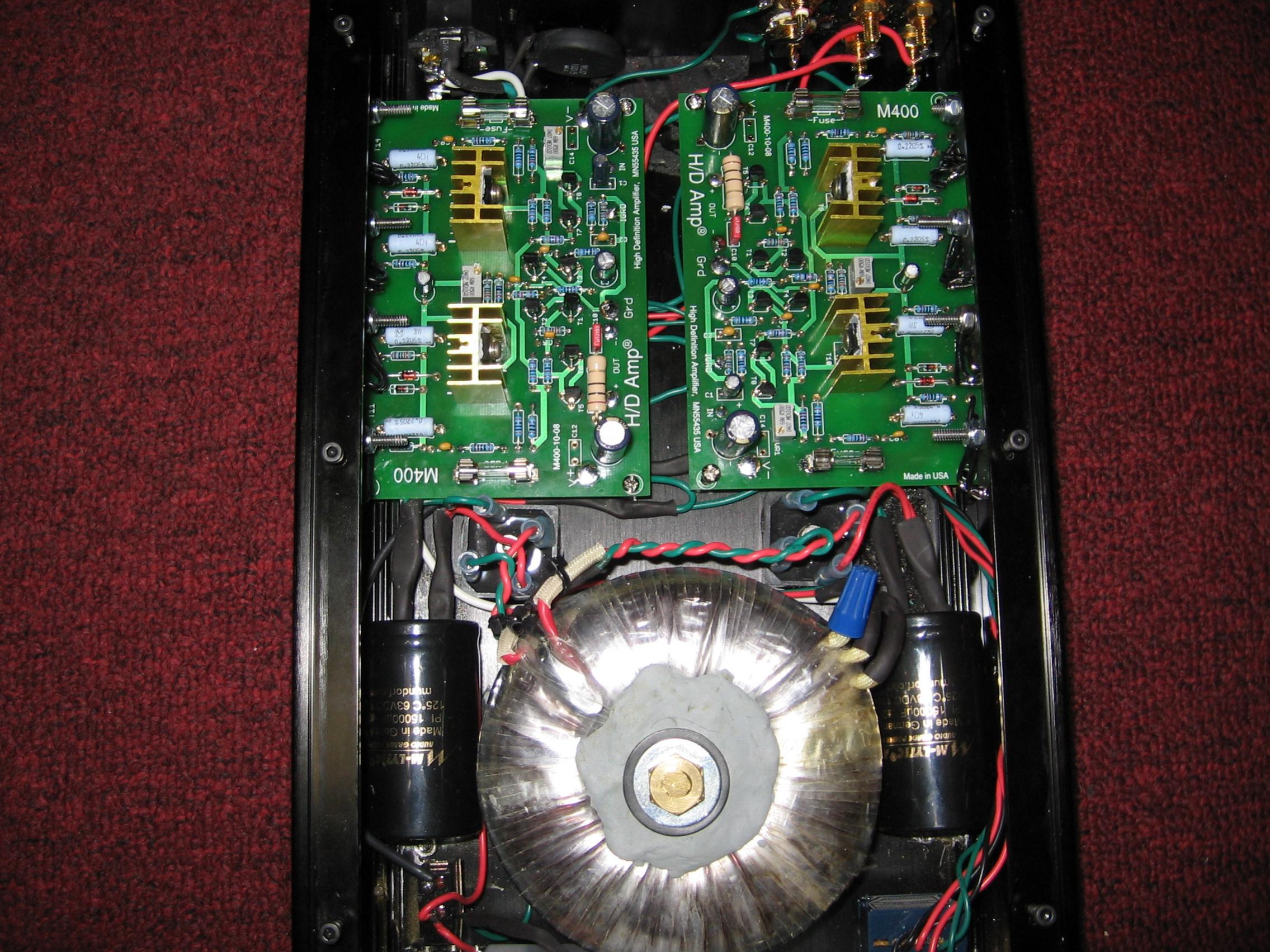

My new integrated amp!

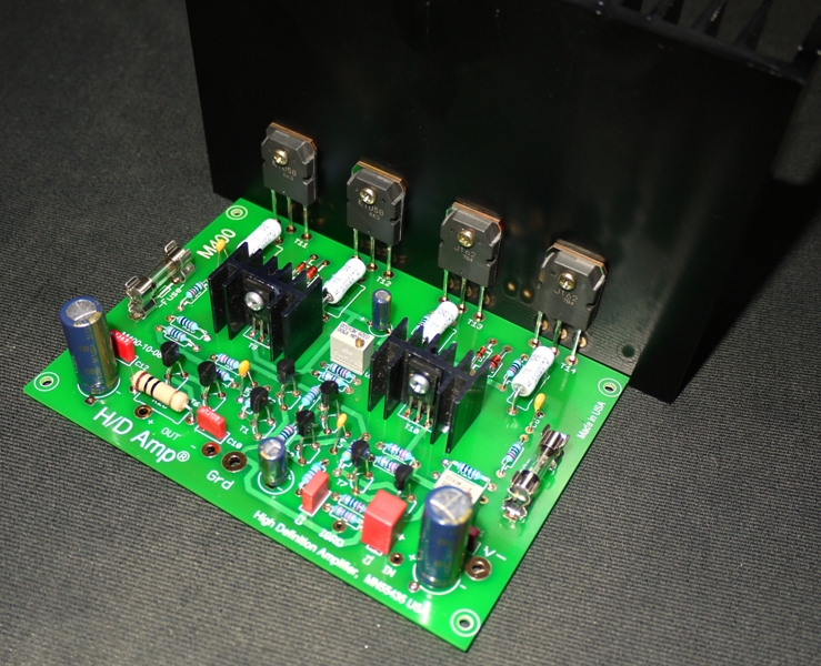

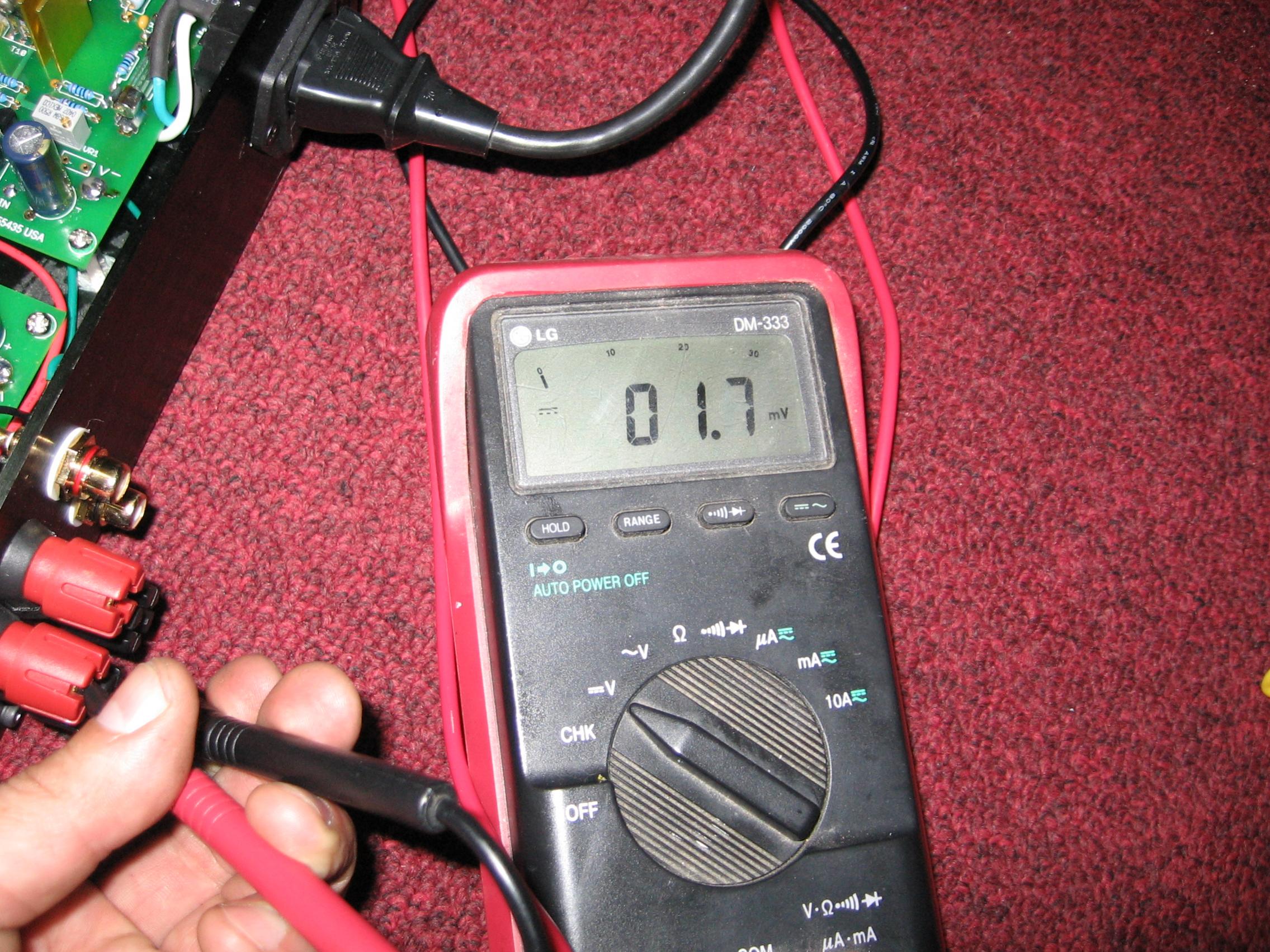

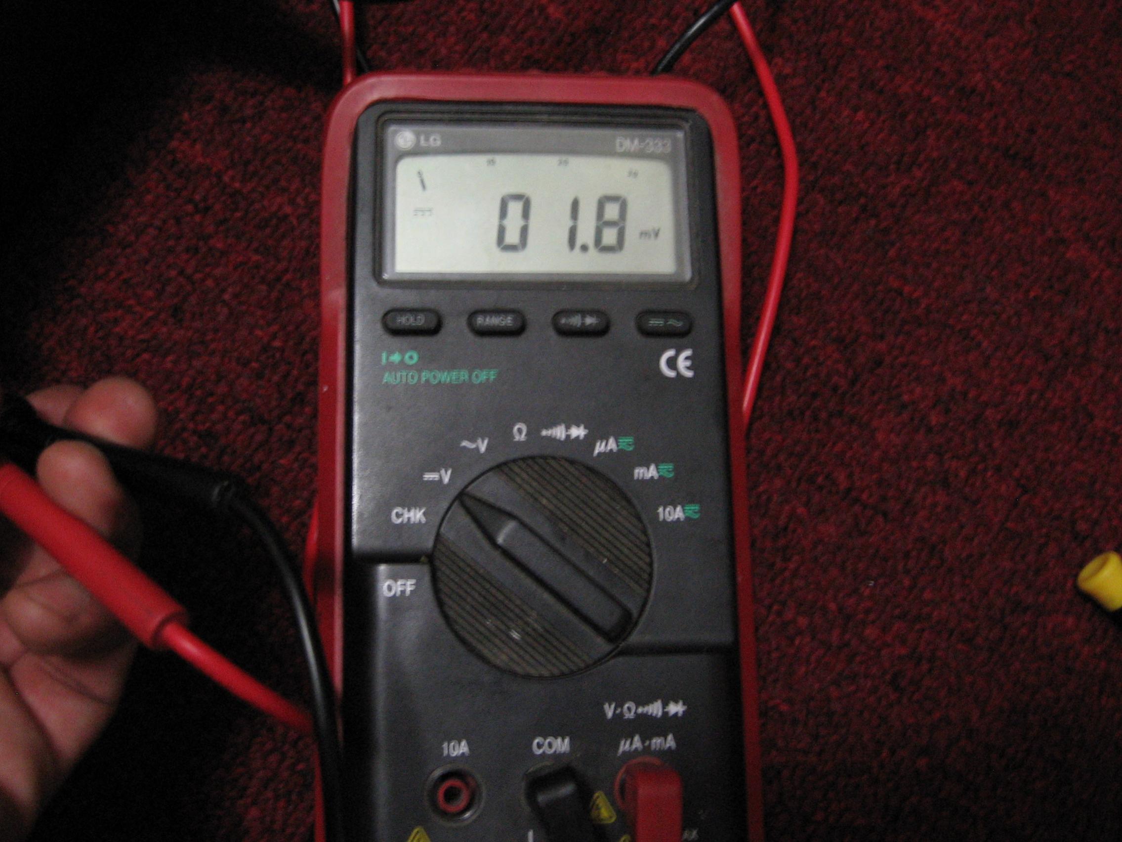

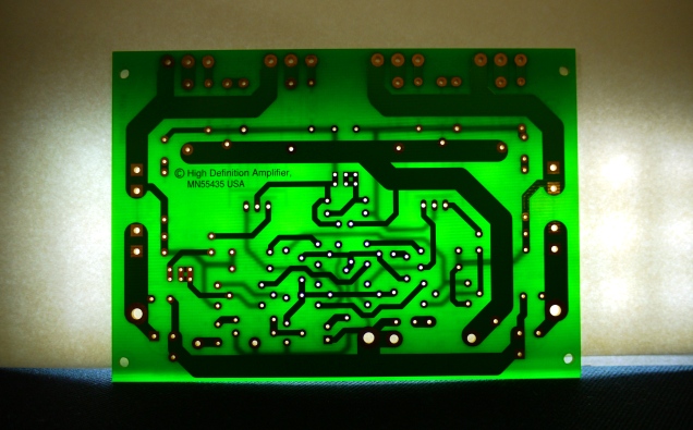

Here some pictures of my new integrated amp. The design is from HDamplifier.com. This is my second time that I order from them. The first time I build the T300 and now is the M400. the offset I get is 1.7 mv Left channel and 1.8 mv Right channel. The sound is very nice,I am using the chassis as a heat sink, it gets warm and if I push it..it get a little hot. I will put external heat sinks in the future. I am happy with the results!!! Excellent kits.
By the way, the whole chassis is aluminum and the side is really thick, but as I said before, I will put external heat sink in the near future.

replace the wiring of the pot .... to close to the trafo it will pick up something there i think .... go for shielded cables .....
